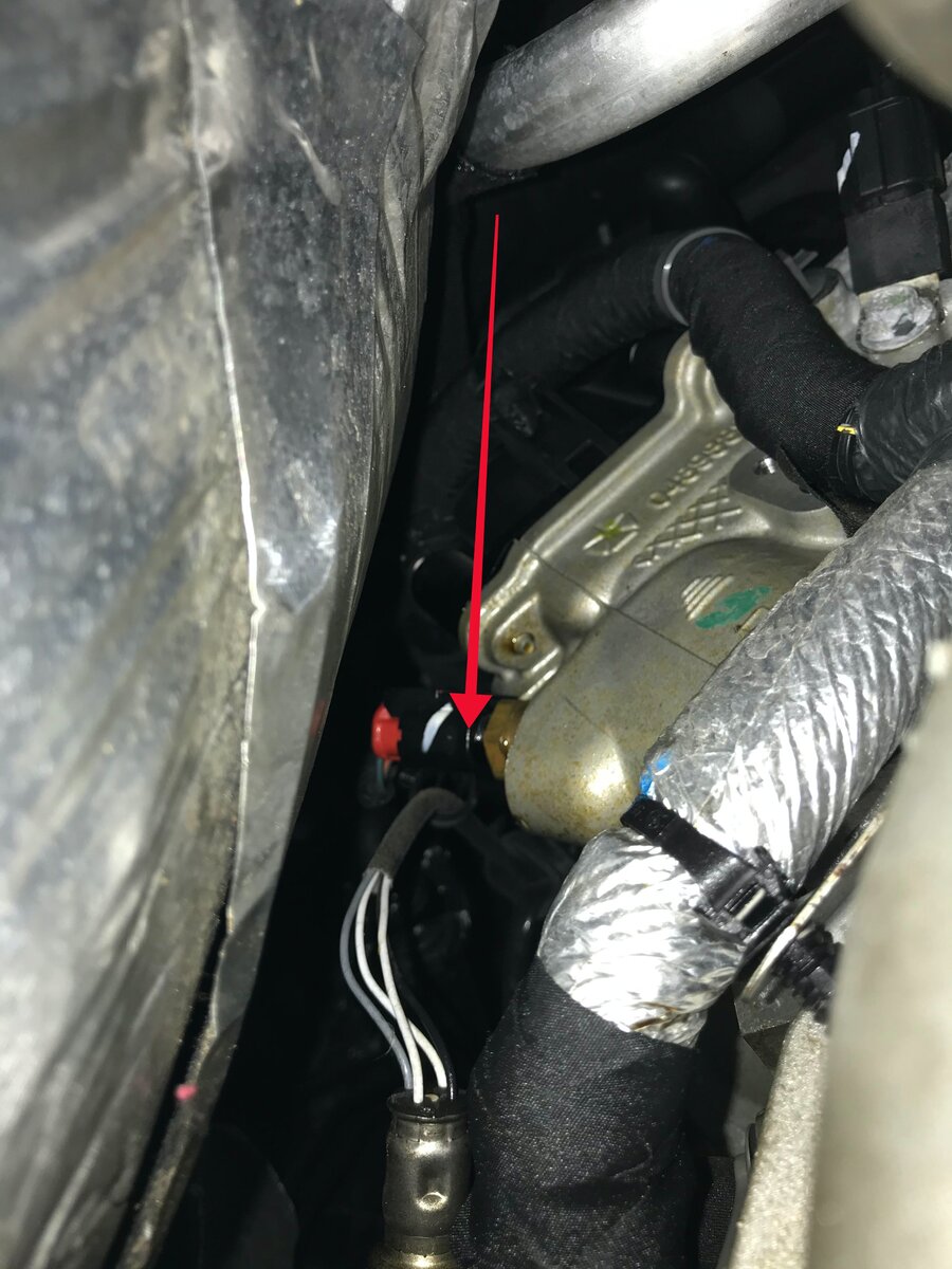

I initially thought it was the oil sending unit. Not sure where that is located but there is a component about three inches away from that 02 sensor they changed that looks like it has oil around it. Can't see much above that...Is this the Oil Sending unit?
Thanks in advance!
Rodney

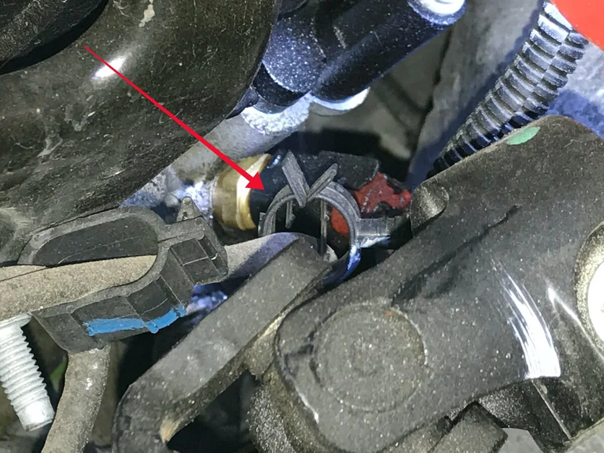

I'm pretty sure the oil sending units on the 3.6's is located on the oil cooler on top of the engine.
Those sending unit were notorious for getting hairline cracks in them and leaking on those older 60-80's cars...I changed many a one..It was just a thought..I'll see if i can google that and get the precise location.
I remember changing a few on smallblock chevys, they weren't the easiest to get to.
