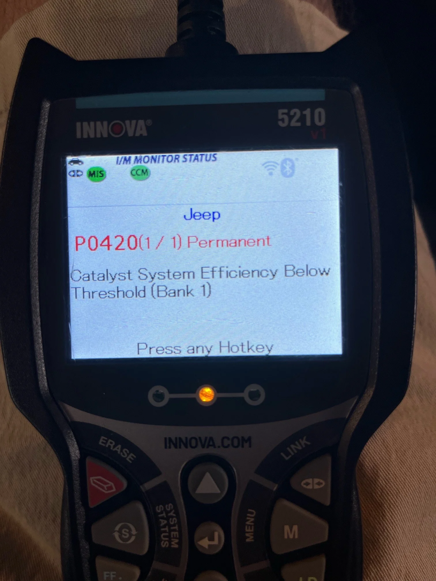

Could use some help on P0420 Code
Had a P0052 02 Sensor 2/1 couple weeks ago and replaced all 4 O2 sensors, cleared all codes and ran good for about a week.

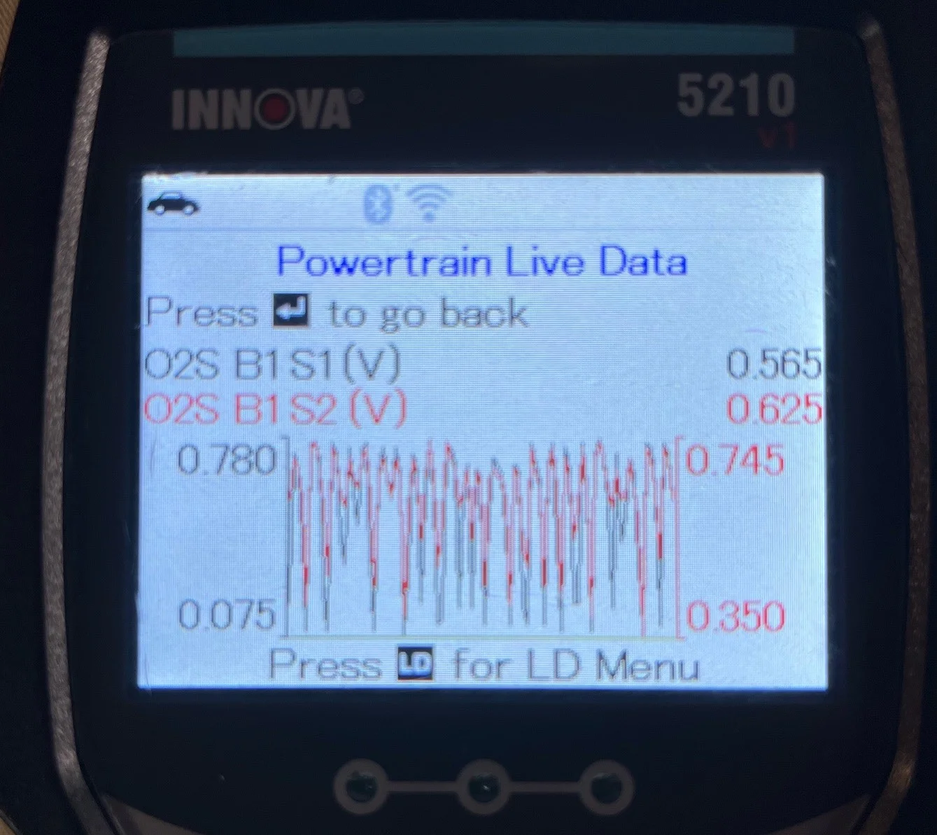

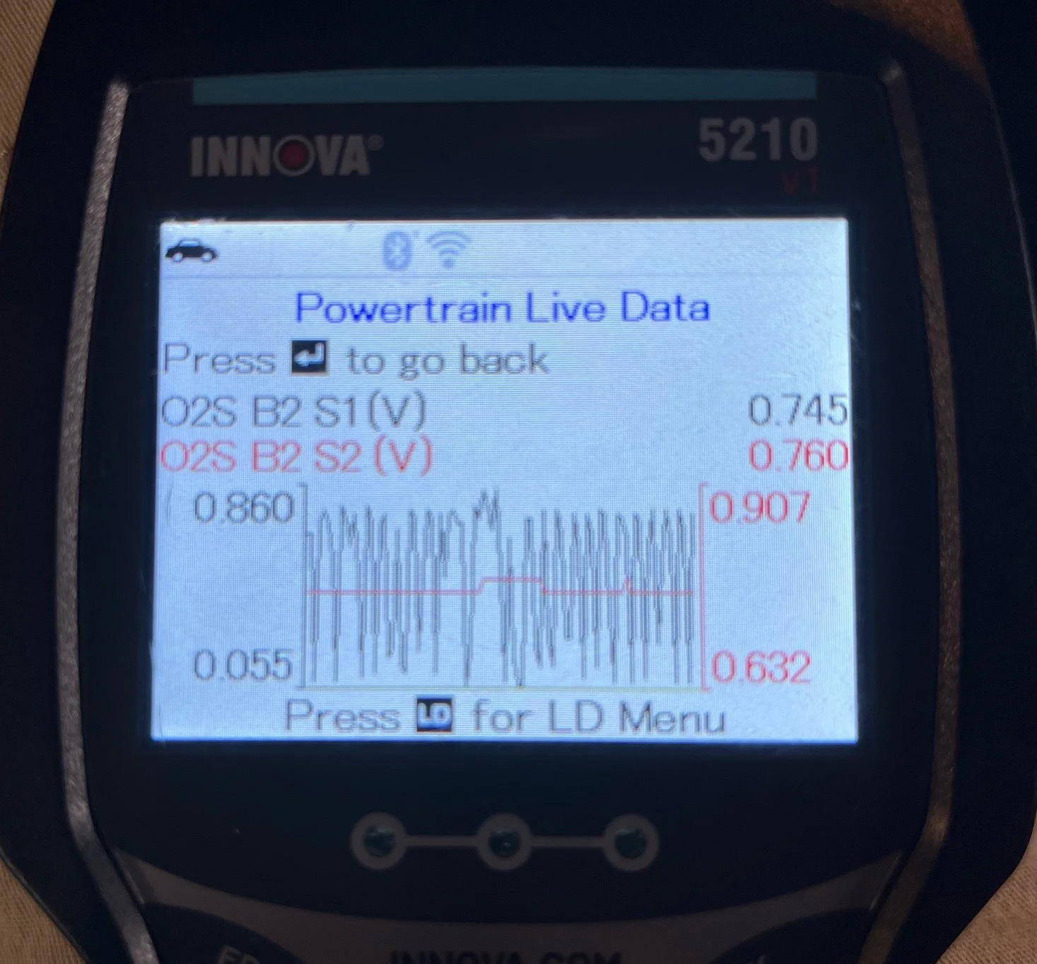

Friday the CEL came on and scanner showed P0420 (Bank1). Seems to be running good otherwise. Checked for any exhaust leaks and could see/hear any. Attached are screenshots of both Bank 1 and Bank 2.
Questions, should I not worry with chasing down a short or open circuit since I'm getting a voltage ready on all 4 sensors?
Based on my knowledge, the Bank 1 cat is not working. Should I just replace? Seems like replacing the cat is just a band-aid fix with only 75k miles on?
Thought about running some Seafoam through and see if that cleans things up.
Currently have battery disconnected to see if I can get all the codes (temporary and permanent) to clear and if they come back on for 3rd time.
