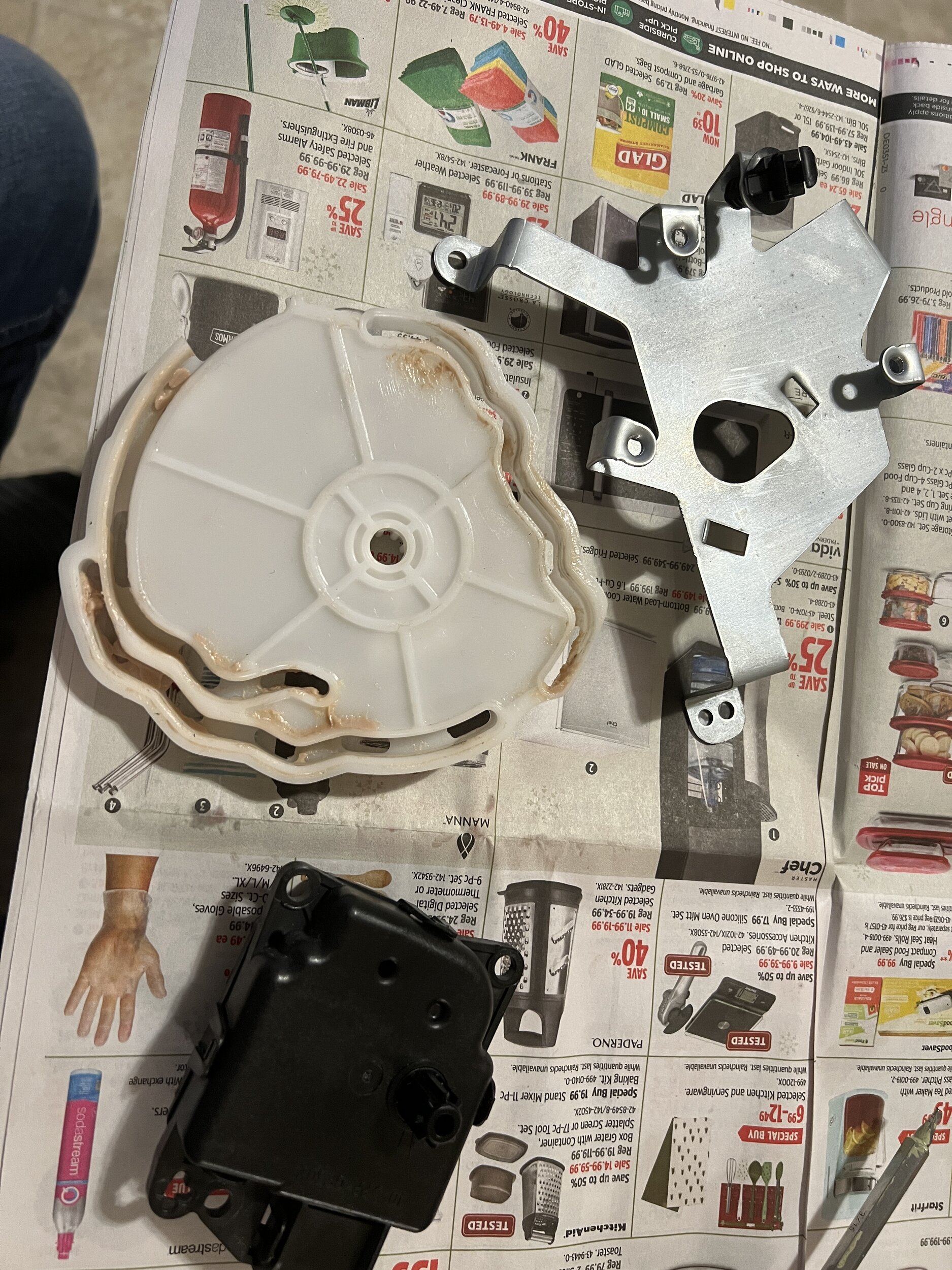

On my Jeep the HVAC system will blow hot, cool, or AC on defrost and dash vents but not on feet.
I removed the actuator and gear and cleaned it all up and reinstalled it. Still not blowing on feet when chosen.
It will blow on feet temporarily while actuator rotates the gear past the feet option to the defrost.
When the actuator was removed but still connected to wiring it would only move all the way from dash vent to defrost but wouldn’t move at all when any options between were chosen.
Is this an actuator problem or dash control selector problem?
Any experience with this would be greatly appreciated!!
