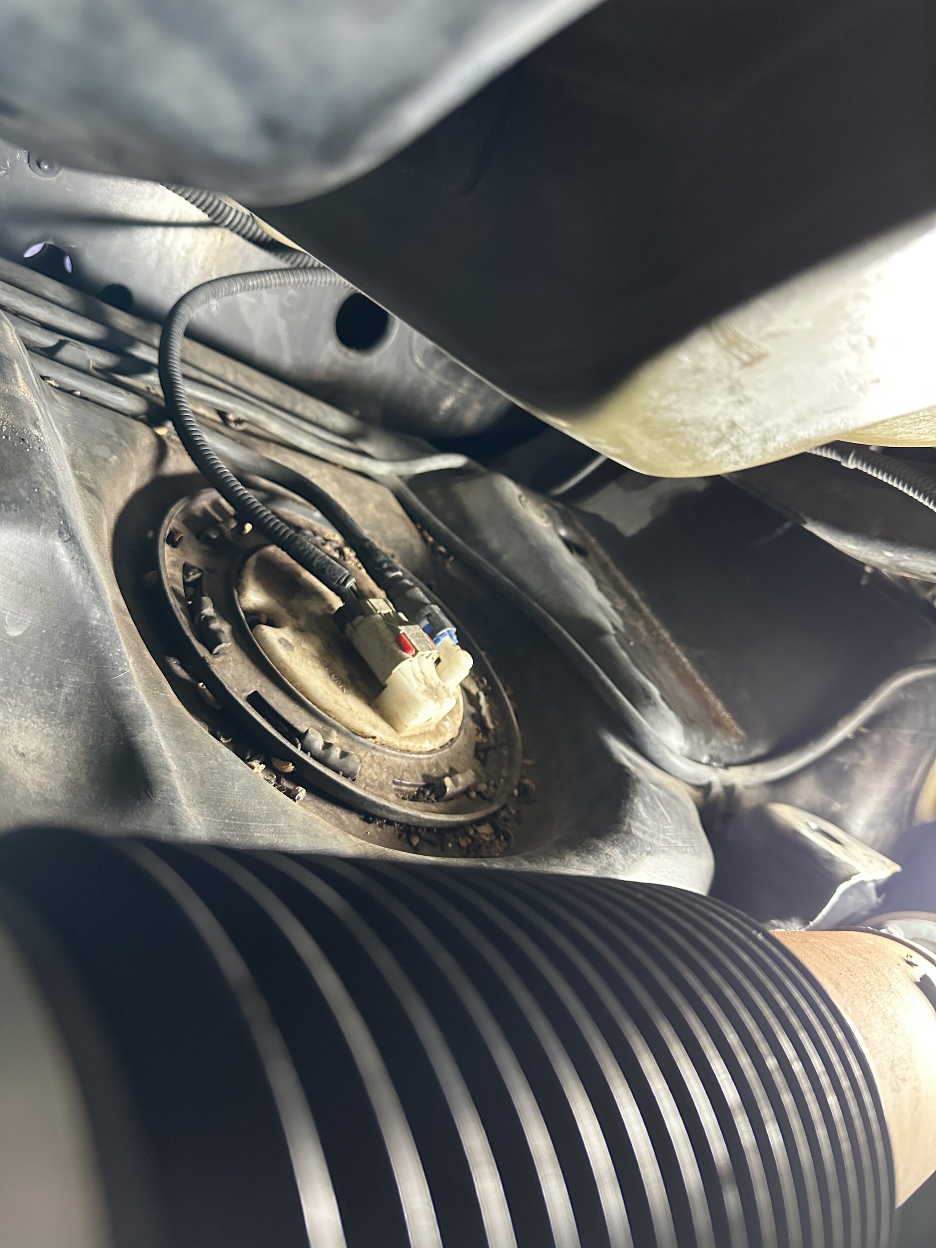

Can someone help a person who sees 5,401 hoses in the evap?🤦🏻‍♂️. Which exact hose?
Pretty sure the OP is referring to this hose section.
