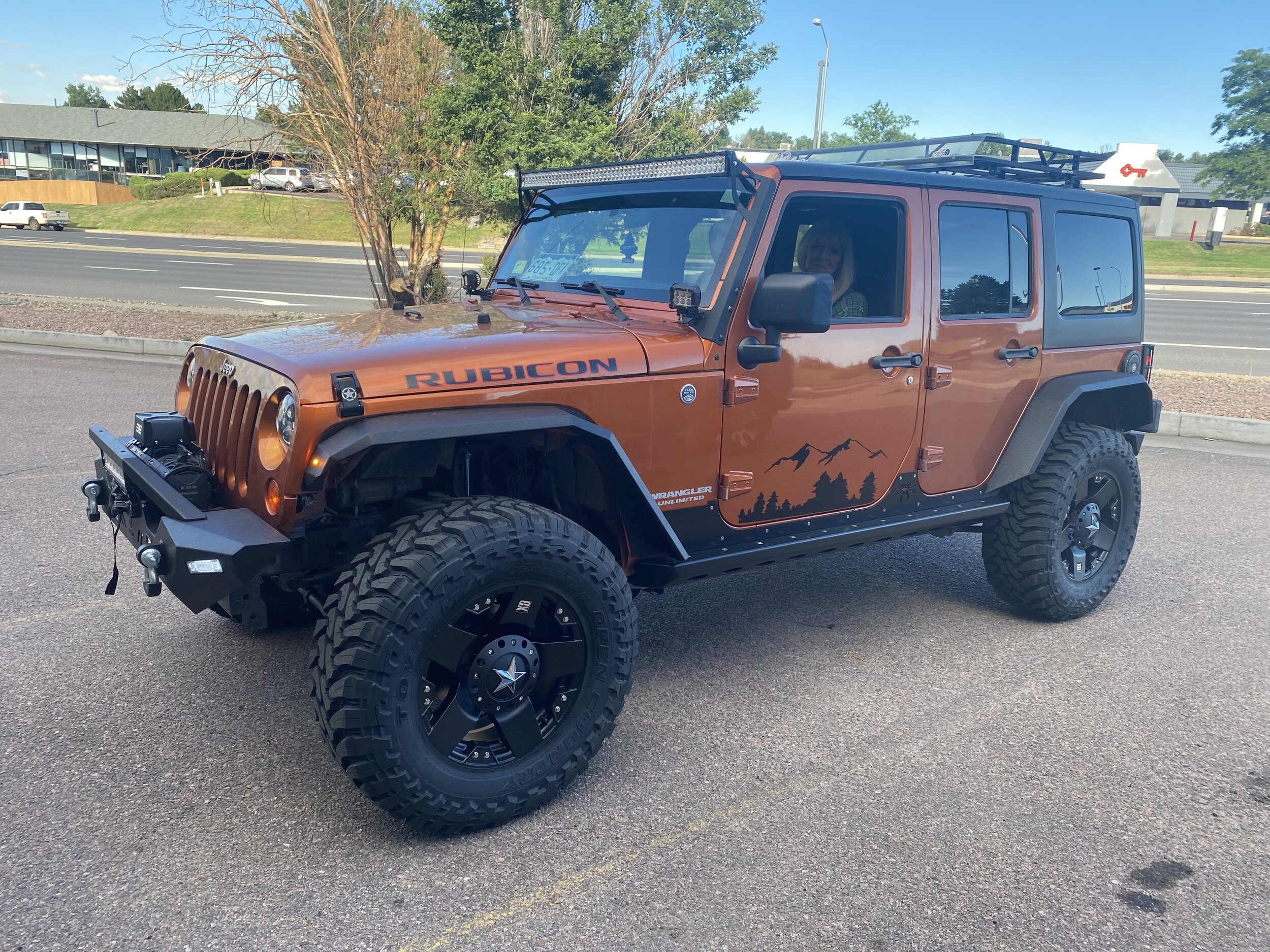

This is Jeepers. She belongs to my wife. She's a 2011 JKUR. As you can see, there's been a fair bit done to her.
My wife absolutely loves her JK. After 199,5xx miles, she blew a head gasket. I don't see any sense in replacing the head gaskets on a 200,000 mile engine. After that many, it just makes more sense to rebuild it. So I have a crate engine sitting in the garage. I'm putting a new water pump on it and swapping retained parts over. Then it'll go in. It's worth it to us because she really loves it, and because we've put a bunch of other work into it.

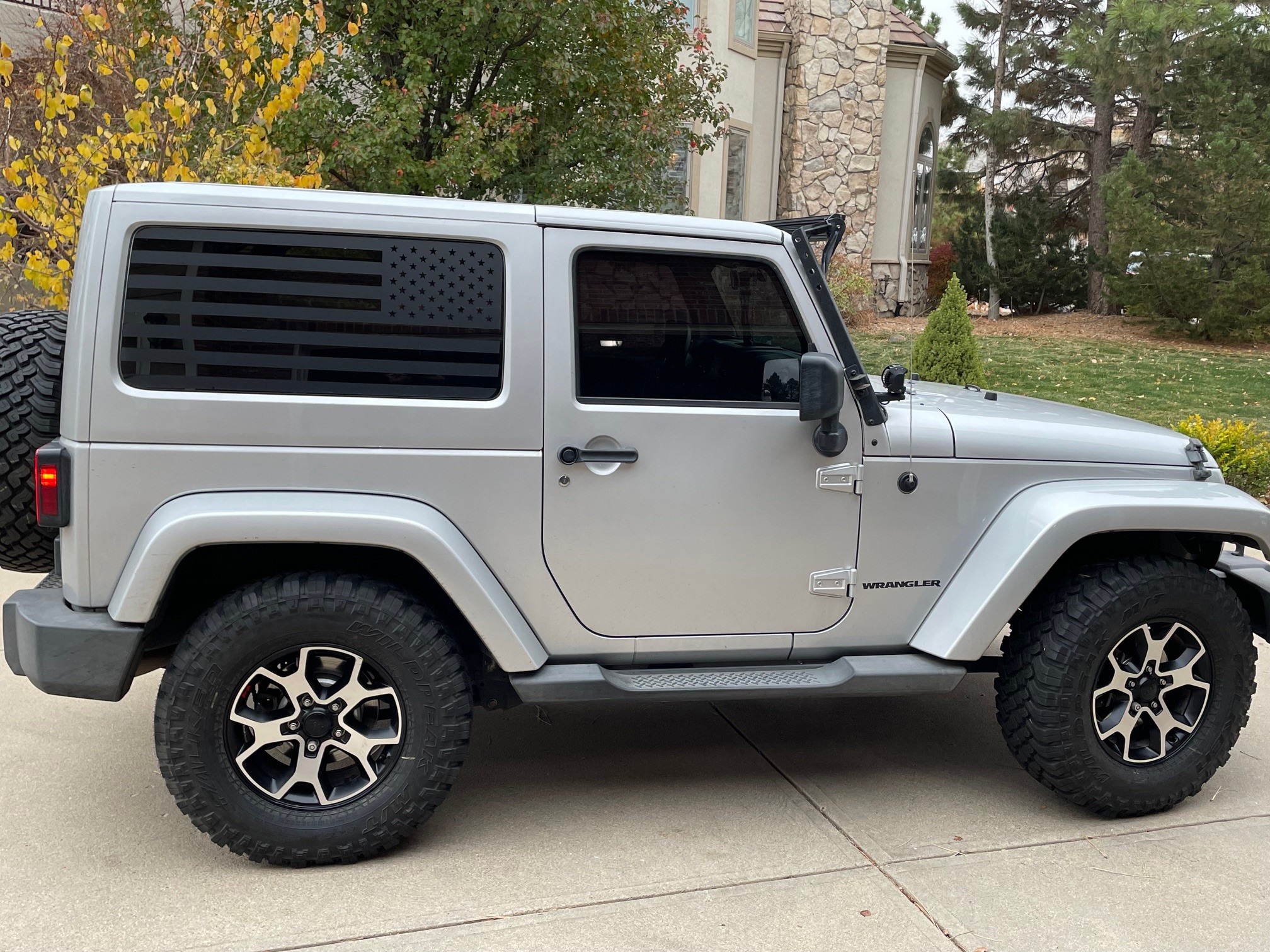

Very nice Jeep! I can see why she loves it and wants to keep it going. Ours has been my sons high school and college car. We haven't really done anything to it other then a light bar and a wheel and tire swap but he does love to drive it. This was a picture I took after the wheel/tire swap about a year ago.

what size tires are those WildPeaks on your stock suspension, please? I am looking to upsize my 255/75/17s but not lift it.

Those look like the stock Rubicon tires to me - 285/70R17
You're exactly right. That's what they are. Bought them used from someone that was adding a lift and new tires/wheels to theirs. I did have to put in 1" spacers to avoid rubbing in the front. I went ahead and added them to the back as well. A 3" lift would be nice but we'll see where we end up with this engine issue first.
