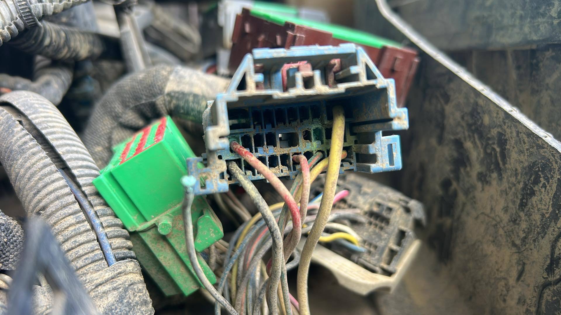

Broken wire at tipm connector. Fired right up once repaired
