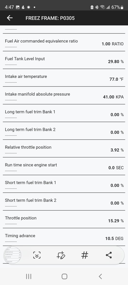

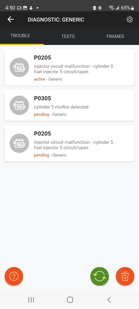

That said. I thought it fixed my p0205 p0305 woes but to no avail. Gonna get a noid light tester tomorrow and check to see if the clip is getting power and if it is proceed with changing all the injectors. This is proving to be quite the battle

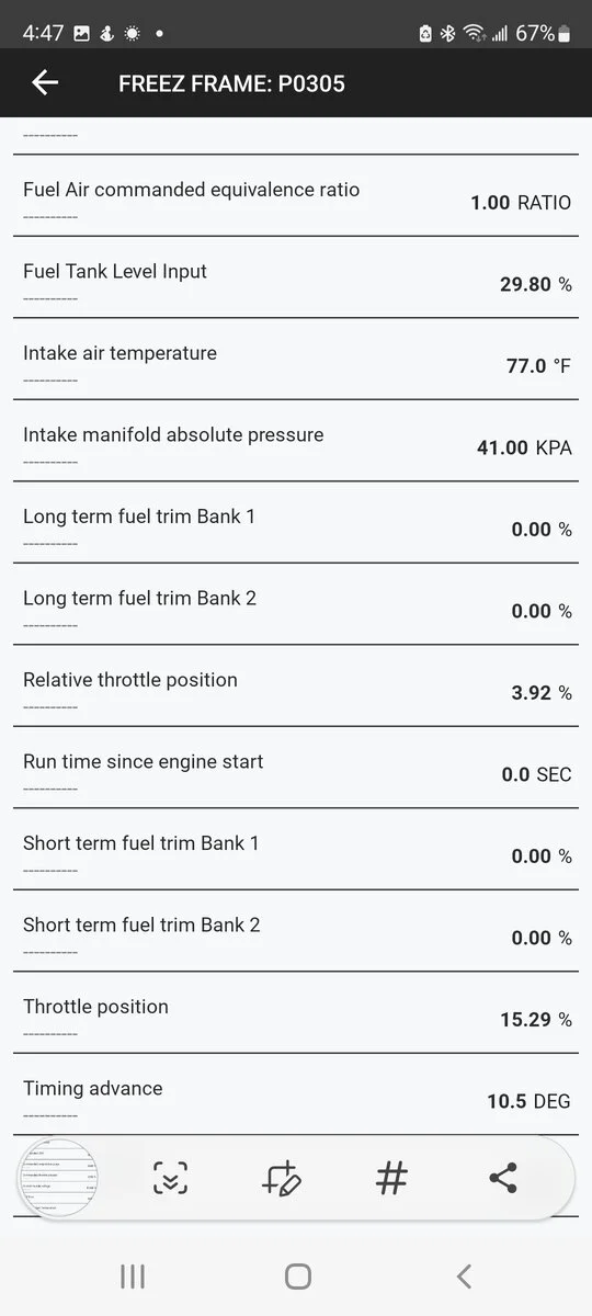

This was my freeze frame from today. Any clues from this info?
