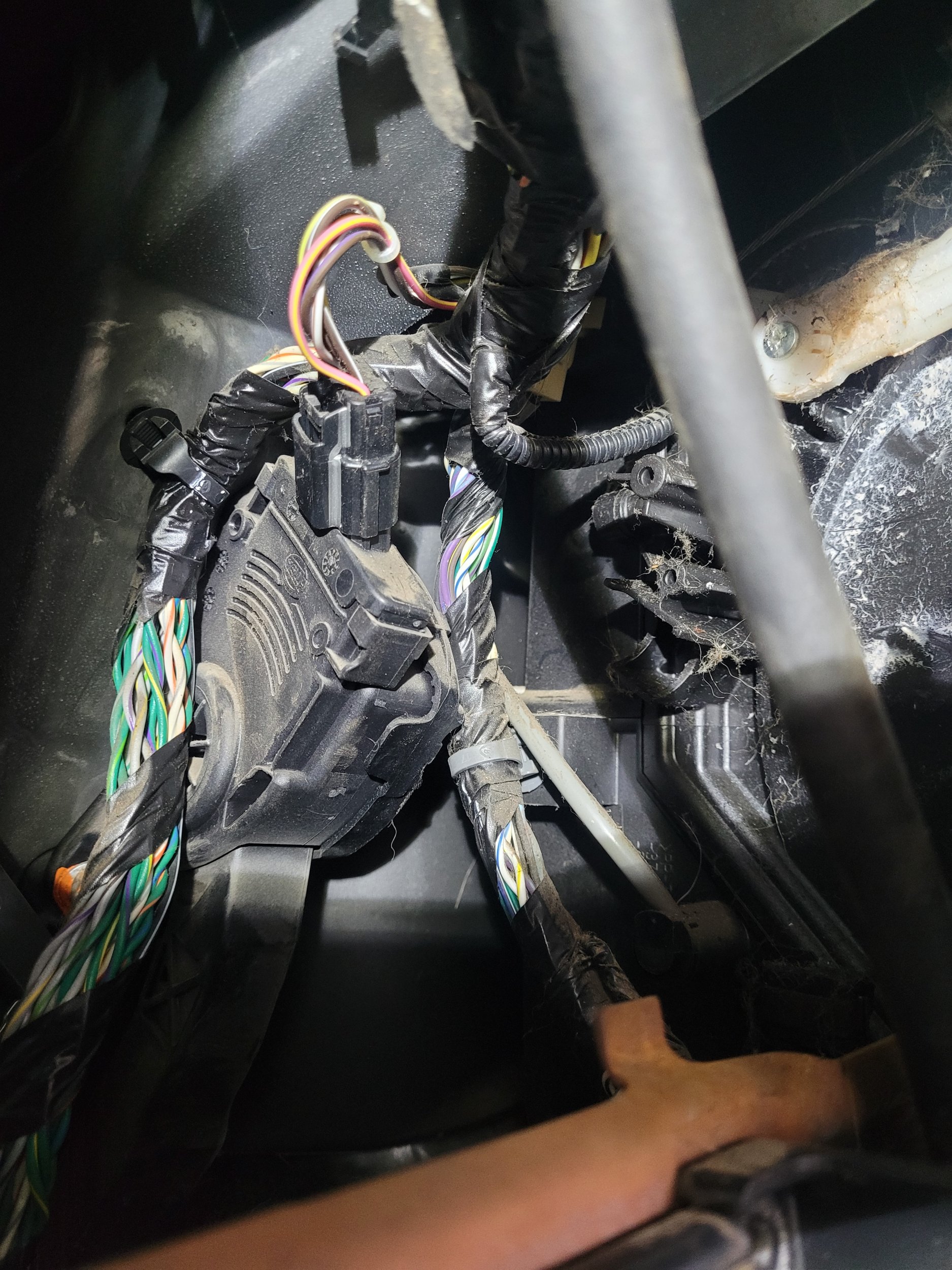

Hey yall. So trying to replace my blend door actuator as I stopped getting heat on left side a d also already flushed out heater core. I found lots of instructions online with help on where it is and how to change it out . All that good stuff. I got as far as removing the bottom air duct as I saw that some of the older jks had the blend door behind there. Well what was interesting was when I removed the duct I saw nothing of anything that looked like where the actuator should be as you can see in this photo. Does anyone know where might mine be? I have a 2008 jk sahara. I had so.e other different things that most other people seem to have like an "infinity" module underneath the steering wheel too which most people don't have. Any help here would be greatly appreciated
Isn't the white plastic piece in the right side of the picture the actuator arm? I thought the older JKs, like your 2008 had a wire cable connection from the actuator to the door itself.

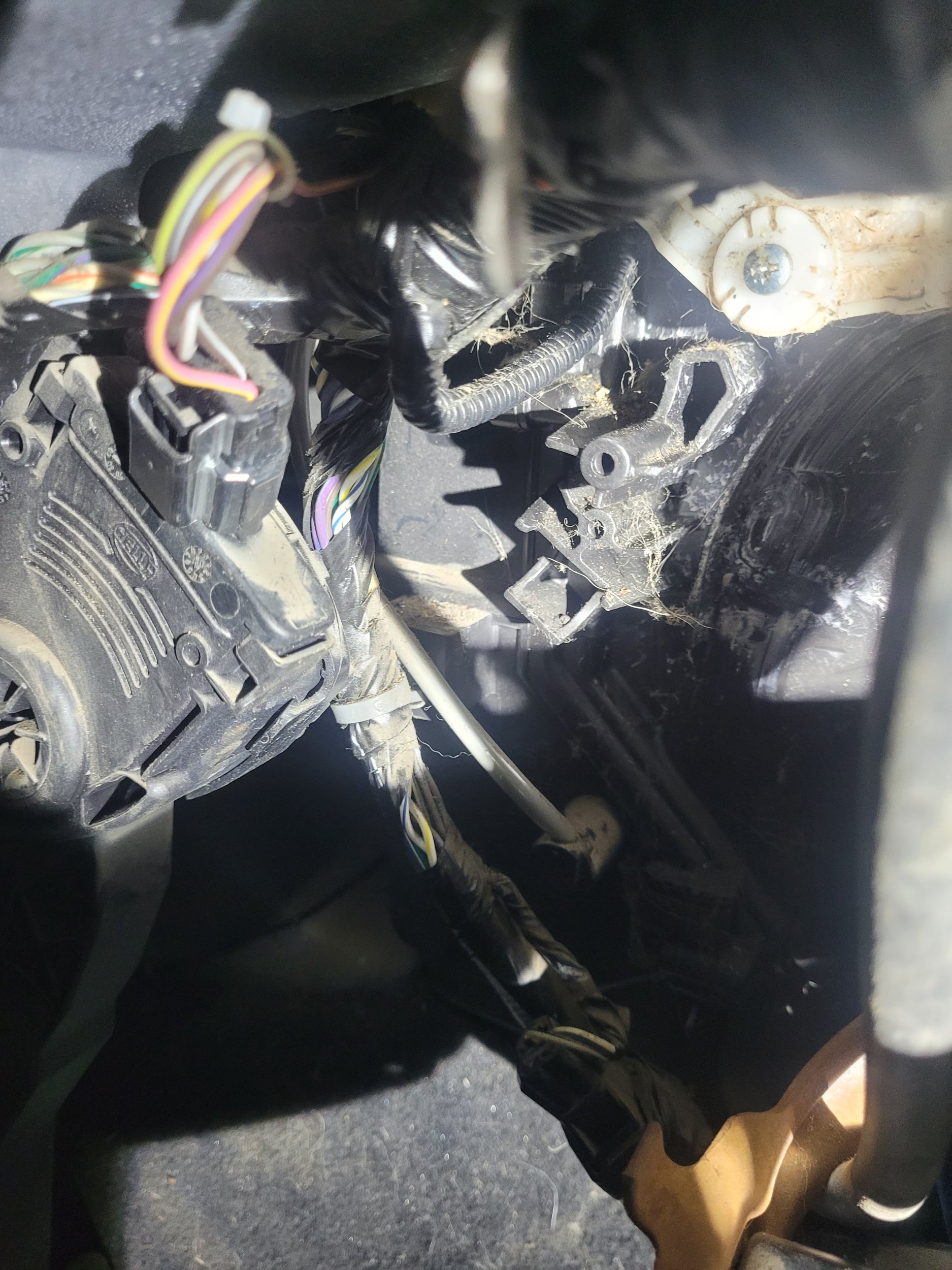

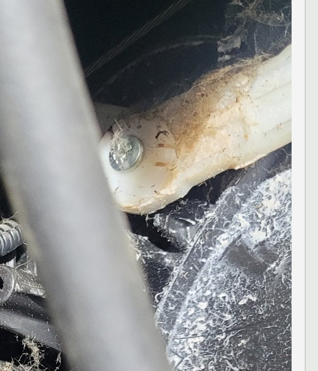

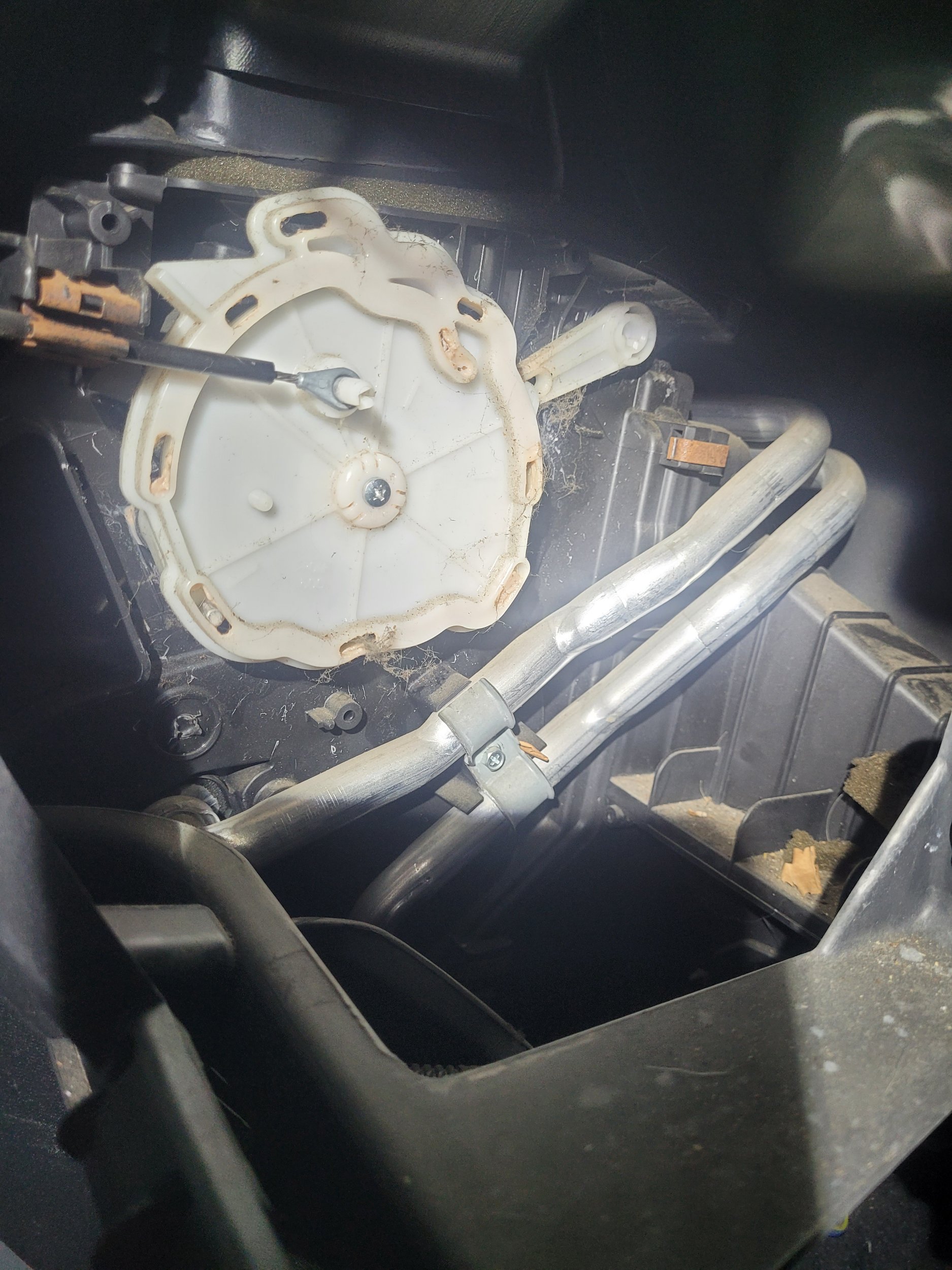

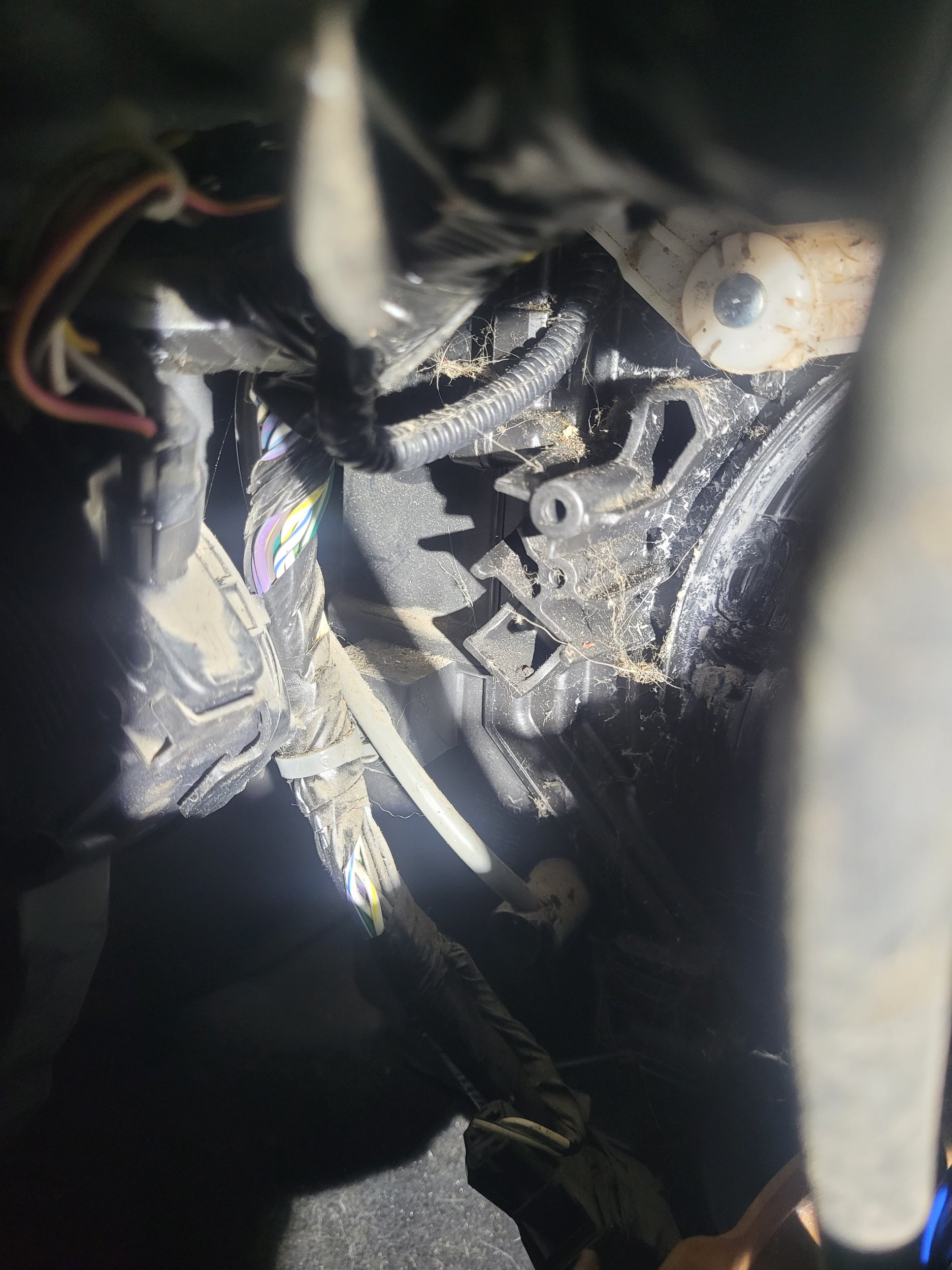

Well friends. Not to be digging up old Graves but I think it's useful for people to know if they have this problem. I have an 08 jeep and I had time and decided to open up the dash on both sides today to see if I could find the blend door actuator. I'm pretty convinced at this point that it doesn't exist on these models. Not sure when it does but in my 08 sahara. It's no where to be found. Check out my pics below
Like I said in an earlier post, the blend doors are both cable operated on the 2007-10 JK’s. The electronic blend door actuators didn’t show up until the 2011 redesign of the interior/HVAC controls. The blend door on the driver side is temperature and the one on the left (the big white disc in the photo your shared above) is the blend mode.
