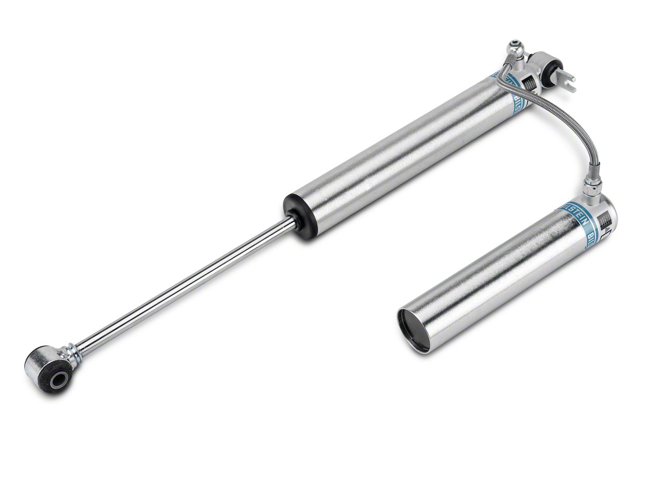

i purchased the bilstein reservoir front shocks for 2.5 inch lift but now i realized they don't make the rear matching 5160"s...i can get the 2" or the 3.5-4.5 inch....not sure what to do now....better to get the 2's or the 3.5's....and make appropriate additions like bump stops, shock extenders etc, please help...and i am not mismatching them....
Bilstein 25-187663
www.extremeterrain.com
these are the 2 inch version....
2010 wrangler jk 2 door sport..
also i have the 2.5 inch coils from rock krawler....
ty
