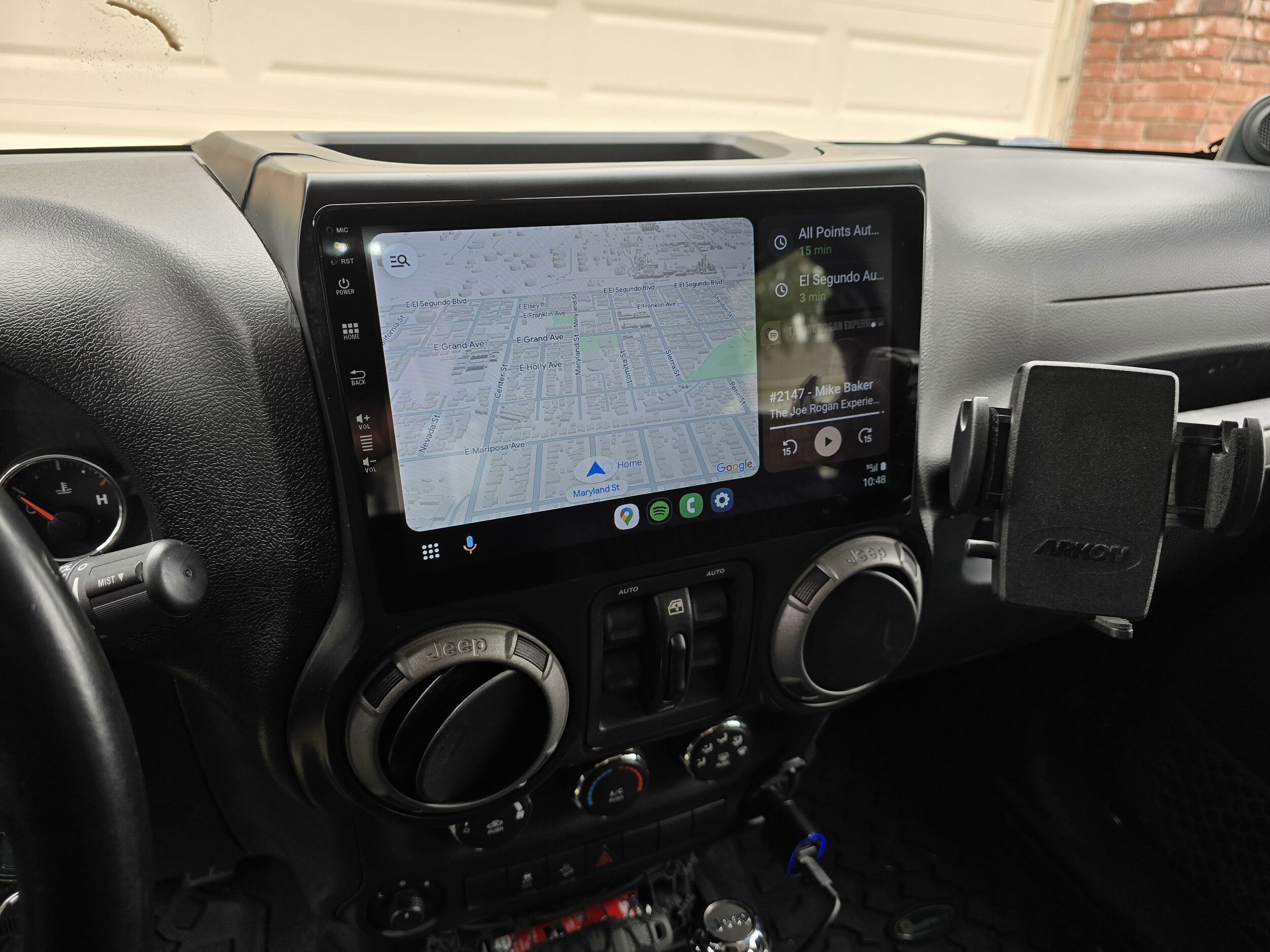

I just put in this $350 unit in my 2012 Jeep Wrangler JKU.
They make exact size replacements. That don't require any new dash parts. But the 10.1" and larger units come with three dash replacement pieces. That for the most part match perfectly. And only require a few screws to replace. Going above 10.1" does sort of drastically change the look of the dash. But they match and are doable. For me the 10.1" in a Jeep JK is the best upgrade size wise. And it is light years better than the POS stock stereo.
I paid $350 for the head unit. Which came with all the correct wiring harnesses, backup camera, dash kit, gps antenna, microphone and everything you need for a complete install.
eBay is your best option. Amazon is over priced and has a smaller selection. I found a 8gb/256gb android 12. Mine upgraded to Android 13. For $350.
I'll let you read the specs at the link. It even does split screen flawlessly. It's basically like a cellphone in a 10.1" screen. It connects with my phone immediately upon starting the car. You can add as many apps that you want. And has both Carplay for iPhones and Android Auto for Androids.
https://www.ebay.com/itm/3868294569...pid=5337789113&customid=&toolid=10001&mkevt=1
I did receive one dash piece that had been returned and was missing the clips. I contacted the seller. And they sent me a new set within a week.
They also gave me all the info I needed to set up steering wheel controls in the factory menu. It's in the "Original Car" settings menu. You just have to have the password and select your vehicle make and model. And then another menu allows you to map your steering wheel buttons to whatever function you want them to operate. Simple. Like select volume up on the screen and hold your steering wheel volume up button for one second. Then close and save. Done. If you own a cellphone you can do this.

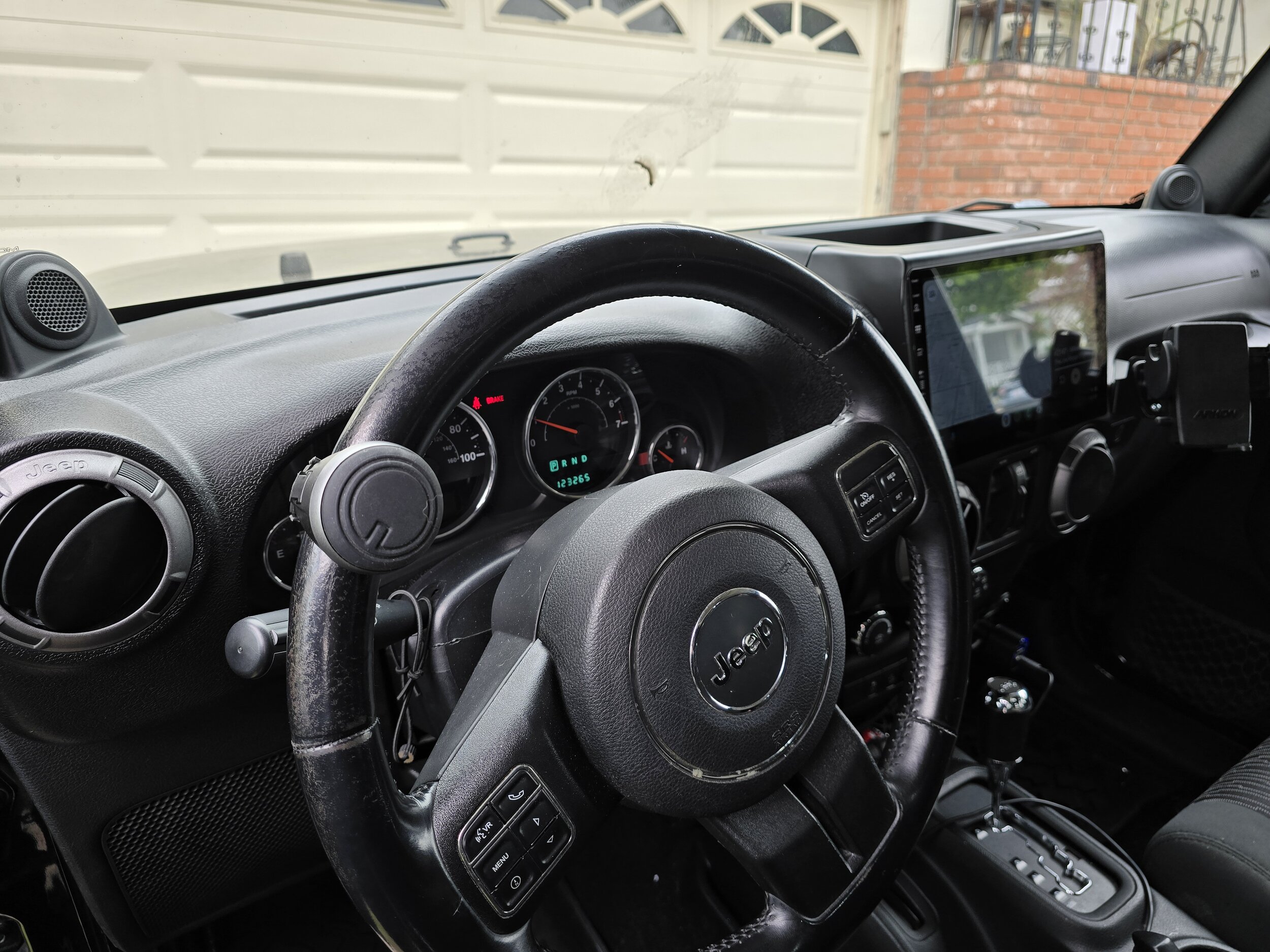

A couple of the dash pieces did not fit perfectly. Some small grinding and extra non visible screw fixed it. Could have been sun warp in my existing dash. Didn't spend a lot of time trying to figure it out. One clip on one dash part wouldn't stay in place. So I placed a small sheet metal screw under the dash. Not visible.
One thing to keep in mind is if you have the common dark grey dash color. It is actually two tone from the factory. The top half is jet black and the bottom half is dark grey. At first glance I thought the new dash pieces did not match. But then realized they don't match to begin with. Lol. But it's pretty subtle. The new dash pieces are reshaped to allow for the larger screen size. But the redesign is perfect. As is the texture and color.

That gap begins the screen is fixed now. Just took a small bit of plastic away with a file. And it sat in place. I will try to take some not so dark pics.

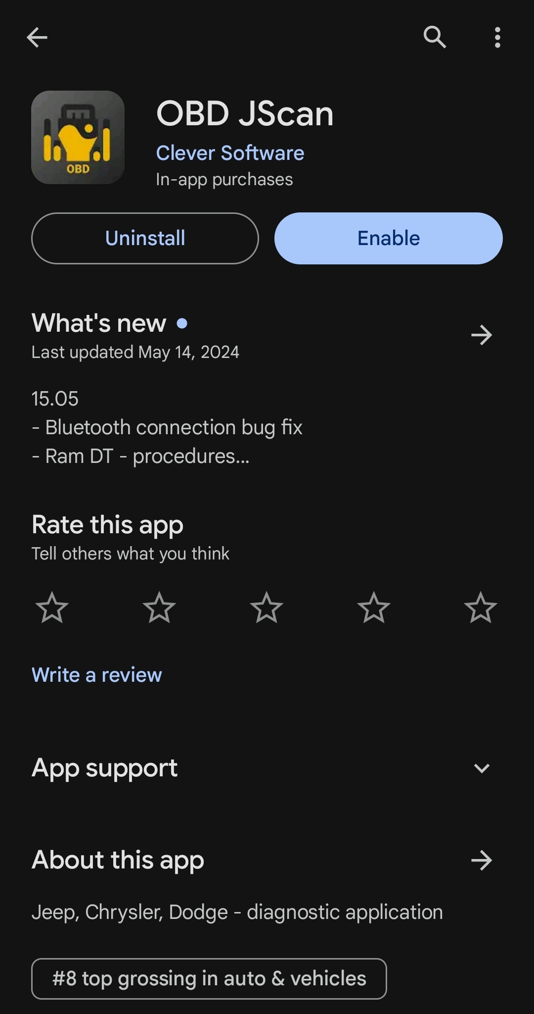

I have Jscan on my head unit.
That is exactly what I am going to use. And I purchased my scanner off their list. What's the name of their app on Google Play? I've been meaning to load it in my phone. But had not gotten around to it.
It's JScan, regardless of what you install it on. I have it on my iPhone as well as on the Android head units I've installed in the Wranglers.
