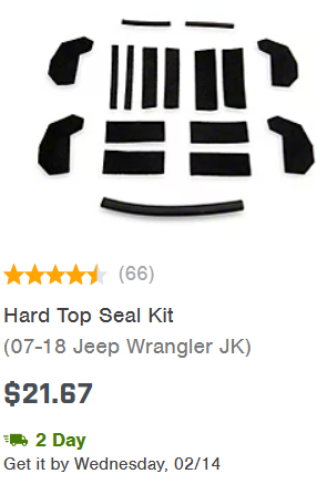

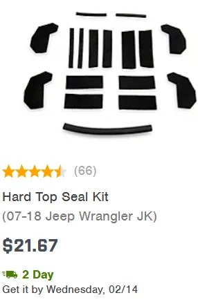

Is this the kit you bought? He specifically mentioned my header seal was needing replacing. If it's not in this kit that's an extra $70.
https://www.extremeterrain.com/crown-automotive-jeep-wrangler-hard-top-seal-68026937ab.html
These are small, pre-cut pieces for the corners and a couple edges on the removable panels.
For the perimeter seals, I bought some generic flat, single side adhesive famm weather strip from Lowe's and added it right over the top of the old stuff. It gets so compressed when the top is on, I decided to leave the old on, clean it up so the adhesive would work and just added the new over the old.
Has worked fine for a little over 2 years now. I still have a leak from the top front corner of the driver side door/freedom panel that gives me a very small puddle after rain, but it's not too serious.
