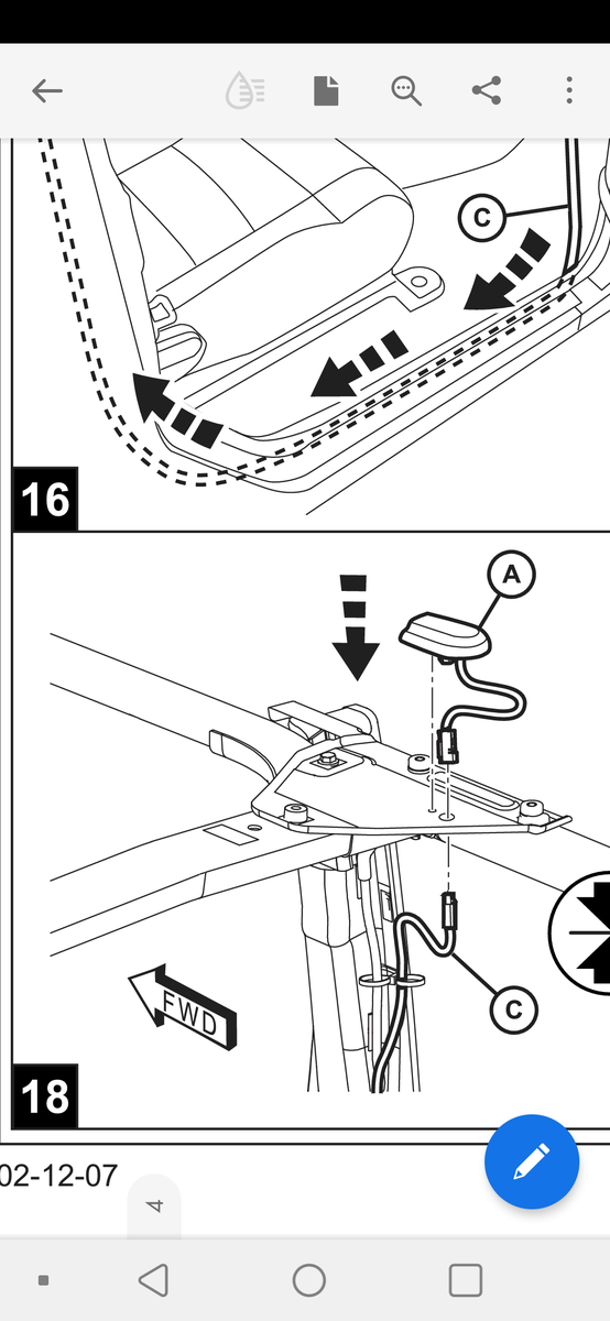

Where are the factory satellite antennas mounted. I have a Kenwood head unit that will accept a satellite receiver, but I'm not sure where to mount the antenna.
It's located on the passenger side of the roll bar, on the triangular attachment plate. If you pull back the roll bar padding, you will see where it mounts.
Quadratec has installation instructions on their site. Below is a screenshot of the pdf.

Do you know if that location will be acceptable for aftermarket antennas. Won't the roof obstruct the satellite signals?
With the stock radio, I used to get buffering but haven't had satellite in years. The hardtop was fine but the bows of the softop could cause issues. Like with any antenna mounted on a Jeep, there's always a compromise.
