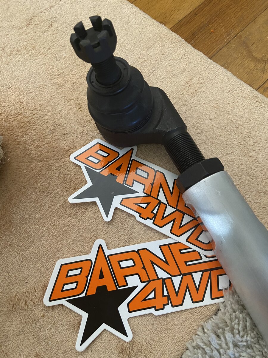

Barnes aluminum tie rod is installed. So far, can't complain. Honestly, the difference in firmness is not much from the OEM. Now its time to replace my track bar, because what I believe is on there is an imported after-market piece.

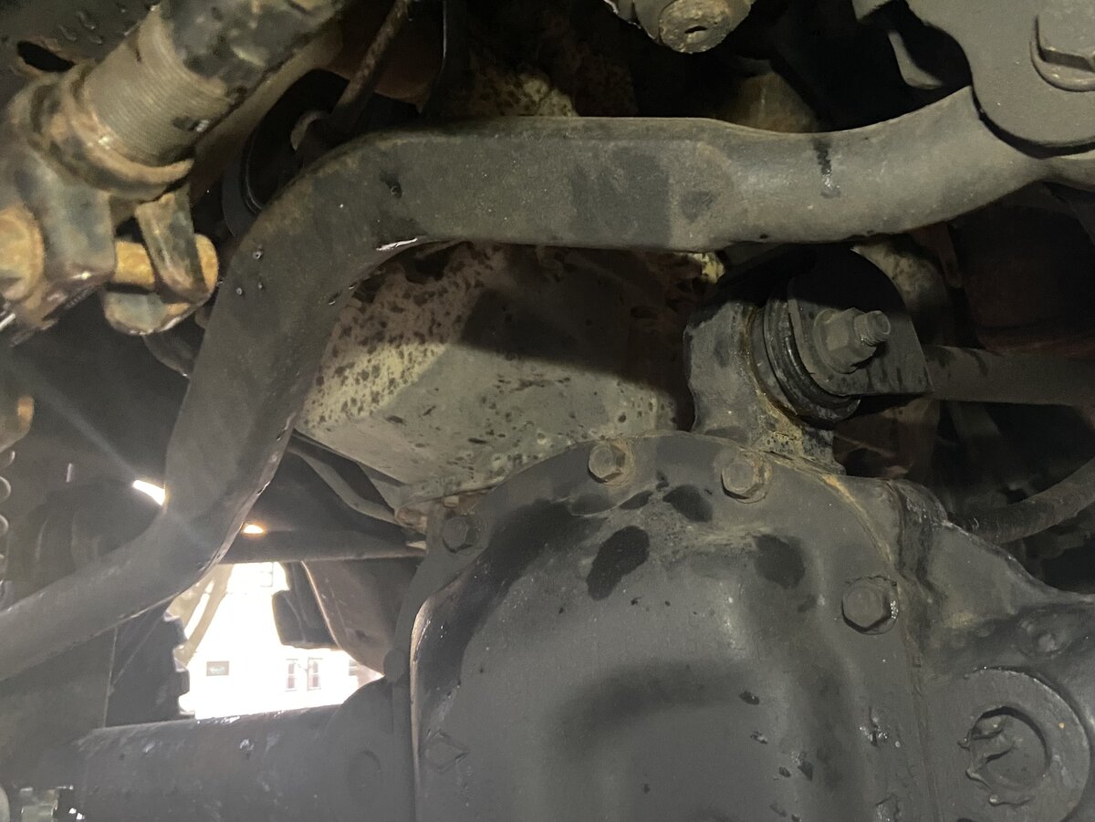

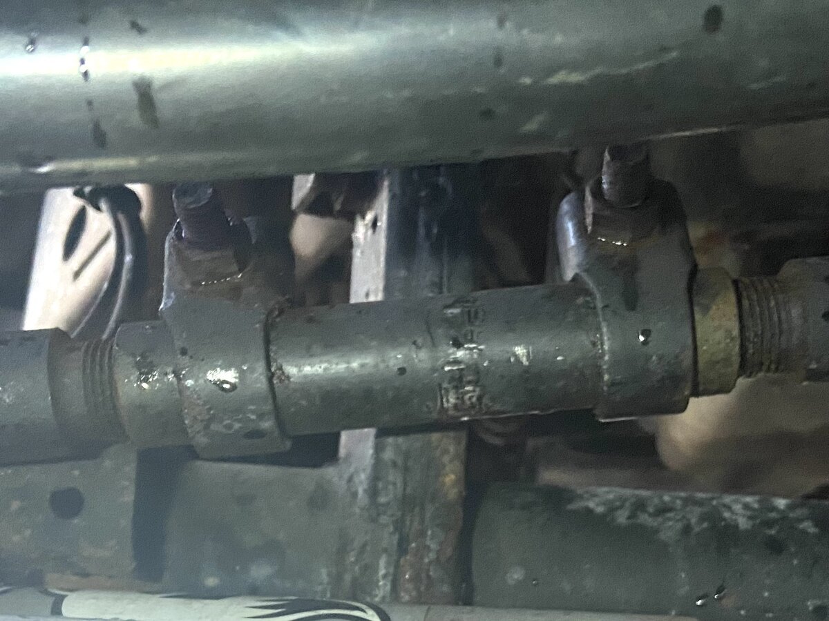

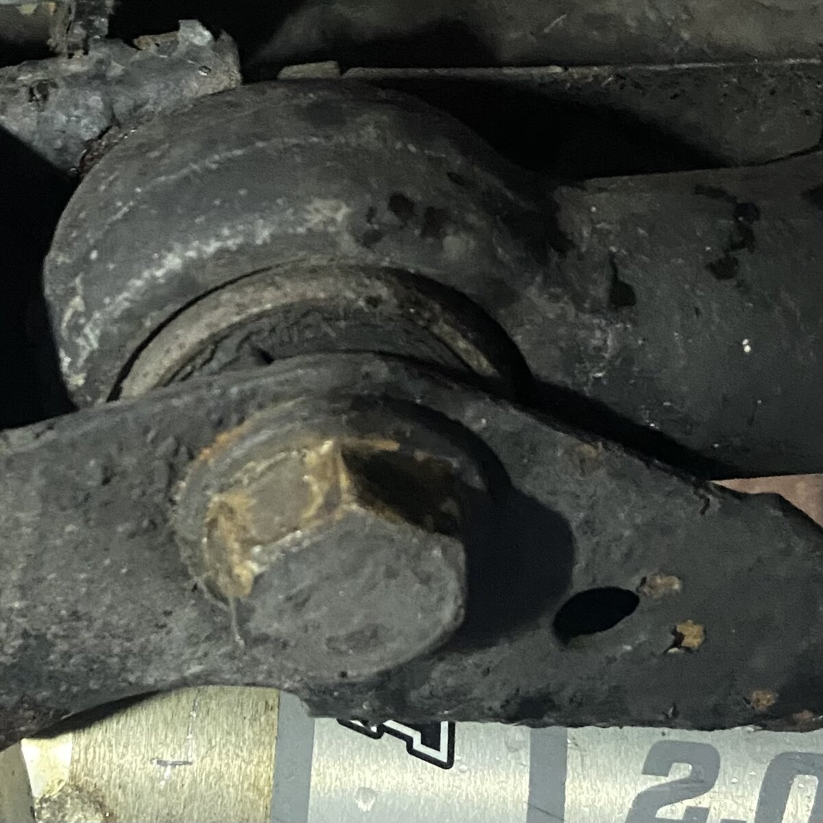

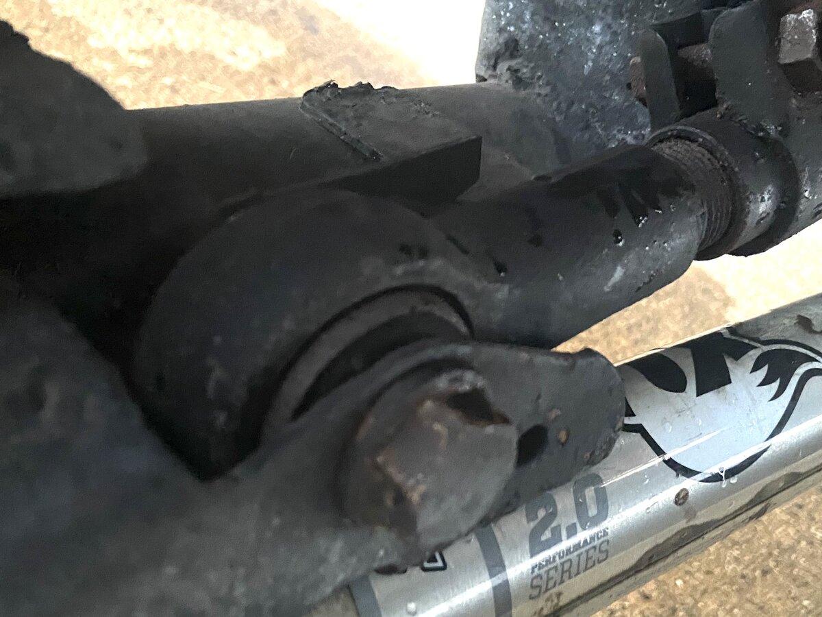

Currently, I believe Ive got the Teraflex HD (least its really looks like it) but its a bit boogered up, corroded and looks like the bushing on the axle side has some movement. I attached a photo so maybe someone can confirm if that's what I've got.
Yup looks like the Teraflex one to me.
Pretty sure the rebuild parts aren't too expensive for either the Teraflex or the Steer Smarts.
Just checked Teraflex and Steer Smarts websites and the replacement press in bushings are only like $30.
Yah, it's cheap for the Teraflex. I gotta confirm with them if it is in fact theirs. I'll give them a call and see if they can help.
