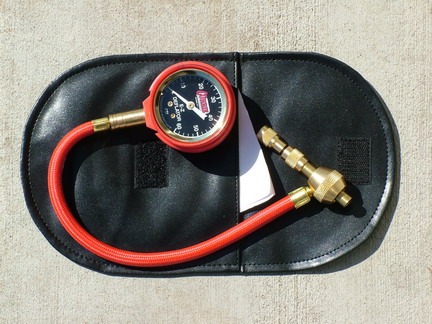

Step 1 – Check the tire pressure
There is a sticker on your Jeep that will tell you at what PSI the tires should be kept. This is typically around 37 PSI. Check the tire pressure on all four tires with a tire pressure gauge to ensure it's at the recommended amount. If not, then increase the tire pressure with an air pump until it meets the recommended level.
Figure 1. Use a tire pressure gauge to check the tire pressure.

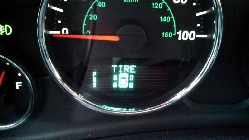

Recheck your tire pressure after driving for a bit. If it's lower than when you last checked, then you may have a leak on your hand. The TPMS is useful for spotting leaks because it will usually tell you which tire has low pressure. Lift the Jeep with a jack and inspect the problem tire carefully. If you find any tears or holes in the rubber you can either patch it or replace the tire completely.
Figure 2. Some JK models show you which tires have low pressure.

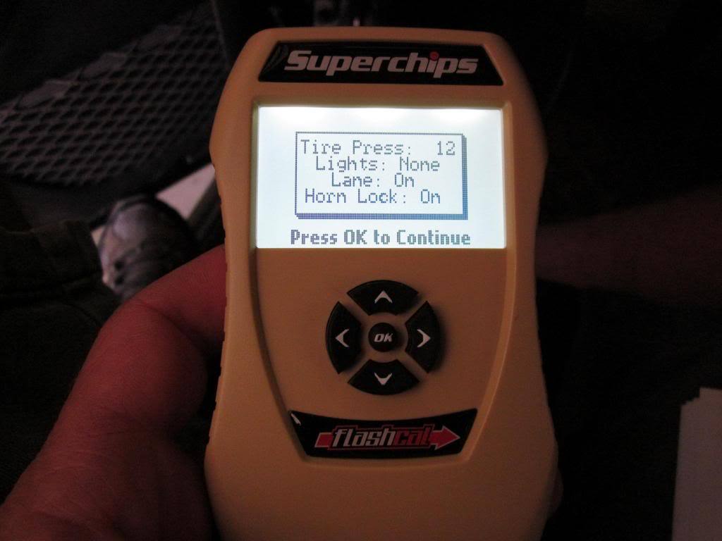

Flash programmers such as the ProCal module or the Superchips Flashcal are designed to work with the Wrangler JK. These programmers give you the option to adjust the PSI level that triggers your TPMS sensors or to even turn off the TPMS sensors entirely. However, this does mean that you'll lose the functionality of the TPMS.
Figure 4. Use programmers like this one to adjust or turn off your TPMS.

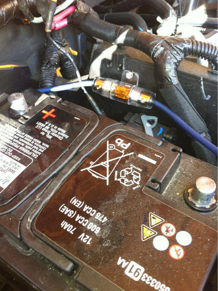

Step 6 – Unplug the battery
It is possible that the TPMS is stuck in a triggered state. Unplugging the car battery and leaving it unplugged for 5 to 10 minutes will reset the TPMS along with everything else. Doing this means you'll lose your clock and radio settings as well.
Figure 5. Disconnect the battery.
