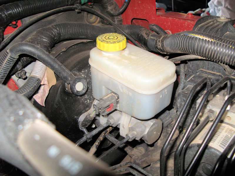

Step 2 – Check brake fluid
It could be low.
The brake fluid level has been known to activate the emergency brake light. Locate the brake fluid reservoir under the hood, right in front of the driver side. Check the level to see if it's lower than the max line. If the fluid is low, top it off and then use your flashlight to look for brake fluid leak. Check under the car on the connections between the brake calipers and lines, then check the master cylinder and all around it.
Figure 3. Brake fluid reservoir.
If the fluid's level is proper, proceed to Step 3.

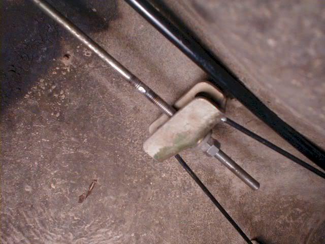

Step 3 – Check emergency brake cable
It could be loose.
The emergency brake cables run from under the car where your emergency brake lever is located and back to the two rear wheels. If the cables are loose, they won't activate the rear emergency brakes, which will cause them to be useless and will cause the car to slide off. If the parking brakes are loose, raise the car and remove the wheels, then tighten the adjustment screws on the emergency brakes. If it's too loose, you can adjust it from under the Jeep where the two lines meet, which is called the t-case.
Figure 4. T-case located under the Jeep, in the center of the car.
