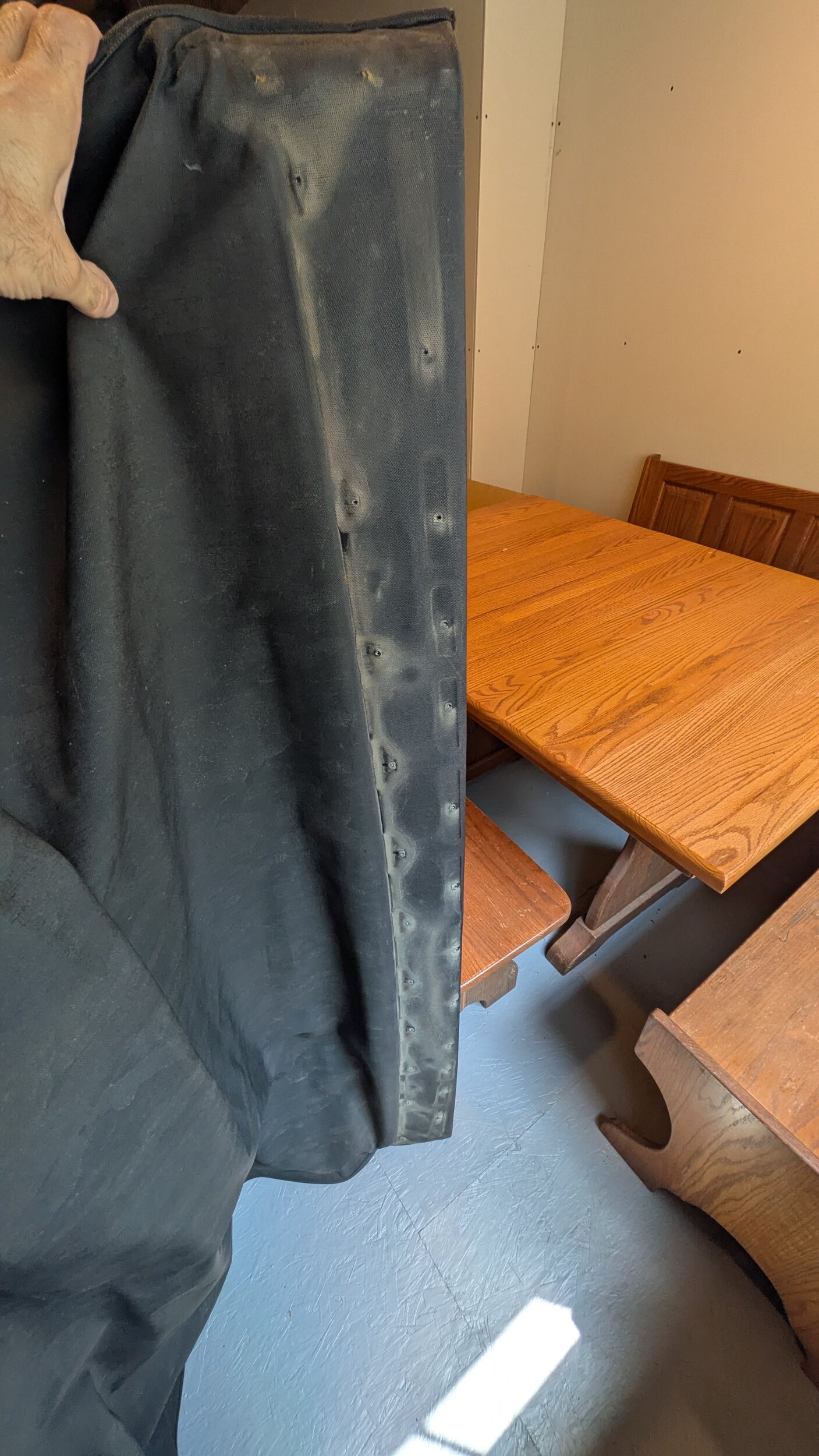

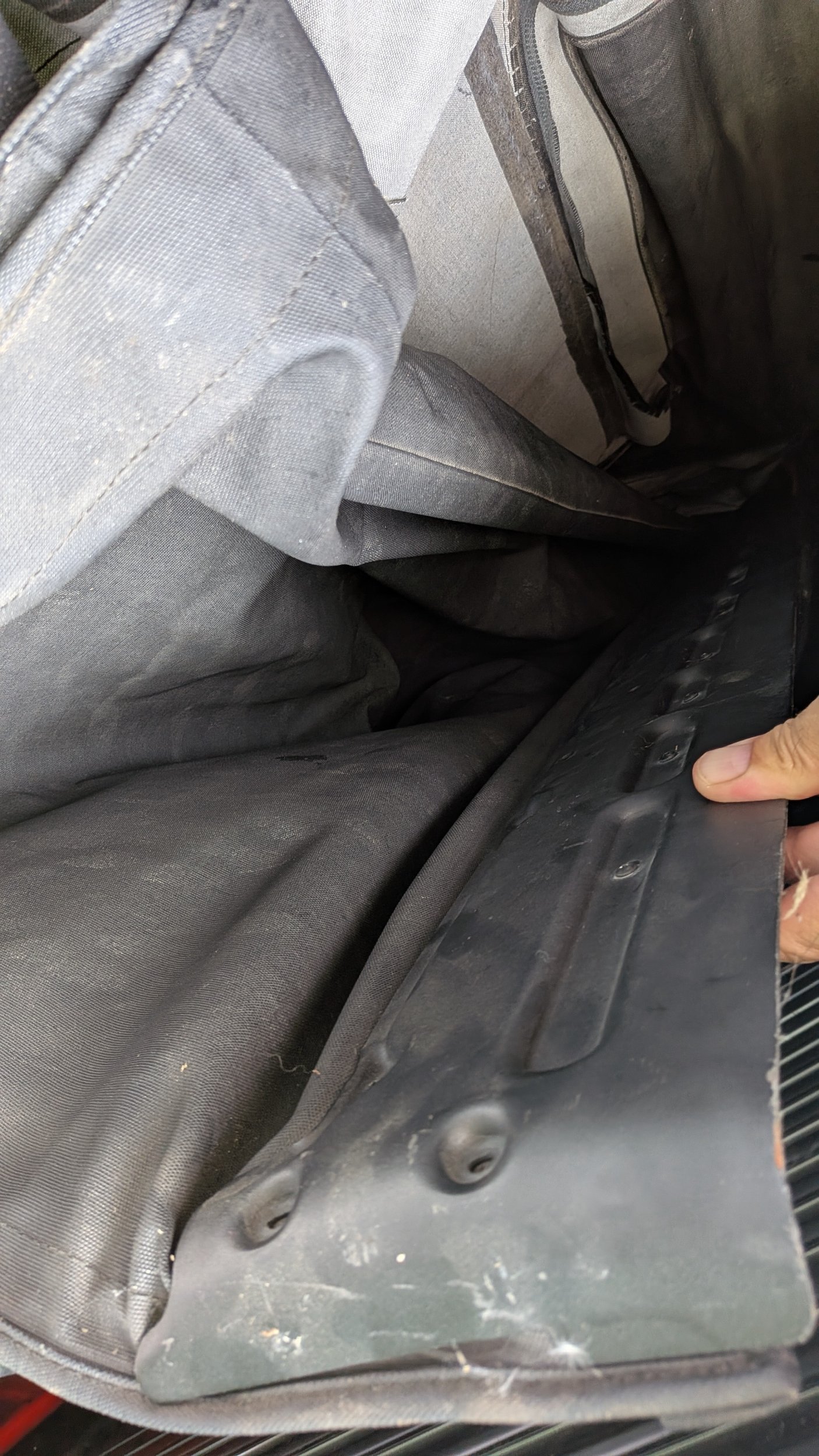

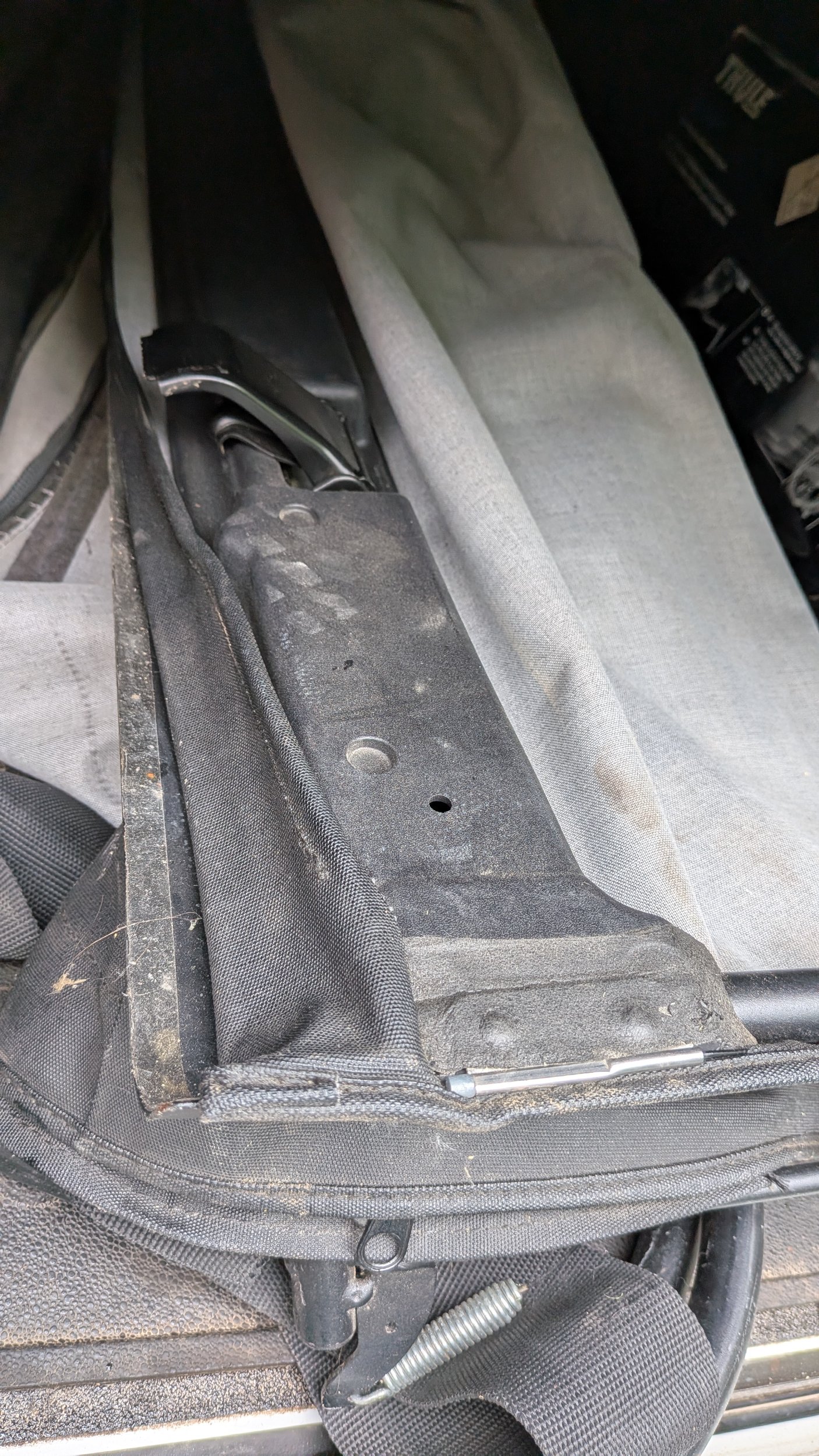

Question is about the windshield header... This one is mounted on top of the fabric and it looks like the fabric was replaced at some point - best I can tell its a Bestop Supertop w/ replacement Quadratec fabric. I haven't seen any like this before - can anyone shed some light for me?
Top front (outside):
Bottom front (inside)
Trying to learn and understand if I can get a replacement top for this framework or not...

After staring at this a bit longer I'm thinking whoever replaced the top did so incorrectly... The header has the Bestop insignia stamped into it so I don't think there is anything weird going on there.
Took it apart and indeed, the PO installed the header totally wrong. I took the opportunity to install it the right way just to learn how to do it, even though that fabric is trashed even more than I thought. It has ~27 screw holes in the front from the incorrect install.
So that's good though, I figured out the header is pretty standard and I think I can utilize the entire frame if I choose to just replace the fabric.
For reference... Header installed correctly, but now with "custom" vent holes. Just have to laugh sometimes at what people hack up. 😂
