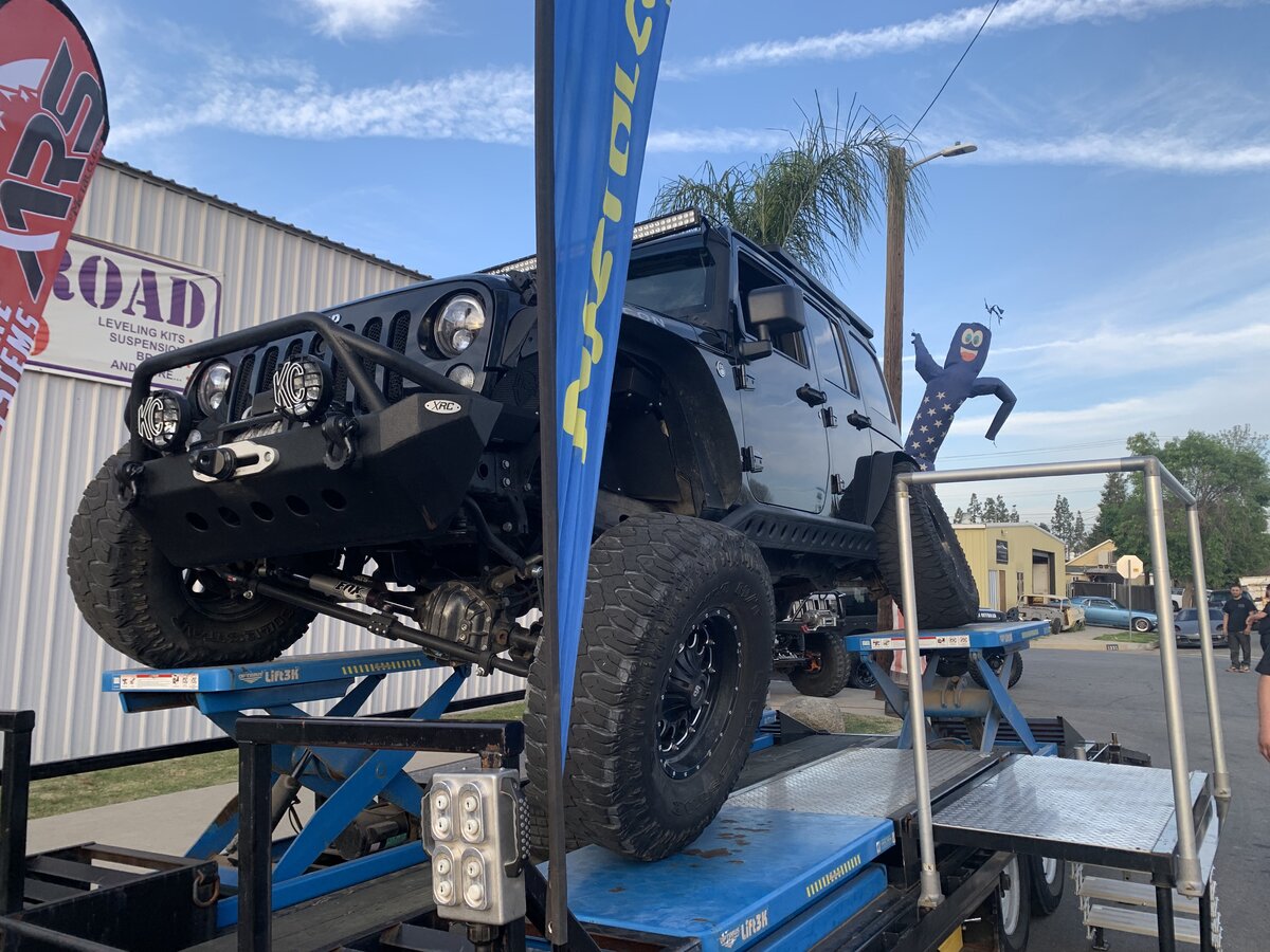

I don’t know if you have bought one yet. I have the 3.5” with Falcon 3.3s for a 5” to 6” lift, 26.5” brake lines and 14.25” drag links(the kit came with 24” and 12.25”) and flat fenders. I have alot of flex, especially downward. I did the longer shocks because I knew I would be running a minimum of a 37” and up travel would be limited anyway. I was running a 38” tire and just recently went back to a 37 due to the tire I wanted only going up to that size. Me personally, where I wheel there is a lot of off chamber situations so my philosophy is to be as low of a lift, while comfortably running the tire size I want. What kind of terrain do you see? What is your end tire size, going to 40”a one day?
The picture below is with 38s but not fully flexed out because my 12.25” draglink was about to pop through, hence why I went to the 14.25”.
