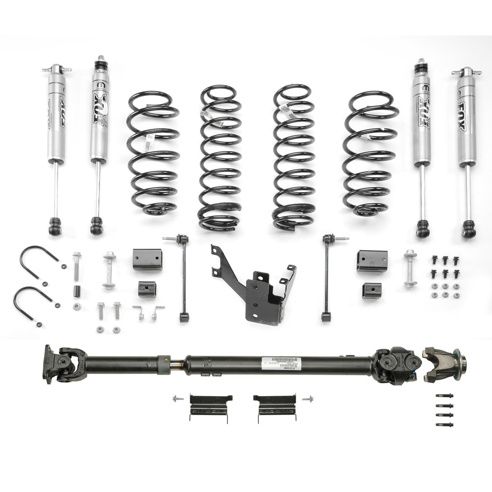

Here's the parts for the Mopar 2" lift:

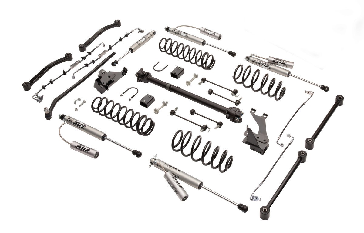

And here's the parts for the Mopar 4" lift:
Literally everything is different. The springs are longer on the 4" lift, the shocks are longer, it comes with new control arms, new brake lines, and a high steer kit.
Basically nothing on your 2" lift will work with this new Mopar 4" lift. You've got to buy the entire lift and start over.
I'm sorry to say that, but that's the harsh reality of it. Even the driveshaft will be a slightly different length for a 4" lift.
