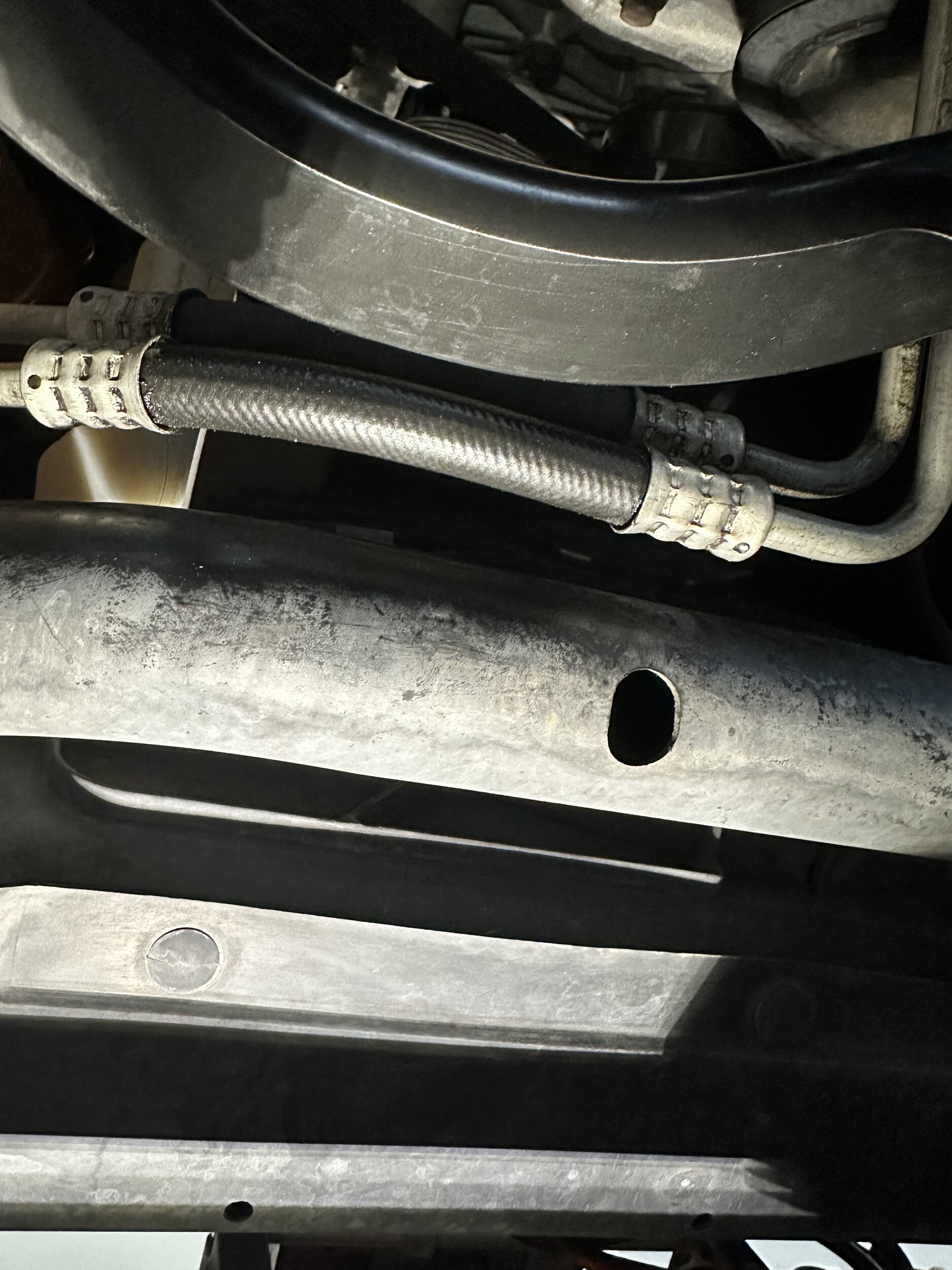

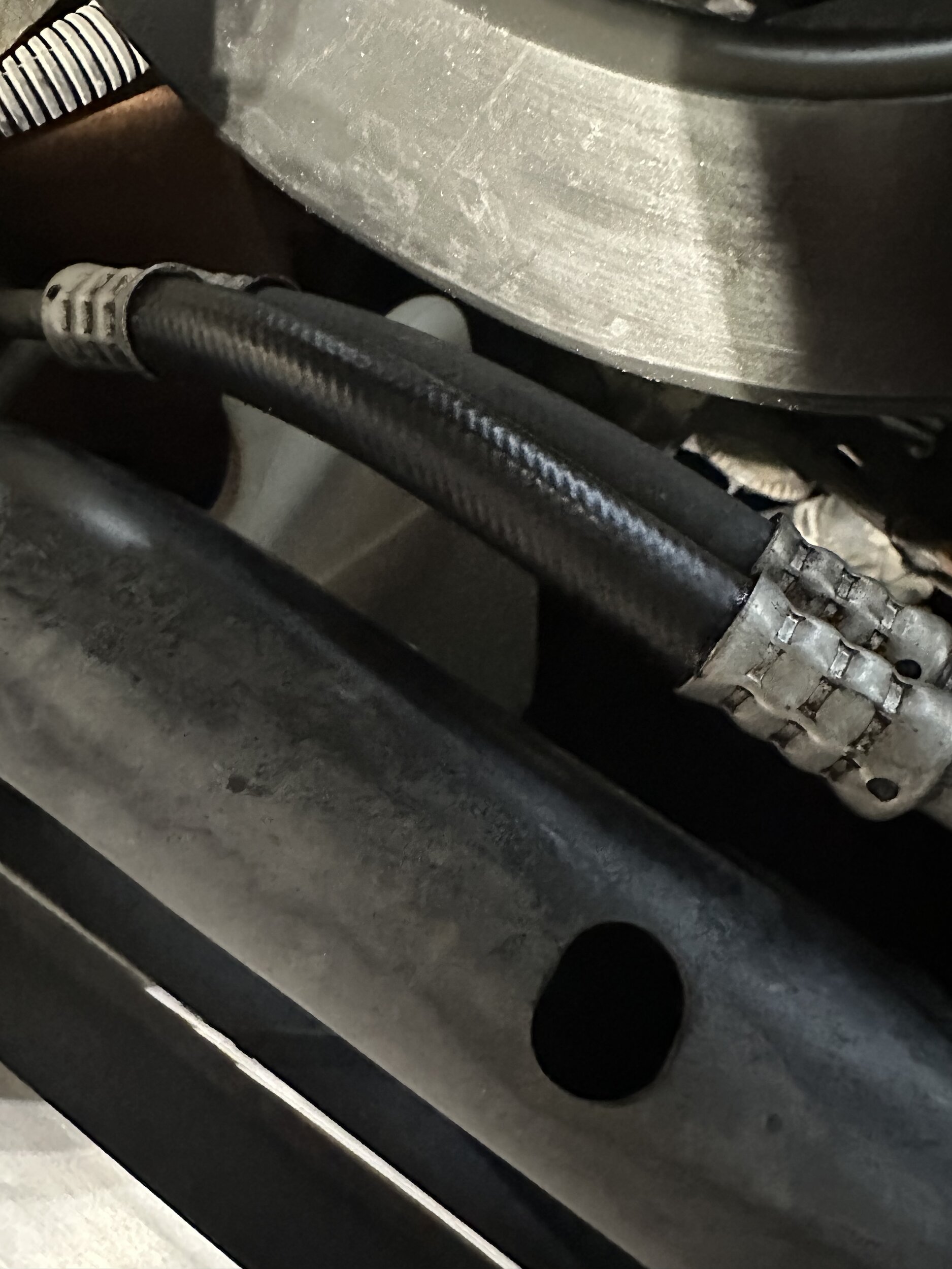

Those rubber hoses over time start getting hard and shrink especially in the cold, so the ends that have the aluminum crimps around them will start to seep. The best thing to do is to replace them with a new assembly, but i've cut the aluminum clamps off before and used hose clamps to make them stop leaking. 2 clamps on each end will make it quit leaking, but you'll still have old hose though.
