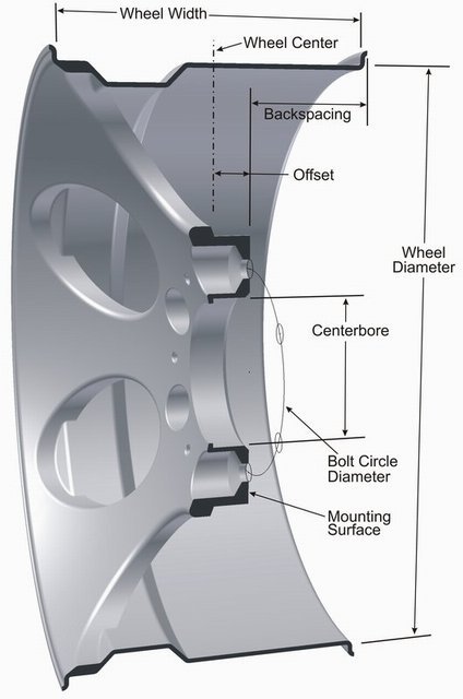

The backspacing on stock JK wheels is 6.25". That means that the mounting surface of the wheel is 6.25” from the rear lip of the wheel. The larger the backspace number, the further under the fender (and closer to suspension components and airdam) the wheel will be (see below image).

As I mentioned initially, the stock wheels have a backspacing of 6.25”. This is too deep of a backspace to allow proper clearance for a decently wide tire. The general consensus is that the “magic number” for backspacing for the JK is 4.5” or less. It does not mean you can't run a wheel with 4.6”+. But 4.5” and under is the safest bet.
Many 15” wheels have less (sometimes a lot less) than 4.5”. That's so the wheel clears the brake calipers. Most 15” wheels come with 3.75” of backspacing (MB72, MB TKO, etc). There are a few that come with more (such as the Black Rock 909 – 4”) and some that come with less (such as the Level 8 Tracker – 3.32”). Just remember, the lower the backspace number, the further out the wheel will sit from the Jeep body. One of the most common wheel/tire combos on this site is the 15x8 MB 72 wheel with 33x12.5x15 Duratrac tires. Dozens of people run this setup without a single issue on the street. However, just like most of the other 33” combinations, you can get some fender contact when offroad.

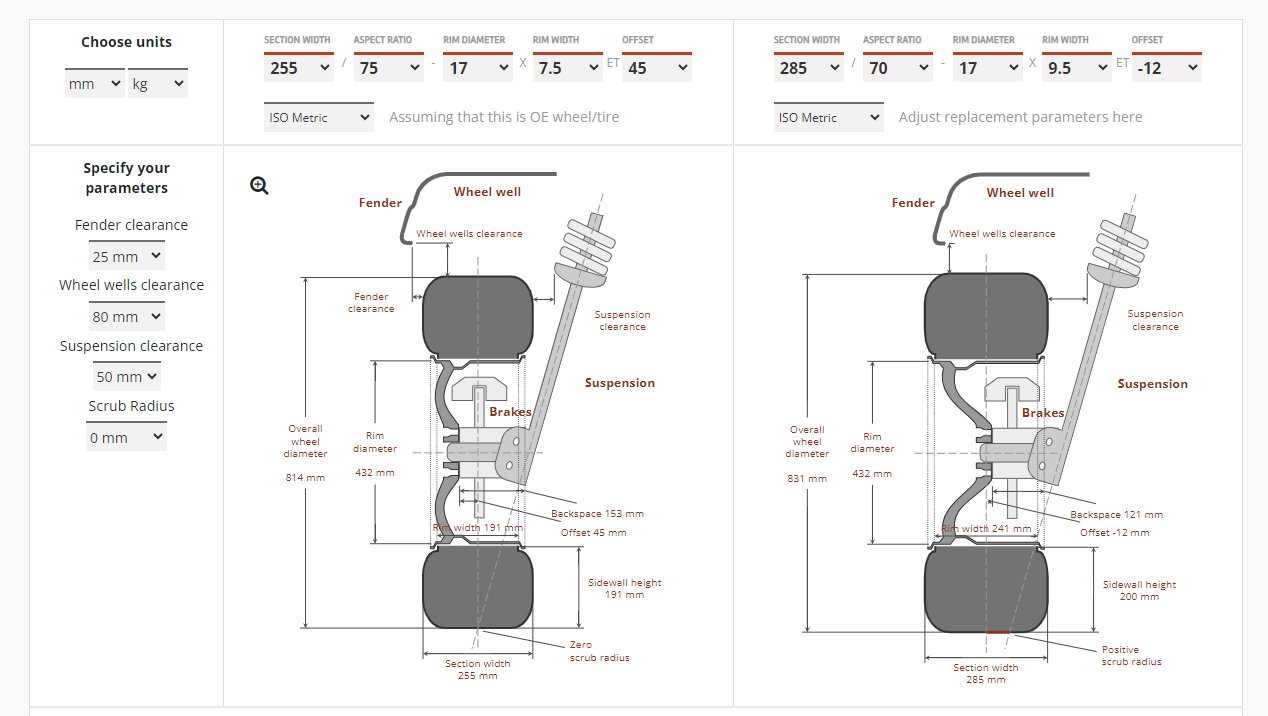

Utility to compare tire sizes
Wheel / tire fitment calculator

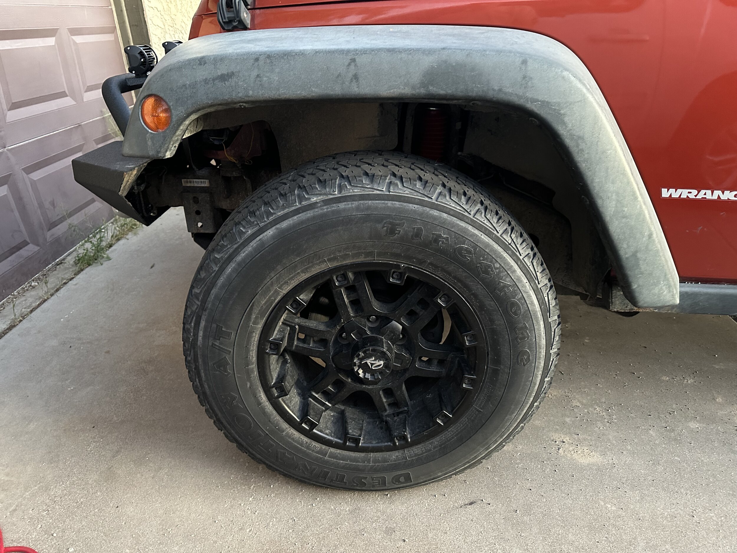

09 Rubicon 6 speed manual, as far as I can tell stock height so here is the real question.
Are there really any advantages of putting bigger tires on? I do a little light off roading mostly mud, I love mud.
Everyone keeps asking me when I am going to put 35's on. I don't think I would go 35 maybe a 33. But if I were to go 33's i have a few questions.
I don''t really care about the gap between the body and bumpers as I have put steel on the front and rear and there is a gap anyway.

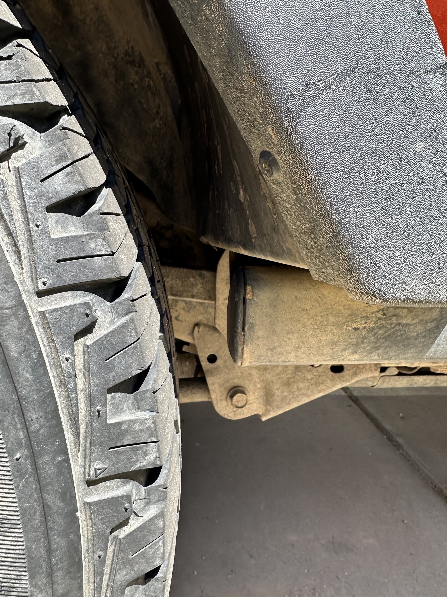

I have the Rubi Rails on it and behind those the pinch seam is at the same distance as the rails, which looks to be about 1.5 in away from the tire 255/27R17. The Rubi Rails are coming off because 1. they are rusting and 2. I will be putting side step on it, so I would still be concerned with the pinch seam rubbing. See image. I do not have stock rims and I don't know their size other than being 17's.
I took it to Discount tire, they said the rims will work but I need a 3" lift to keep a 33" from rubbing. Would that be a true statement? When I bought the Jeep there was a unopened boxed 2" body lift kit, Would that be advisable?
I have done a lot of searching on lifting the body and have found 1 major problem with a body lift. I cannot find a lift kit for the motor and transmission. All I can find on that is a 1" lift for the motor only. Any help with that would be welcomed.
I don't believe I have left out any vehicle info but if I have let me know.
Thanks for any help!
Your rims will not work for 33s.. Read this thread you just posted in, specifically the post RIGHT ABOVE yours.

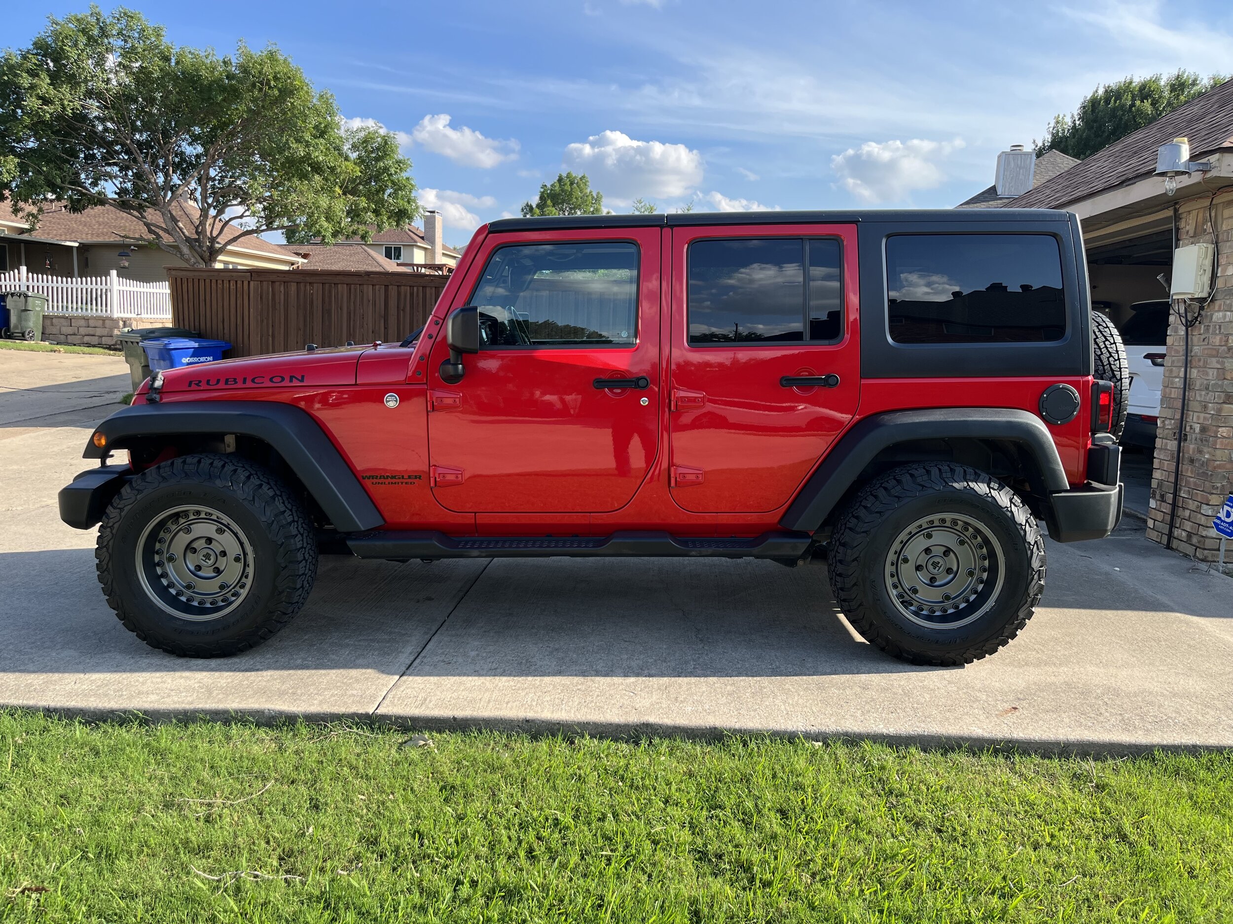

One thing I do not see mentioned much, and I ran into today, is wheel width. The stock 17” wheel on my 2015 JKU Rubicon is a 7.5” wide rim. That coupled with the negative offset of the stock rim was not conducive to my planned build. So I bought some Mammoth wheels that were 17x9.5 with a 4.5 offset. Pretty much what I would call a neutral wheel. Meaning the mount point is closer to the center of the wheel. I planned on running the 255/75R17 for a while before getting new bigger tires. Well, come to find out the shop would not fit a 255 tire on my new rim. It was actually too wide for the tire. They shot me a pretty good deal on some BFG AT AXO’s in 285/70R17 which fit my build, even though I really wanted a taller tire.
Anyhow, the point here is that you also need to consider wheel width. It seems that most aftermarket wheels come in 17x9, the ones I really wanted just happed to be a bit wider. Nothing I had considered until today. The extra half inch will mean that the tire is probably a fraction less tall than it would be on a 7.5” rim. Just food for thought.
