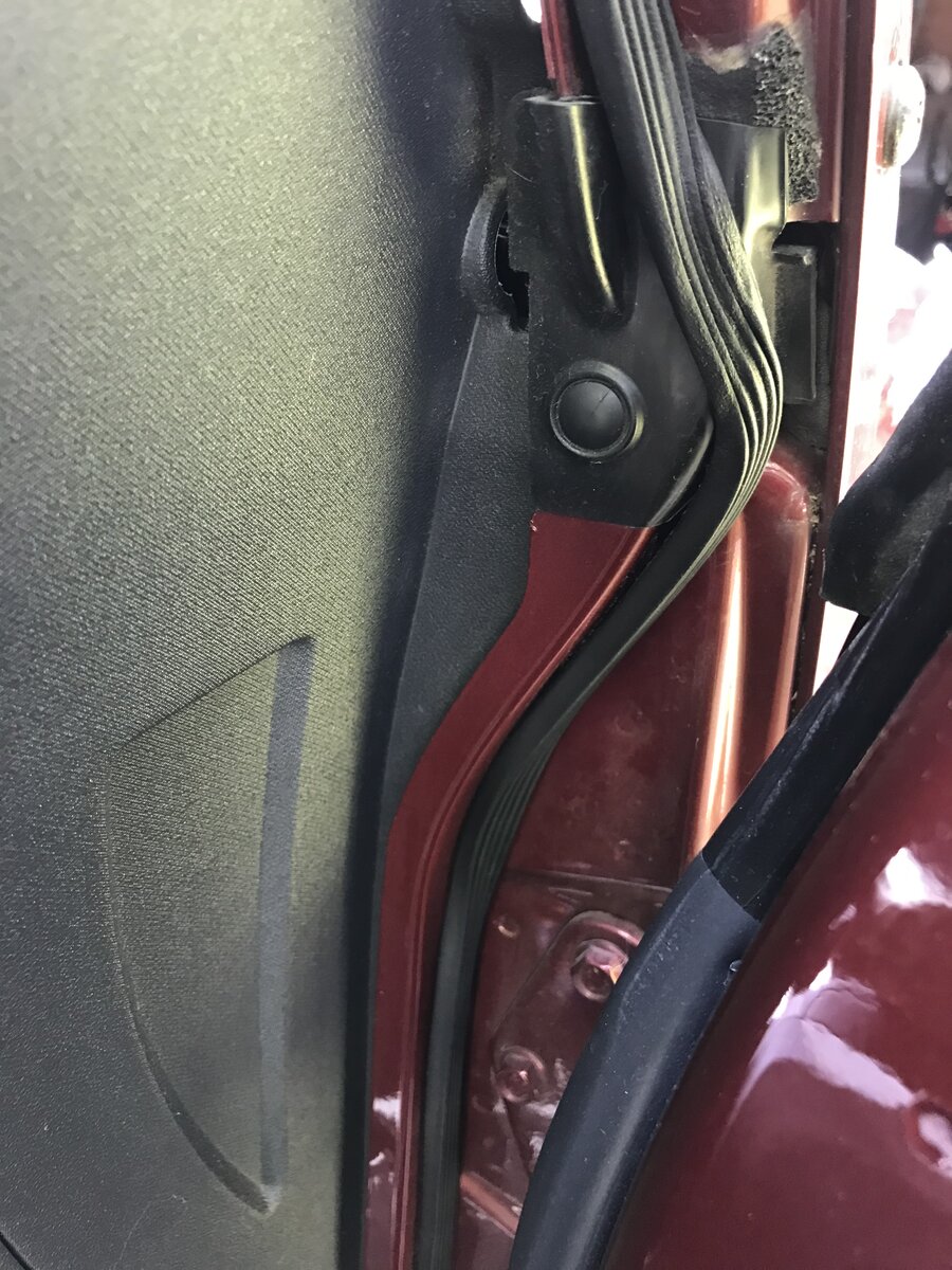

I had a leak on the passenger side door. Seemed to me it was coming from water channeling down the A pillar. Used some self adhesive auto weather stripping and it went away.

I refuse to accept the, “it’s a Jeep, deal with it” concept. I’ve got an 01 TJ that, at one point, leaked. After some inspection, I concluded it was a door seal, which I replaced. No more leaks, no matter how much it rains.
Another preventative thing I do is moisten all my door seals with Fluid Film. I spray it between the seals and the doors. I also rub the Fluid Film onto the seals with a rag. Keeps them moist and pliable. Did this with both my Jeeps. So far, knock on wood, it’s been affective.
