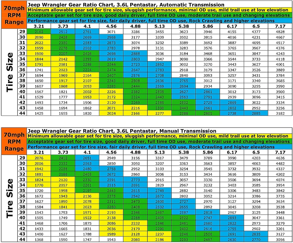

I have a JK 2016 Sport unlimited and have a 3.21 stock gear ratio, I'm not sure what I should change it to, but right now its too sluggish. I currently have 37" Tires with 20" rims. I don't do much climbing, but a lot of people have told me different things from re-gearing to 4.11 to 4.56 to 4.88. I know that over 5 is too much for what I do and the cost is basically the same for the other ratios to change-out. Does anyone have a recommendation and a legitimate reason why they choose that ratio?
My 18 Sahara JKU came with 3.21 gears and 35s. It's a sluggish turd on any incline over 30 mph. I dont see how you are doing it with 37s. I notice it more when I have the back of the jeep loaded and all the family with me. I'm definitely going to change gears to at least 4.11 but considering 4.56. I would think with 37s you would need at least 4.56 minimum. Only thing though, I think that if you go past 4.11 you'll also need to change the carrier out as well.
On my 2011 jk I had 373 stock gears and now running 37" tires with 488 gears. Seems to be a perfect combo for me
I run 4.56 on 35x12.50x15. The weight of the tire is almost the same as a 37x12.50x17 so it should in theory be similar. I get 17-18 on the highway 15-16 in town. 4.88 is going to give you a big more low end grunt but higher rpm up top. I'm at about 3k at 70 mph which isnt terrible in 6th gear. All depends on how much you care about mileage.
