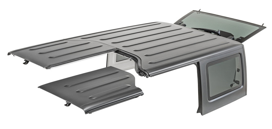

This article details the differences between the Jeep JK Wrangler Freedom Tops throughout the 11-year run of the model, and also everything you need to know about adding a hardtop to your JK or JKU Wrangler.
With the Jeep JK models, there are several remarkable differences between the factory hard tops available throughout the line. All factory hard tops have removable “Freedom Panels” above the front seats for quick open-air driving enjoyment. These are easily removable without tools, and can be stored safely inside the Jeep if you have a storage bag. Without a storage bag, fitting them in the Jeep without them banging against each other or other parts of the Jeep, can be very difficult. Padded storage bags are very inexpensive compared to replacing even one of the Freedom panels from scratches or other damage.

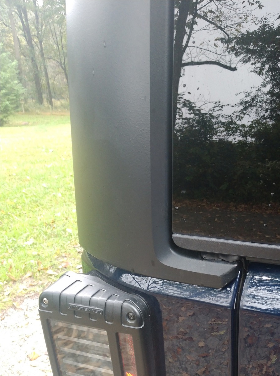

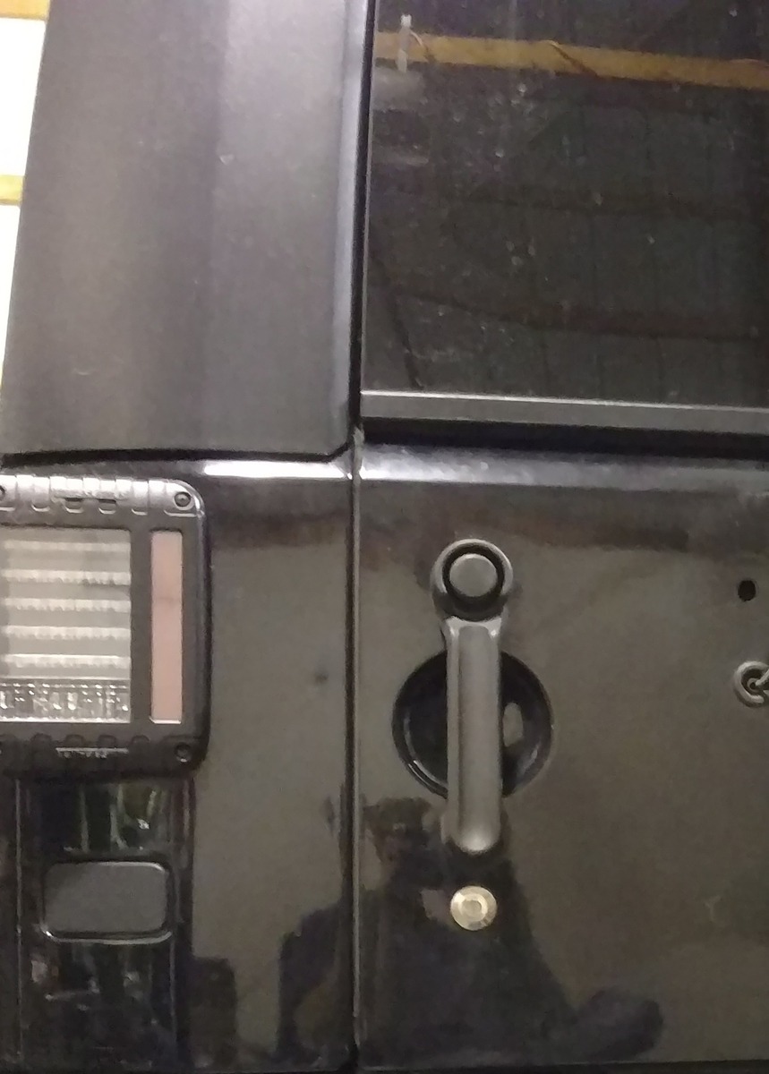

In 2011, the rear window was also changed to increase visibility. This new, wider window is extends beyond the edge of the tailgate.
Note: It is also worth mentioning that the later model tops have an additional metal locating pin in the rear section of both sides, that slides into a body hole on the later model Jeeps. This pin may need to be removed if your Wrangler does not have a corresponding body hole.
