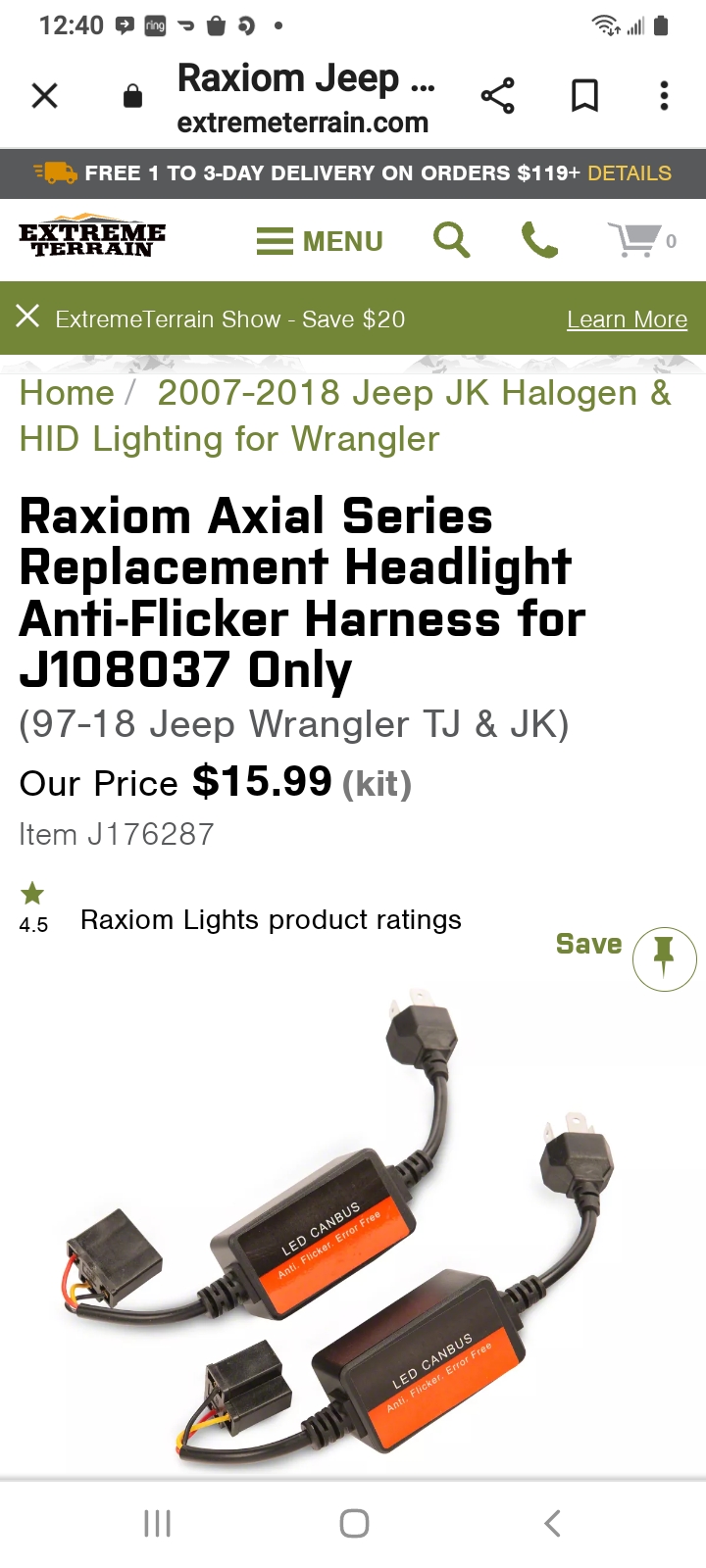

Hey adamis, so if the ground wire is fried you have some sort of electrical issue putting in the new eyeball may burn it out again sounds like too me it was an upgrade at some point .you may need a new anti flicker harness with the ballast between the plugs...I will post pictures shortly

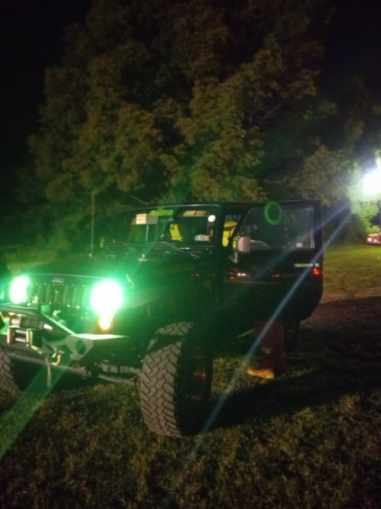

So my 2008 j/k is running H13 with the halos and the anti flicker with ballast
Aha. good to know. I dug into the loom a little more and as luck has it, the h13 connector was still in there. This was just an adaptor. I presume the other side is the same way. So lucky for me no need to get fancy crimping new connectors! I assume a straight h13 to h4 connector with ballast for LEDs will do fine now after I order some up.
Awesome brother glad I was of some help also at each connector wrap them in electrical tape sometimes they come loose at the plug ins and cause flickering especially if your off road or on bumpy roads...good luck
