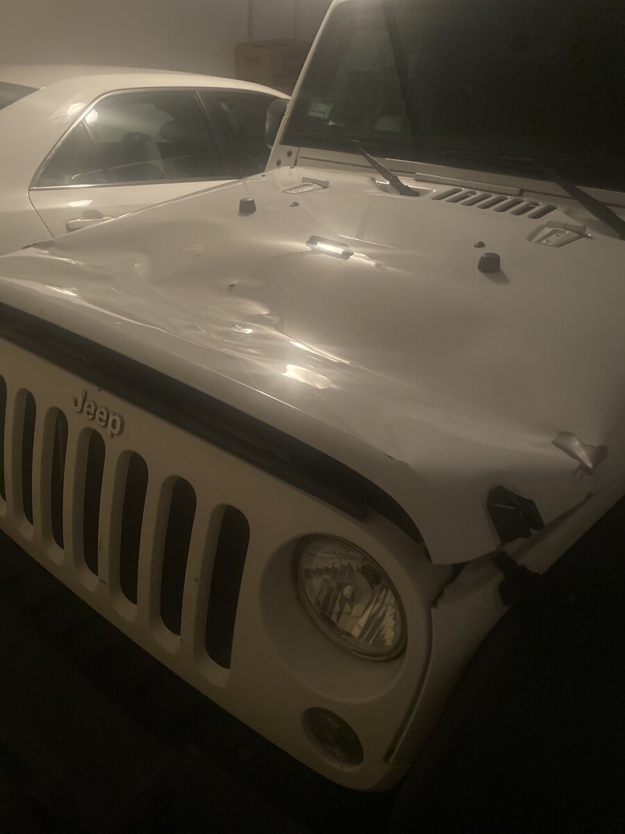

Well, although we do drive Jeeps, I try to take care of mine and keep it in nice shape. I live on a golf course and last week someone sliced a ball and it nailed my hood. Got a quote to remove it out of curiosity and they said $350. I laughed.
A nice trick however is to use ice. You have to get the metal blazing hot and then apply a ice cube. Slowly, but surely it pulled out my dent.
The original dent was so deep I could set a golf ball in it and it wouldn’t roll off the hood. Now, I have to really look hard to find it (and I’ll still try again once it gets super hot again).
Just a tip.

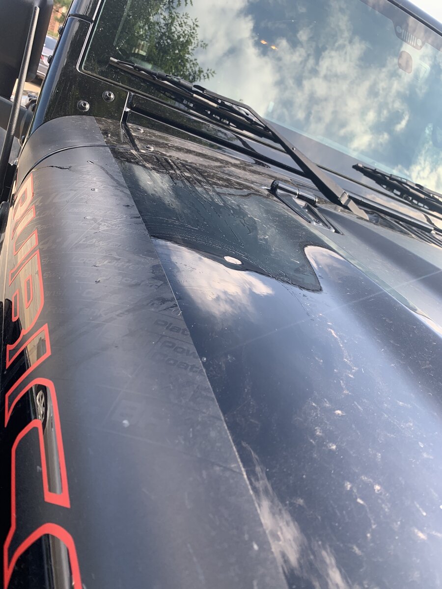

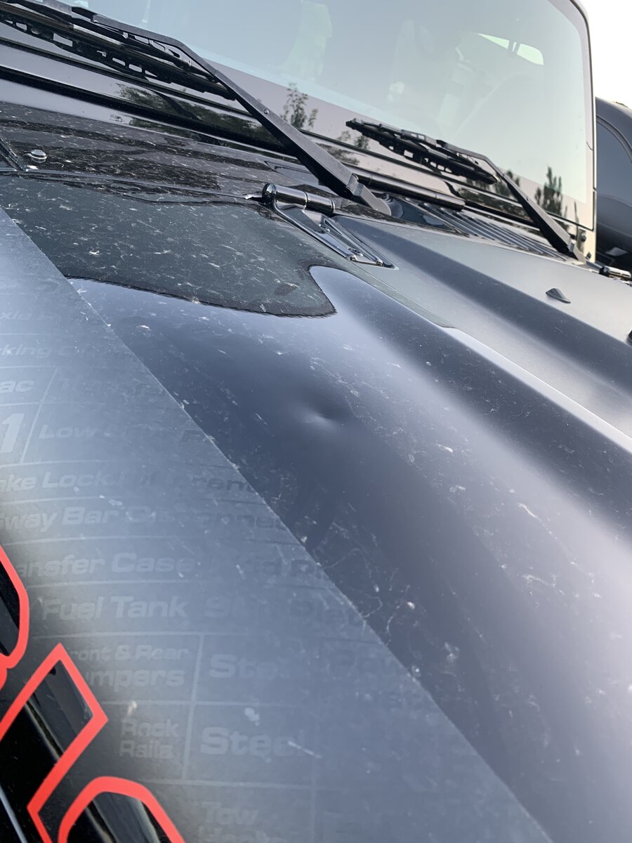

When my dad said give it a try, I scoffed at him. ”That will never work” I thought, it’s just ice. To my surprise, it did wonders.
Now that may be because my dent was the right size, just big enough to not really tweak the metal into a hard bend, but just small enough to not require any real body work.
