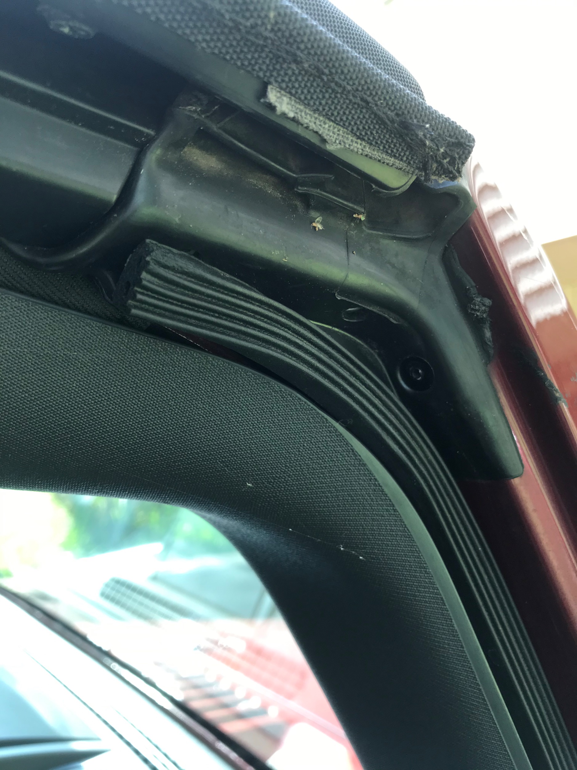

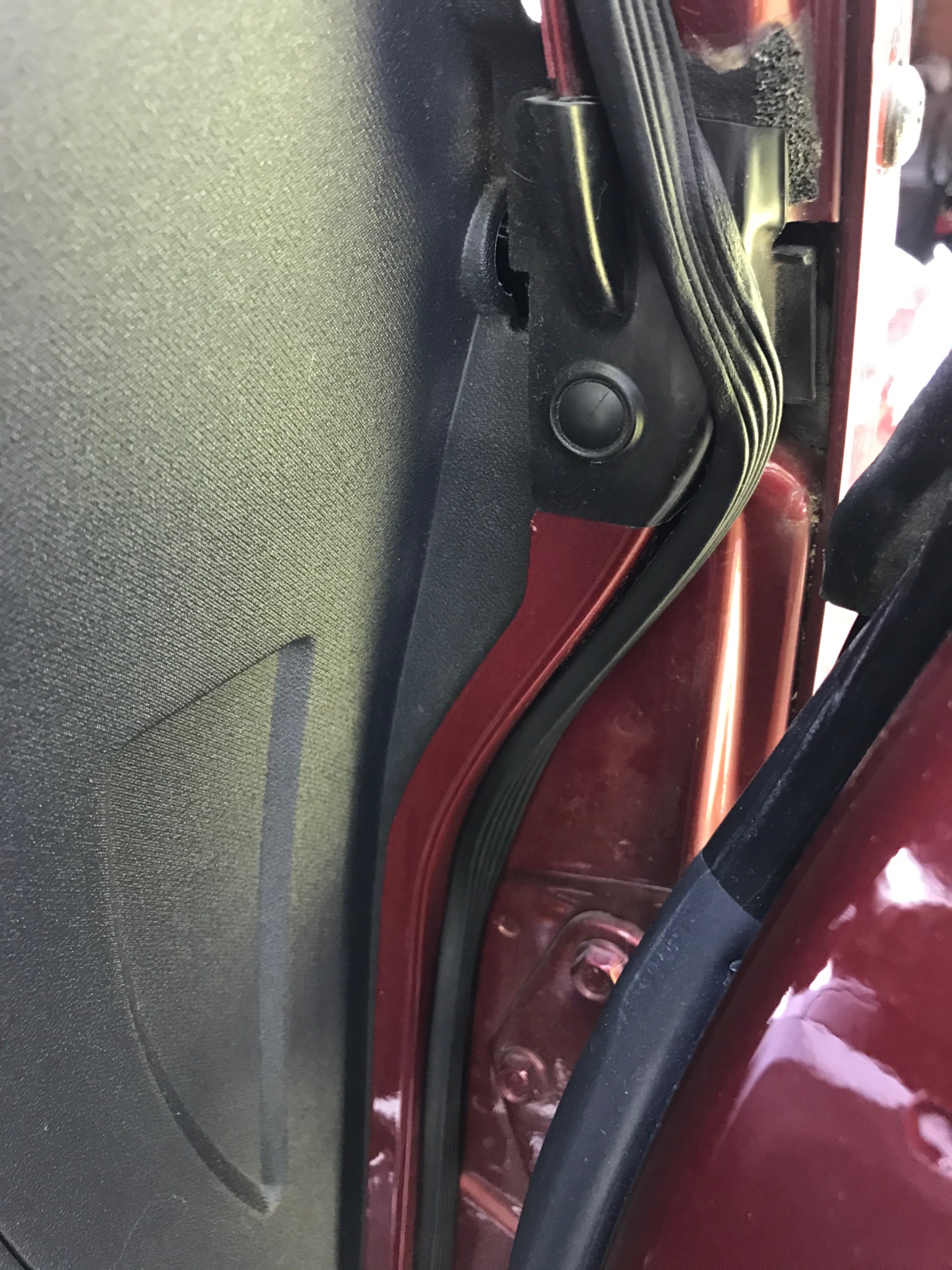

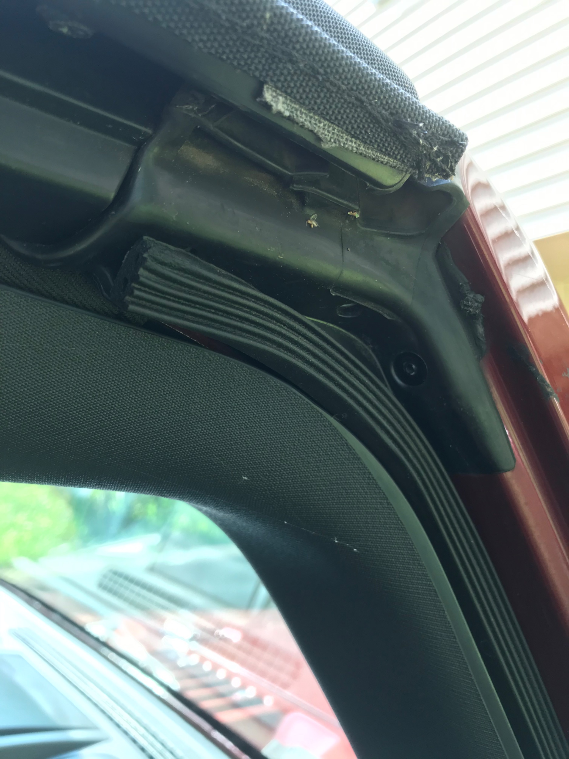

I got my 2012 Wrangler Sahara in January of this year. Just noticed whenever it rains or I go through a car wash I get quite a bit of water on the front passenger floorboard. I don’t get any water anywhere else in the vehicle. The first time I took the doors off I got some dirt on the door seal along the front leaning edge of the seal, but I cleaned it completely and still got water during the first rain after cleaning it. Does anyone have/had this issue and what might be a solution?
This is what I did and it helped a lot. Added weather stripping to stop water from running down that channel.

Welcome to the jeep leak. We all have it at some point. There is a company out who developed new door seals and a couple vids on YouTube of a guy installing them. Supposed to fix it. I, like many others just went the home depot weather strip mod.
Dont panic, nothing bad will come of it as jeep designed these rigs to handle water inside and out. But its annoying regardless.
