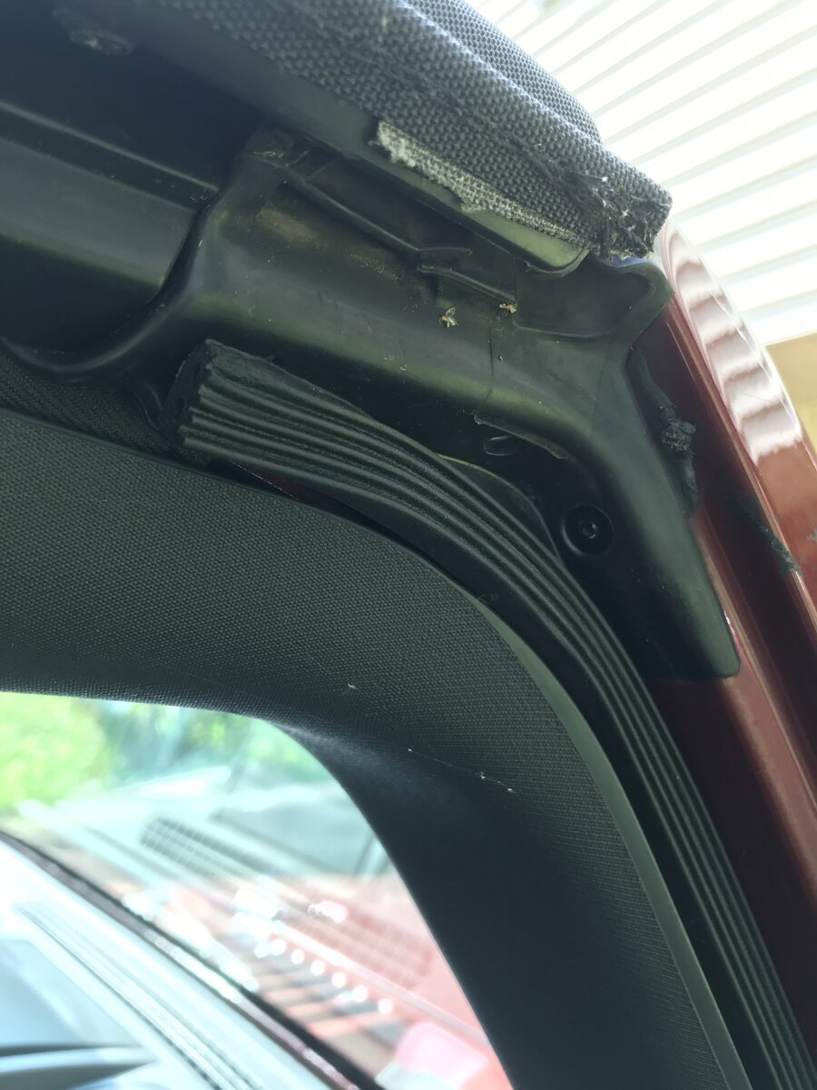

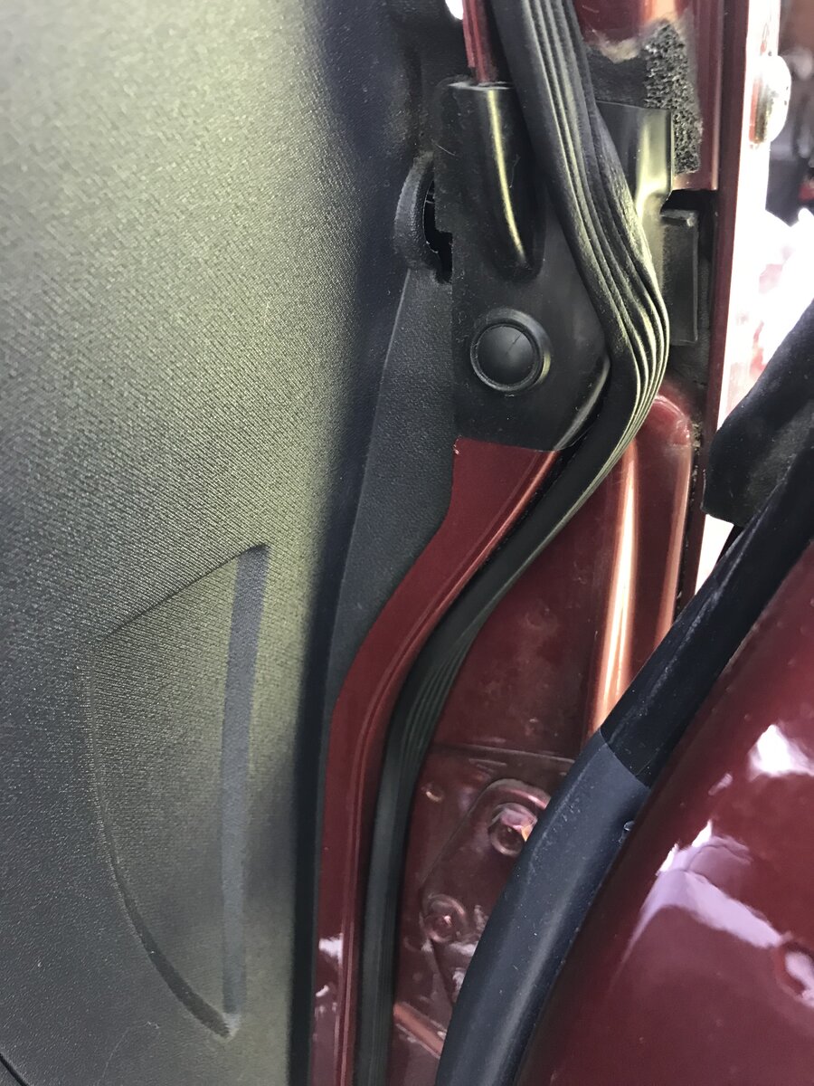

I have a JKU w a soft top. When it rains, particularly hard rain, I’m getting water inside. I believe it LS coming in thru the B pillar as the seatbelt is wet and the water is under the front seats.
It seems to leak when the soft top is on. Is there a weatherstrip kit I can install? I’m thinking it’s due to the door surrounds. Any ideas?
There are a few different versions of the soft top based on what year it was made. If the top is original equipment what year is the Jeep? Also, soft tops don't last forever.
Easy way is take it through a touchless car wash and see what comes in.
Had a leak at the A pillar when it really came down. A length of auto weather stripping stopped it.
