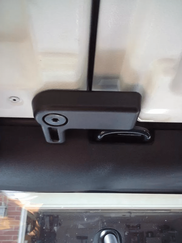

And one of the most notorious places is the front center right above the rear view. Be very careful as the water will drip right on the stereo. See the loop in this photo? I've wrapped mine in a textured electrical tape (2 layers) so the latch will remain tight. You could also remove the loop and add a couple small washers.
