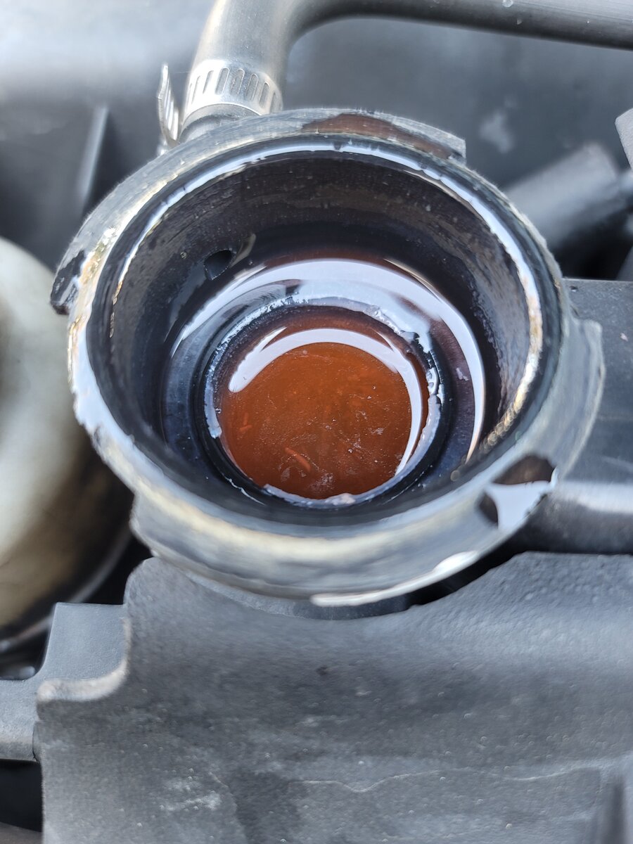

I checked the fluids and carpet at the firewall tonite. No wetness at all on the carpet. Super dry. Coolant looks good. Plenty in the reservoir. And I took a pic of the fluid with the cap off below.
Oil was low though. And dirty. Smelled a bit like gas. But it seemed normal for dirty oil. I mean not badly of gas.
I also took two videos of the engine running. To hopefully show the tick. Its not bad. I think its maybe the beginning of the rocker arms needing replaced.
It does look like some stuff floating on coolant. Can't tell what it is. Or if thats normal.
