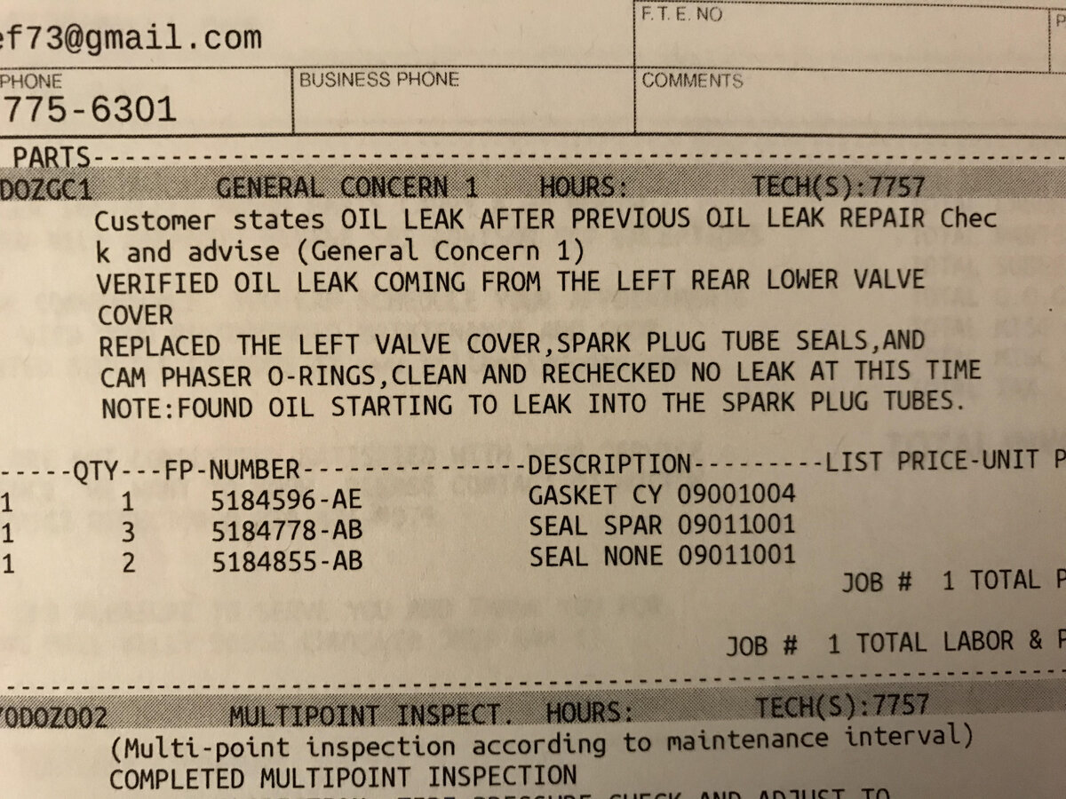

Well, once again the third time since Dec 16th, oil was seeping from the oil cooler area. This time he says the rear drivers side valve cover is leaking...Wow...When it rains it pours...I just hit 50K miles and crap starts happening...
Now, I'm wondering if they mis-diagnosed the original leak...Any thoughts? They replaced the oil cooler on Dec 16th, hmmmmmm??
Here is what they did, and parts used...Are valve covers on Jeep Wranglers known to leak after only 50K miles? I had a service tech tell me as I was picking up the vehicle that when a Jeep starts to leak, you will never stop it...I find that a very stupid comment to make...As long as there is no damage structurally to the motor of attached components these should be able to be repaired...He based his comment the miles on this vehicle...So he's say that i have to live with oil leaks for the duration of ownership...
Guess i will have to buy some drip pans then and use those just like the ones we used on aircraft in the Air Force....:confused: I don't buy it, I've been around maintenance and performed maintenance most of my 67 years!!

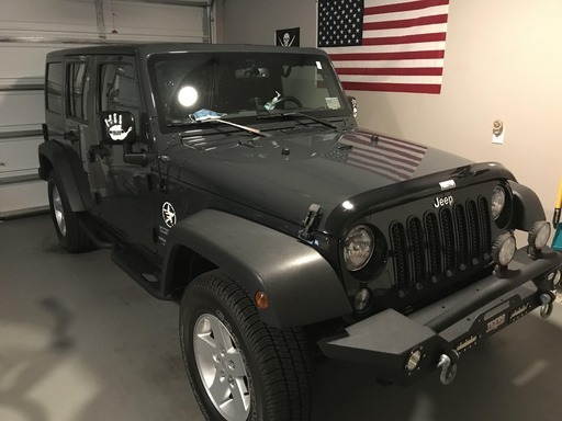

I purchased it new In Baton Rouge March 2017....Serviced it like a clock, all the maintenance up to date, all of it...!Soon as I got 50K on it, just as if there was an alarm on it, stuff started failing...!One after the other. I purchased an good extended warranty package when i got it...Thank God...! It's already paid for itself...Engine is 3.6L...Yes, it is a dealership here in Pensacola, FL...
I have a FIXD device which tells me what a problem is when the engine light comes on...I just replaced a downstream 02 sensor last Monday using that device...
We've been very pleased with it so far, oil cooler was the first issue...Jeep is still like new, stays in the garage, clean...! No kids no pets, no smoking...I'm retired
Rodney
Given the nature of these 3.6 engines and the oil cooler leaking, I wouldn't hesitate to say you might be experiencing a leak from the oil cooler again. Trust me, it's possible.

Have you checked any of the valve cover bolts to see if they might be loose? Also a repair shop that says you have to live with a oil or any kind of leak is no real repair shop.

I will monitor these issues. I picked it up from the dealer yesterday afternoon, after they replaced the gasket...I'm not sure if there is a torque value on those. I'll do some digging to see...I drove it home yesterday and crawled under it and inspected it. Looked good. so far. There is a Chilton Manual web site, where I can rent the Jeep Maintenance manual for $29.00 a year. I may do this...

More then likely there is a torque value on every single bolt and nut on those engines. Most of the gaskets will fail if they are over torqued.
