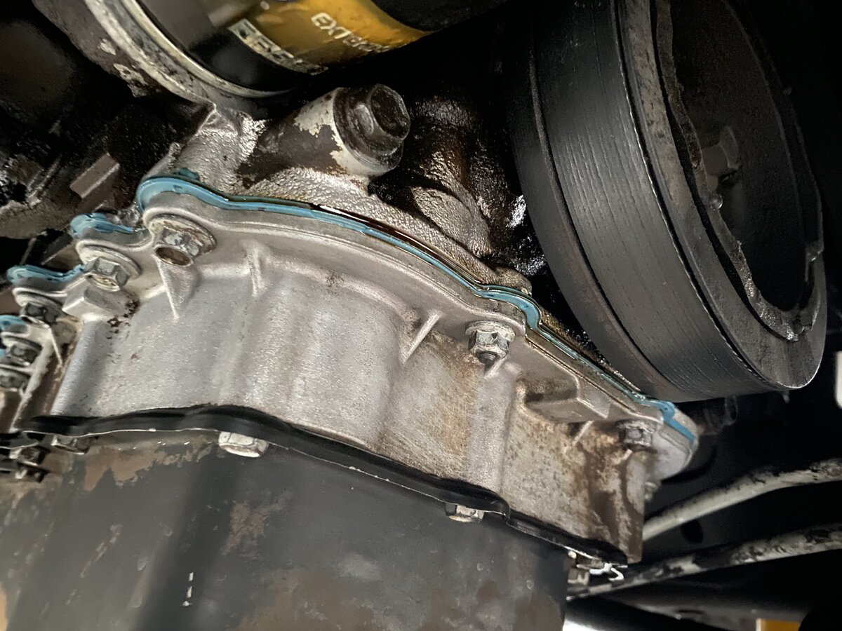

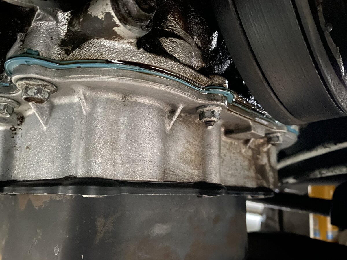

Venepaisano New Member Joined Jun 21, 2021 Messages 23 Location Oak harbor WA Aug 5, 2021 #1 Just wanted to confirm that I’m looking at an upper oil pan gasket leak. I bought everything to repair it this upcoming weekend.
BLACKJKU Moderator Staff Member Lifetime Supporting Member Joined Feb 22, 2020 Messages 5,356 Location Huntington In Aug 5, 2021 #2 Looks more like the front crank seal, might clean it up good with brake clean and let it run for a while and check under the seal area again. With the pan gasket sticking out like that it catches the oil. Reactions: mrjp and Lxxtsy
Venepaisano New Member Joined Jun 21, 2021 Messages 23 Location Oak harbor WA Aug 5, 2021 #3 Clean above the upper oil pan?
BLACKJKU Moderator Staff Member Lifetime Supporting Member Joined Feb 22, 2020 Messages 5,356 Location Huntington In Aug 5, 2021 #4 Venepaisano said: Clean above the upper oil pan? Click to expand... Right under the crankshaft seal, it looks real oily there to me from the pictures. Shine a flashlight up behind the engine balancer and see what it looks like.
MacGuyver JK Addict Supporting Member Joined May 13, 2020 Messages 1,006 Location Wisconsin Aug 5, 2021 #5 That is a felpro gasket and is not stock, so it has been replaced before. I have one sitting and ready for my next oil change. I agree with others here, clean higher and check a few days later. Reactions: mrjp
