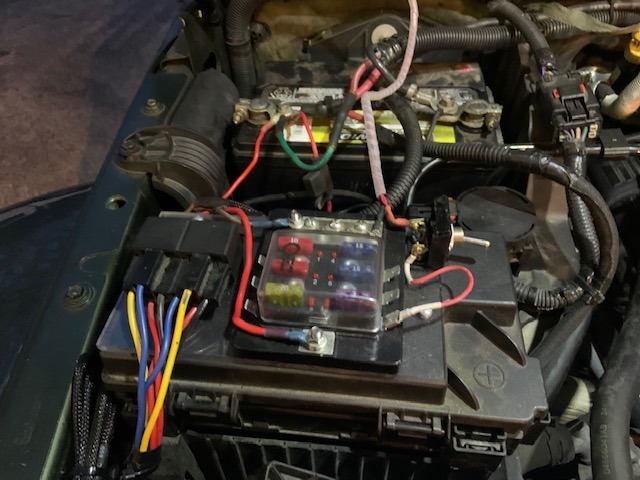

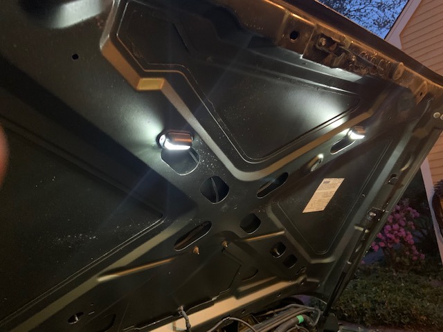

I installed these small LED lights from Amazon and rigged them up on a manual switch under the hood so that I can turn them on if I need to see better under the hood when it's dark out. Surprisingly bright.

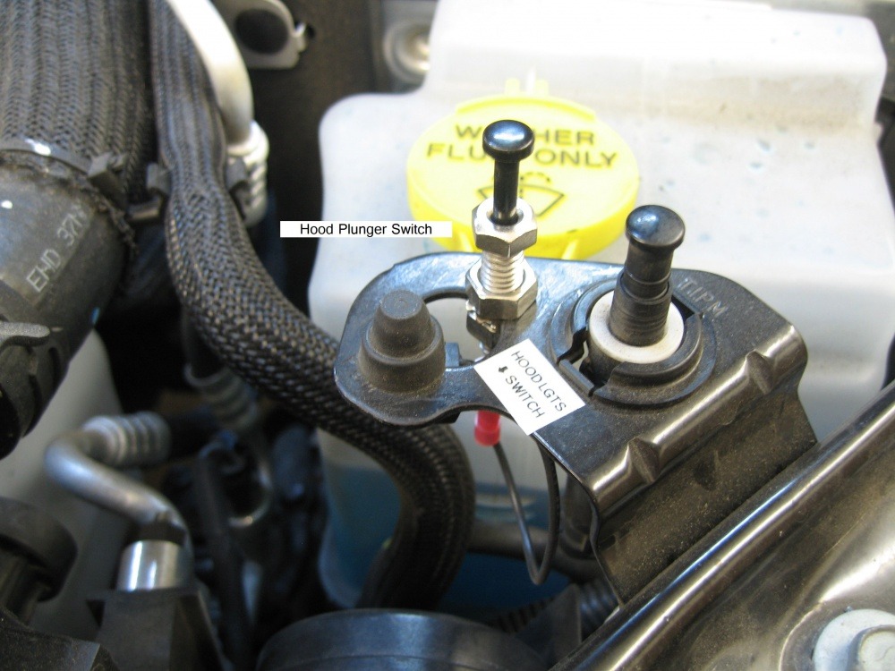

Nice. I would suggest adding something like this to the circuit. LED's draw very little, but if you forgot to shut off the lights and it sat for a week or so... ;)
I bought one of those, Jerry, but could not figure out how or where to put it in the Jeep where it would work best. I can always go back and add it if I find the right place.
