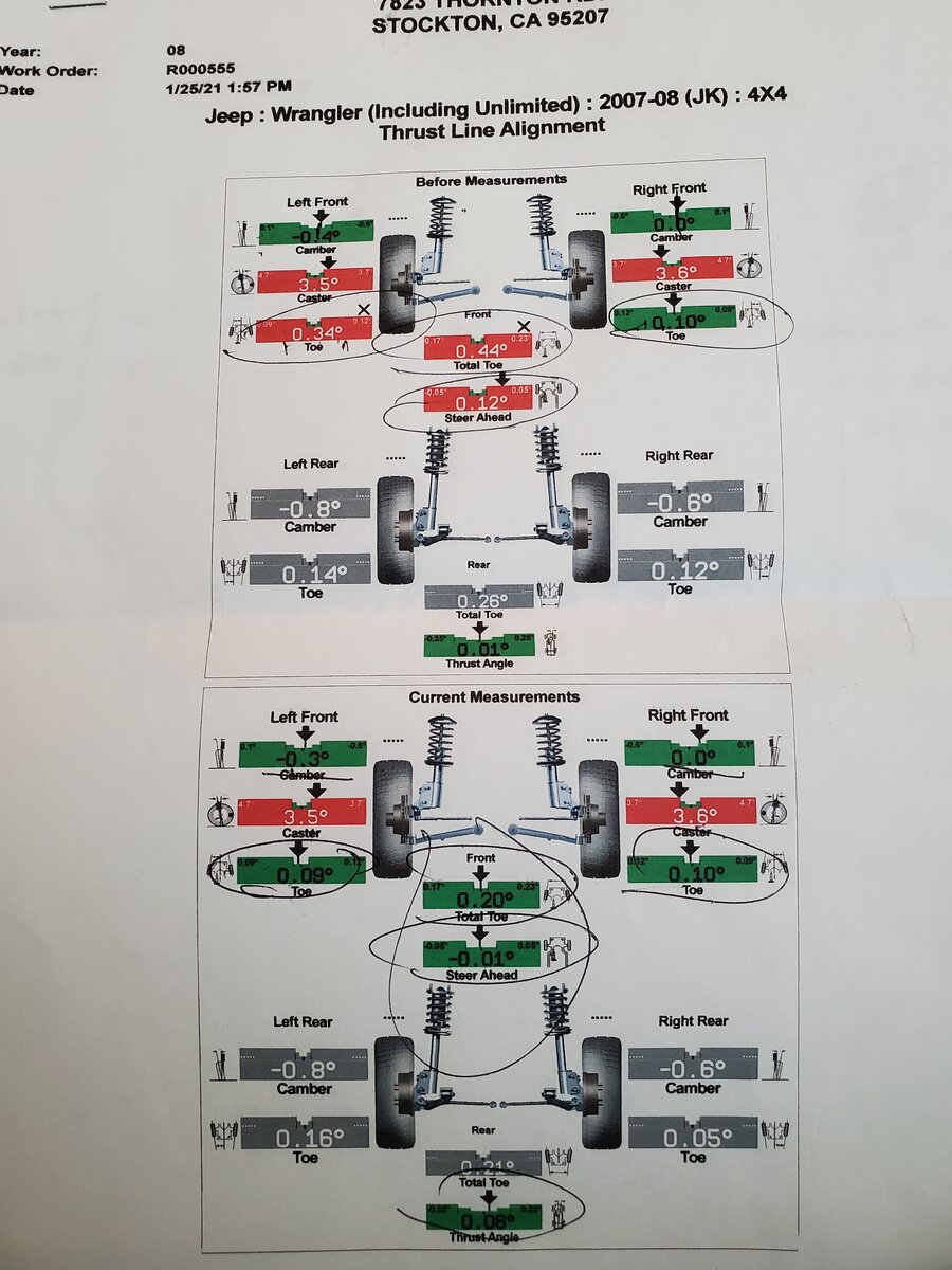

<blockquote data-quote="mrjp" data-source="post: 435796" data-attributes="member: 19765"><p>You need more caster. Do you have adjustable control arms or geometry correction brackets? If not you need some most car alignment shops won't adjust your caster you need a specialist type 4x4 off road shop</p></blockquote><p></p>
