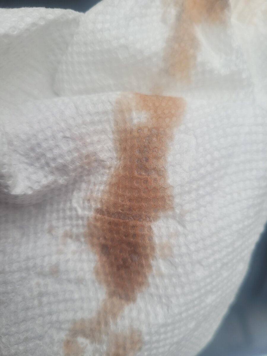

<blockquote data-quote="longlivenintendo" data-source="post: 457987" data-attributes="member: 24533"><p>Did my transmission fluid change this weekend finally!! Other than breaking a bolt on the skid plate (had to ask thr local mechanic to get that out for me. I would have died on that hill and he even broke the welded nut getting it out that's how bad it was. ) I changed the transfer case fluid too. Little corrosion on those 2 10mm hex screws which took a little convincing to get out. When removing the pan there wasn't any big curly metal bits just some fuzz on the magnet which I took as a positive sign. But if you're looking on content and advice look up this video [MEDIA=youtube]eN0Acz46jXY[/MEDIA]</p><p></p><p>ESPECIALLY the part about jacking up the transfer case to get at the back 3 bolts with the exhaust pipe in the way. I used a long 10mm swivel socket and that did the trick jacking up that section an inch or so. I used lube locker gasket which so far seems to be working great</p><p></p><p>[ATTACH=full]124285[/ATTACH]</p><p></p><p>[ATTACH=full]124287[/ATTACH]</p><p></p><p>[ATTACH=full]124288[/ATTACH]</p></blockquote><p></p>
