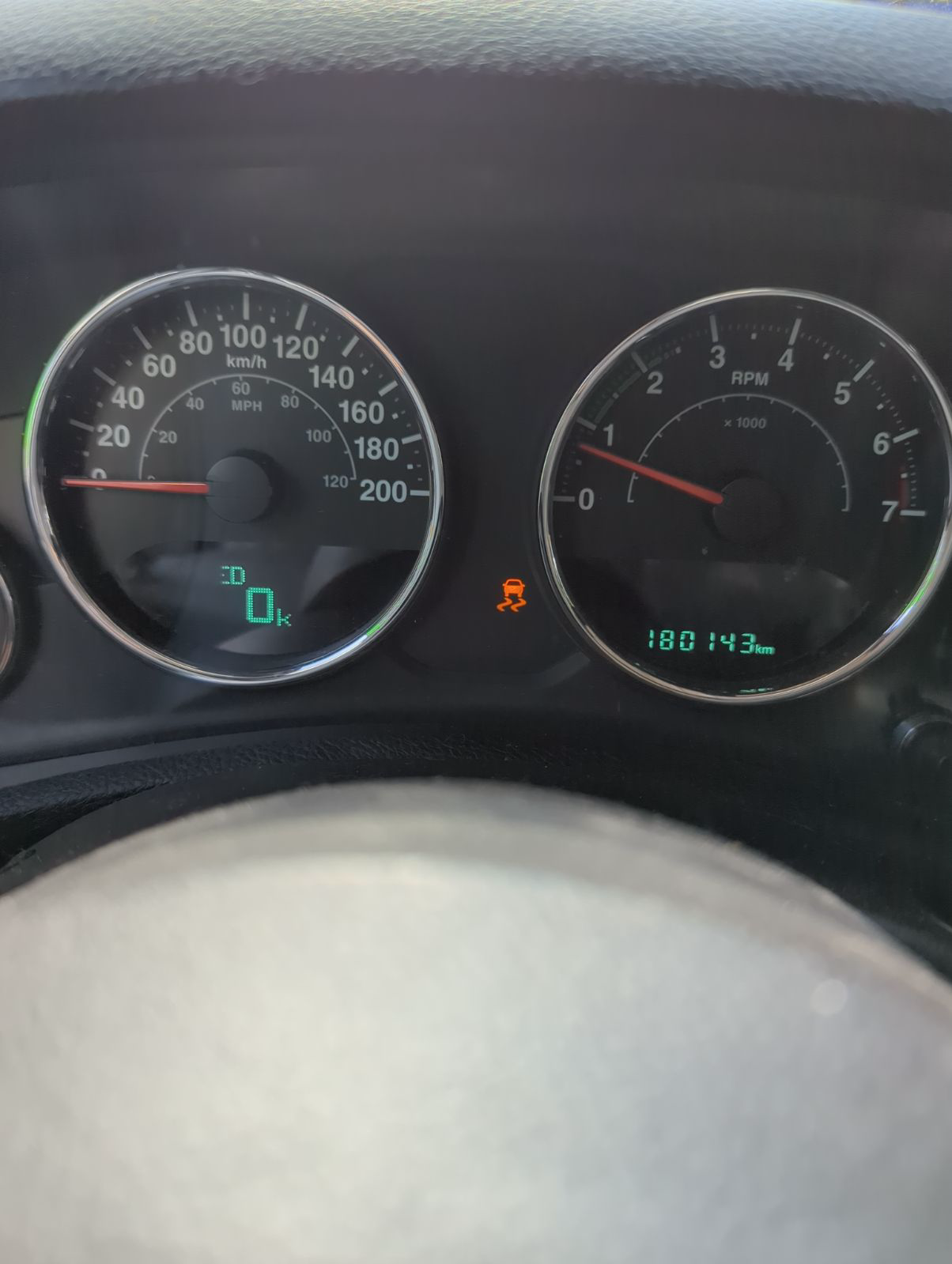

Good day people hope all is well. Im having a issue with my Traction Control Light periodically coming on, after getting a report from the garage they told me they retrieved two codes C1252 and D258B. returning home I then replaced the Vacuum pump, the Solenoid, the Gas cap even the wheel speed sensors. as time went on the issue came back. went back to garage had a diagnostic done and now was told " Vacuum Pump Control Circuit has no Ground to Vacuum Pump -- Need to trace wiring. they told me it could take five minutes or few hours to find ...... at $125. hour........ need some advice on what I should do?

Replace the battery clamps. ;)
I know that sounds snarky, but a poor ground at the battery will cause a ton of CEL codes and misbehaviors that will make you look at other systems as the root cause.
The factory clamps are 100% SHIT.
