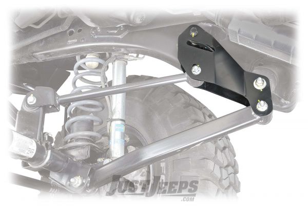

<blockquote data-quote="Vman" data-source="post: 445117" data-attributes="member: 22091"><p>Yes. Once you go over about 2.5-3" of lift you're going to have major issues that require a lot of parts.</p><p></p><p>At 4" of lift you're going to need to replace driveshafts, get adjustable control arms all around, adjustable trackbars front and rear, flip the draglink to maintain a parallel line with the trackbar, proper length swaybar links, increased bump stop, exhaust spacers depending on year, and probably several other things I'm missing off the top of my head.</p><p></p><p>The cheapest way to resolve the issue is to lose the spacers and stick with the 2.5" of lift. If it's a tire clearance issue you could trim the fenders or install flat fenders/play with tire offset/spacing.</p><p></p><p>The other option you could go with are drop brackets that restore your control arms to a more parallel to the ground situation. Of course that has pros and cons like reduced ground clearance for rock crawling if that's a consideration.</p><p></p><p>[ATTACH=full]120556[/ATTACH]</p></blockquote><p></p>
