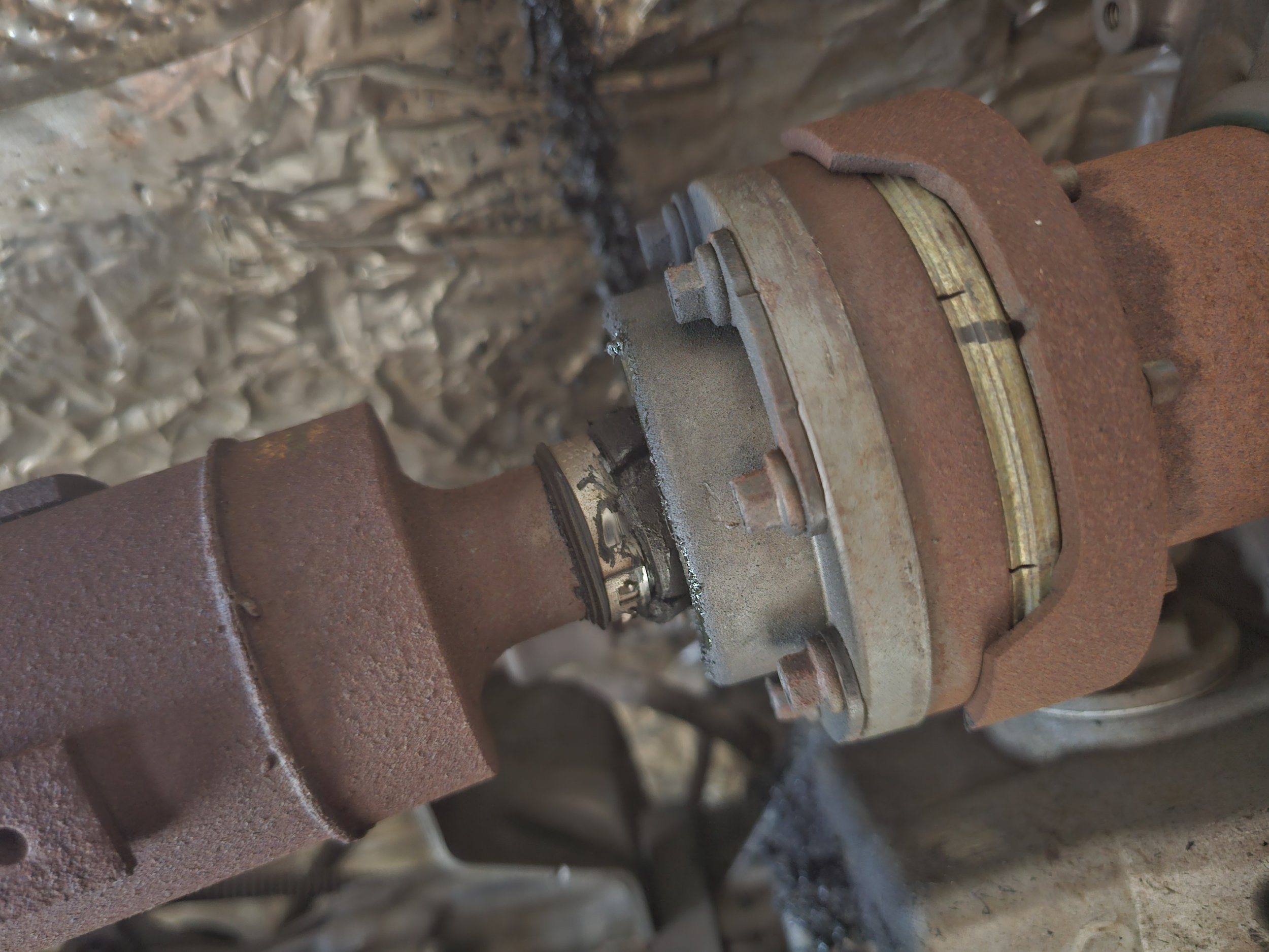

Noticed this. Rubber seal cracked. Front of the Jeep is to the left. First time taking the skid plate off so I am not sure how long this has been going on.
Other info - Had transmission lines replaced and transmission serviced by my mechanic due to a leak in the lines 3 months ago.
Drives fine, nothing at all noticeable.
I'm very new to working on my Jeep, hoping for any/all help. Road trip coming up soon.
Thanks all
2012 JK 2-door Sport, 103xxx miles, automatic transmission
Does your Jeep have a lift?
You can buy a rebuild kit for that, I bought one on Amazon a few years ago. It's not to bad of a job, but if your Jeep has a lift then you might need a new driveshaft.

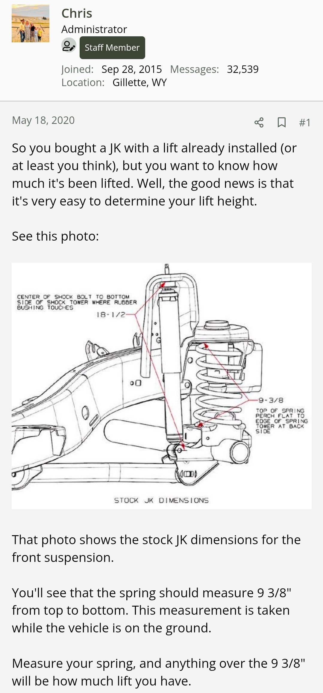

Thanks for the reply :) bought it used and based on using these instructions found on another post (thank you Chris) it does not appear to have a lift. It was quite the task to take that picture lol
Reactions: Cimmerian
When I bought my JK, it already had a lift but wasn’t installed properly. I’ve been fixing the issues and my joint had the same torn boot issue. I went with a whole new front driveshaft with a double cardam joint. Working great so far.
I wonder how much of a driveshaft angle these high angle Rzeppa joints can handle. Definitely cheaper than a whole driveshaft. The thinner replacement driveshaft does help with exhaust clearance.
Also, you DO have a spacer lift on your Jeep.
Reactions: Bombastic

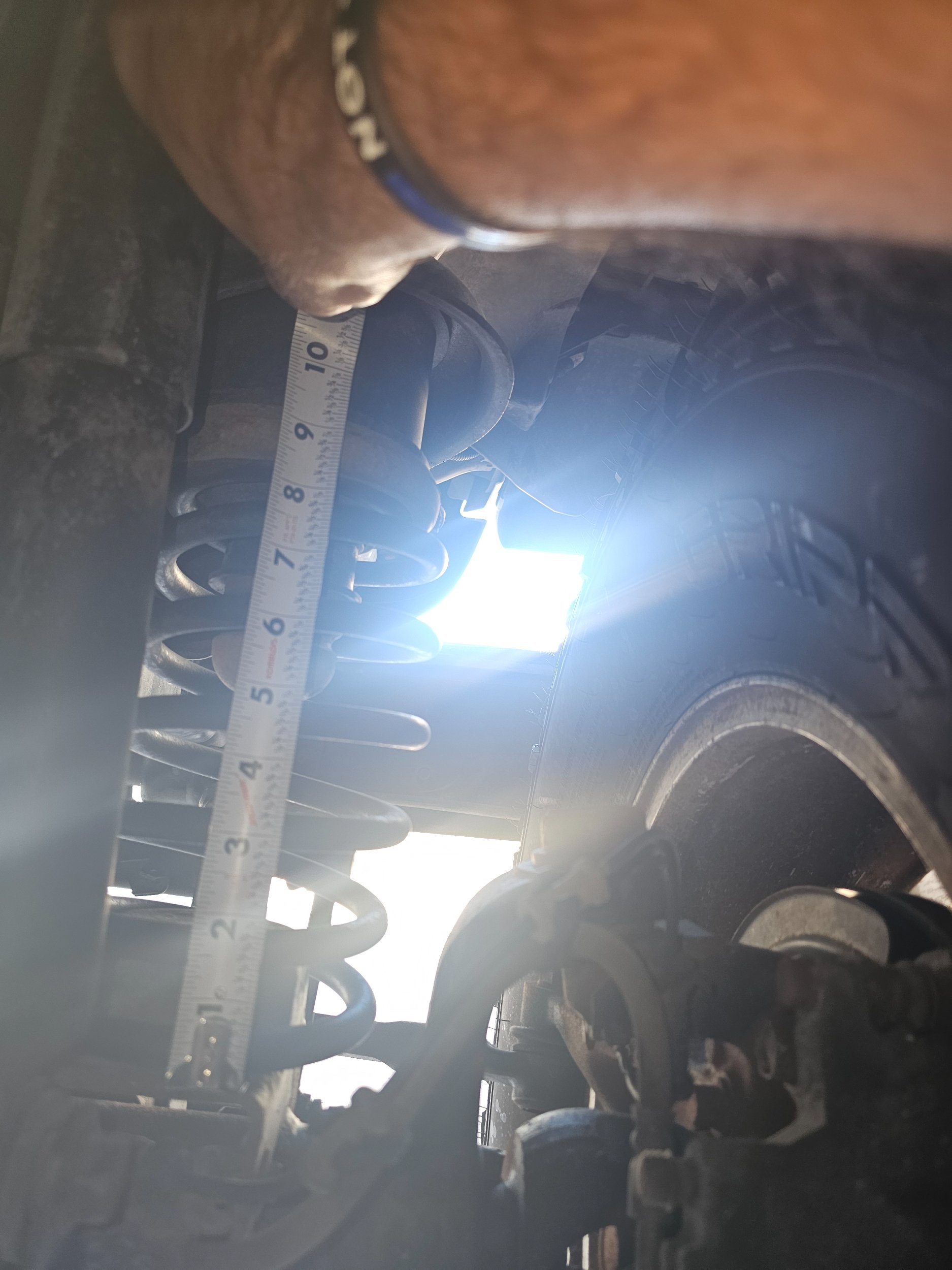

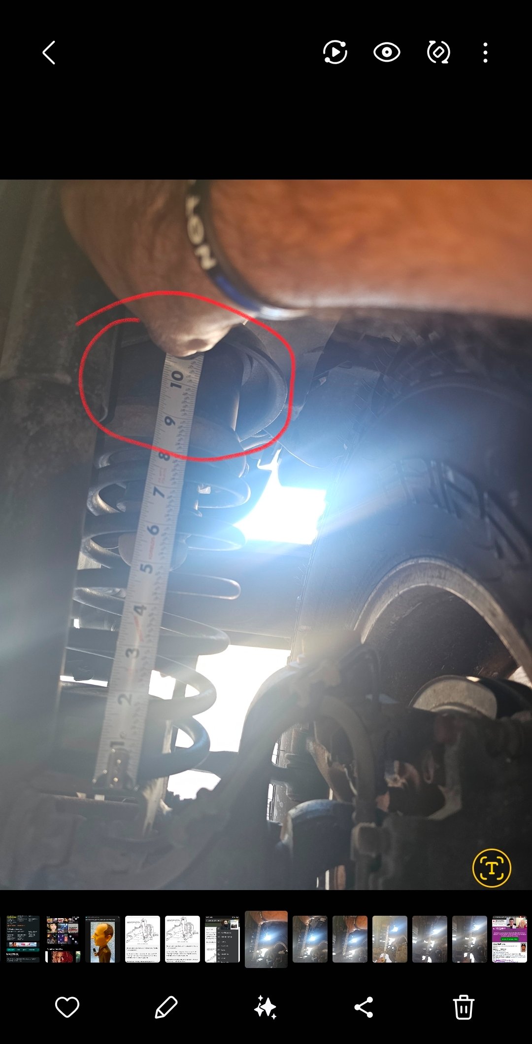

Is this the spacer lift you are talking about? Guessing I would measure this to work on narrowing down exactly what type/kind it is. I swear I learn something new every day on here lol.
Reactions: Mopar
Yep that’s the spacer lift. Nothing wrong with a spacer lift. Gives you a smaller lift at lower cost. The negative to spacer lifts is they often lack the other parts to make a proper lift.
Unless there is something wrong with it, you don’t need to replace the rear drive shaft with a lift. You DO need to replace the front driveshaft….or at least a high angle Rzeppa joint.
I’m gonna guess you have a 2.5 inch spacer lift.
