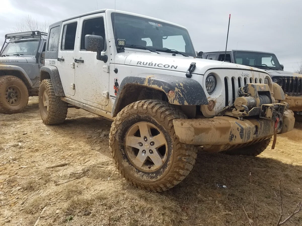

<blockquote data-quote="Daddyo2373" data-source="post: 437617" data-attributes="member: 17754"><p>We have a 2010 Rubicon and are running 315/70 on stock 17 rims. Had to use spacers but has been this way for several years with no issues. I wouldn't go any bigger than 35 though.</p><p>Could it use a regear......yes it would help but it does pretty good as it is. Not a need at the moment.</p><p></p><p>[ATTACH=full]118754[/ATTACH]</p></blockquote><p></p>
