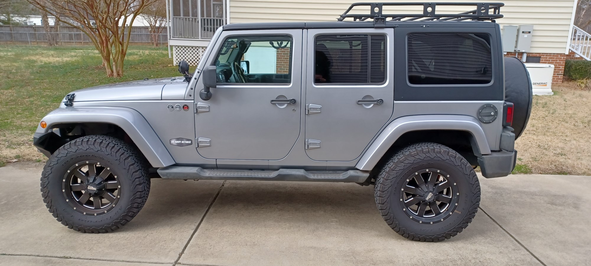

Have you measured that lift? It sure doesn't look like 4". Here's mine at 2.5" with 35s:
Anyway, I had 35" Toyo MTs on mine when I bought it and couldn't wait for them to wear. They were loud and not a good ride on pavement, regardless how much I aired them down. Replaced them with BFG TA KO2 (AT) and feel like it was a very good decision. Wear is good, road noise much better and I'm pretty strict about rotating them every 5k when I change the oil

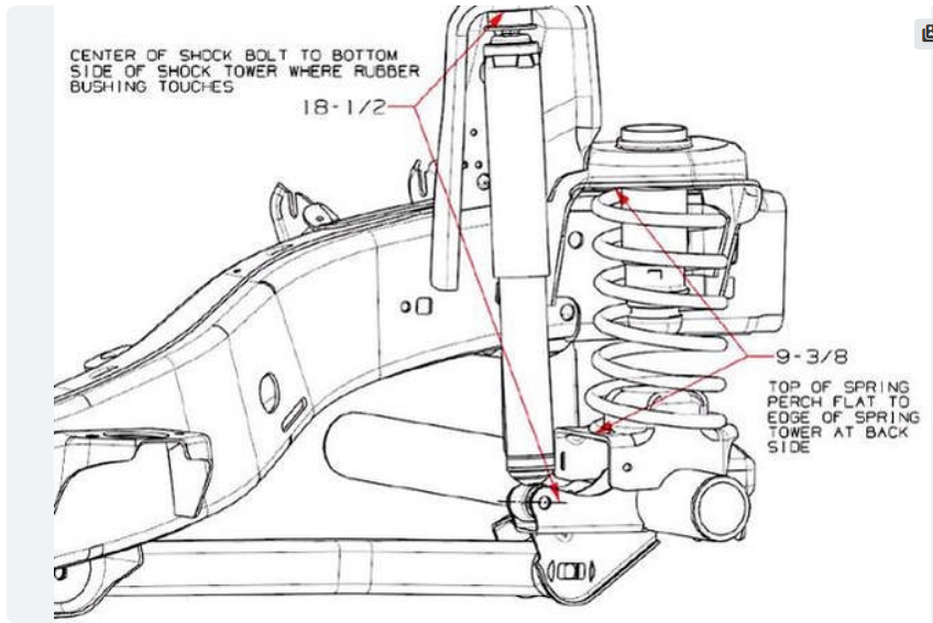

Here you go. One of the reasons you need to know the true lift is for repair/maintenance issues. A 4" lift would have required adjustable control arms, new drive shafts and a handful of other replacement parts because the geometry of the drive train has been altered significantly. If you were to do something as simple as replace the shocks, for example, there are differing lengths depending on the lift. And putting a standard length shock on a 4" lift, or, converesely, putting a 4" shock on a standard lift will have major consequences either way. So, it is pretty important to know exactly what your lift is.
This diagram is for a JK. The diagram shows what the stock dimensions are for a JK.

These measurements are trickier than it looks. On my Rubicon (Hard Rock) I have an 1 5/8 inch lift if I measure the spring, and a 2.5 inch lift measuring the shocks. The sway bar links are 8.5 inches long center to center. The previous owner had extensive Teraflex customization of the suspension and steering done. I usually just say I have a two-inch lift.
