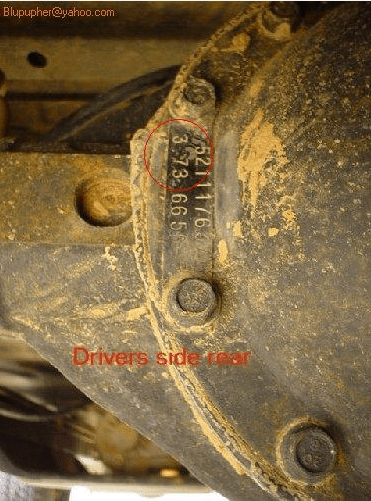

Crawl up underneath your Sahara and look on the rear differential for a tag that will have a few numbers on it (remember this, Chris?):
If I'm not mistaken, most Saharas from this time frame have 3.73 factory gearing.
Or, enter your VIN on this site and you can download a complete build sheet for your JK:
https://www.nathanson.org/davesays/2019/buildsheet-for-jeeps-vin/
