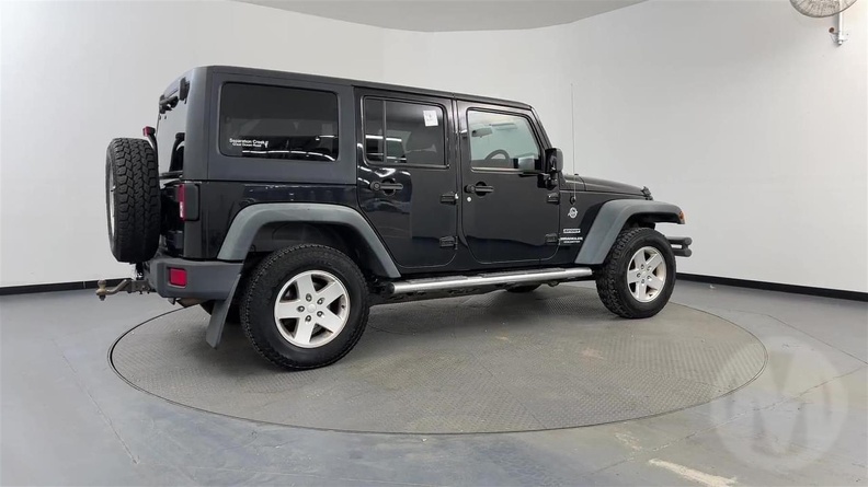

Figured I may as well post up a build [or rather, repair] thread on here as given how well this has gone so far, I have a feeling im going to be posting on here a lot 😂 So bit of a back story - I got made redundant from my job early in 2025 and as part of that fun process I had to hand my company car back [Nissan Navara D40]. Needed a car ASAP so bought this from the auction yards site unseen for a price way too good to be true.
Pros - It was a JKU for under 8500 AUD, which is ridiculously cheap. Its manual, its black, Hardtop freedom roof, upgraded sound, and its a facelift so better dash. Body is actually in good condition.

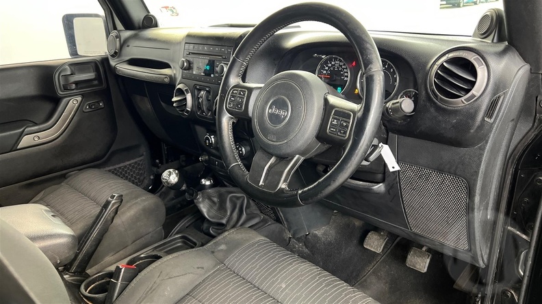

Cons - it was advertised as a 2.8CRD, turns out it was actually a Pentastar 3.6. It came with the dash board full of warning lights, it jumps out of first gear, and the interior was f***ing disgusting on levels I have never seen before.

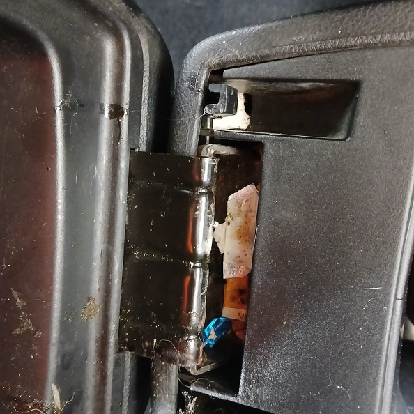

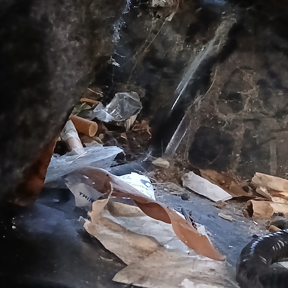

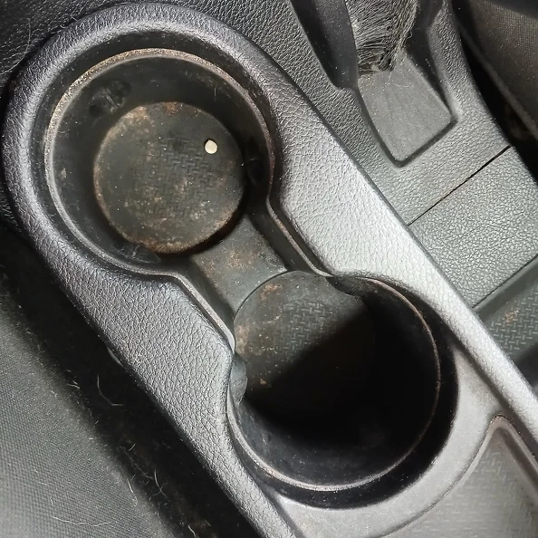

This was under the seat.

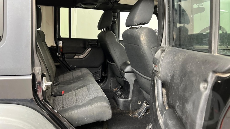

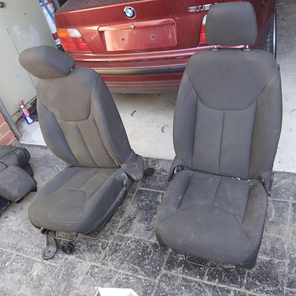

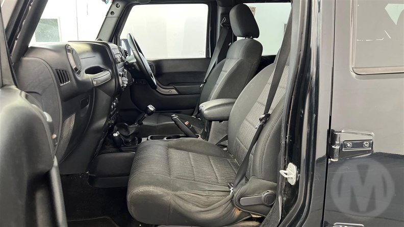

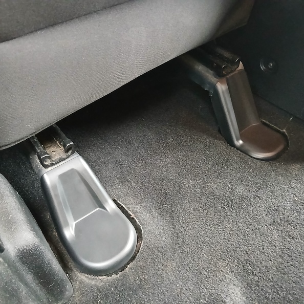

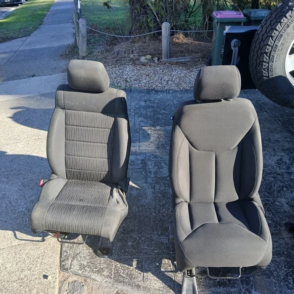

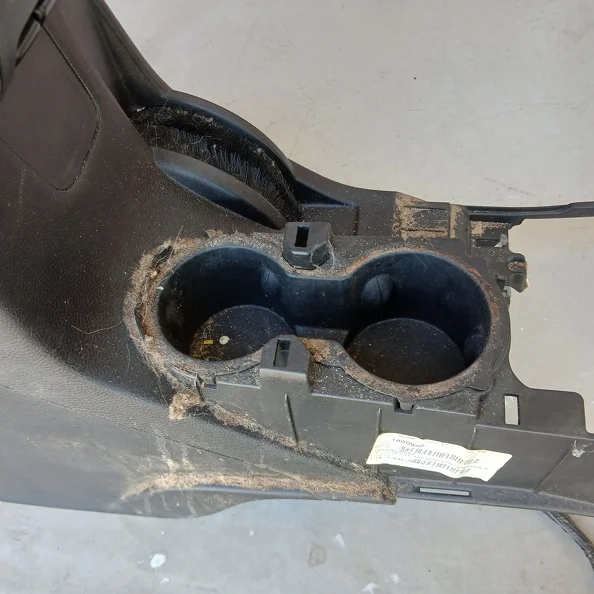

Best as I can track its history, it was sold new to a Furniture Company and was the owners sons personal car. During that period of time it was well cared for and serviced according to the log book before it was sold onto private ownership. It was sold to a woman who is best described as a hipster who later moved beachside. Servicing was optional as was actually cleaning the car or using an ashtray, and it appears to have been used to carry a wet paddleboard and a wet dog simultaneously and regularly. Tried cleaning up the interior with the wet vac but quickly gave up and removed them along with the console and anything plastic. All plastic parts were cleaned with a paint brush, heavy duty detergent and hot water, carpets were vacuumed and wet vacd heavily [and still theres sand coming out]. Bought a set of front and rear seats from a 2014 JKU from a local wrecking yard and gave them a good clean [and stupidly didnt take any photos of them in the car once done]

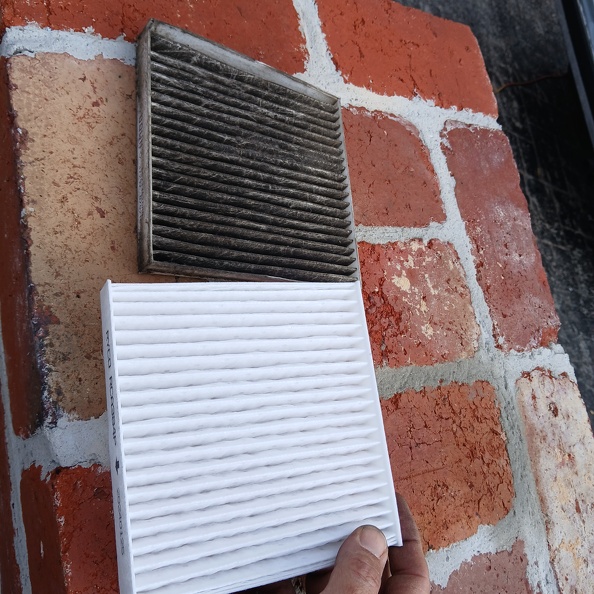

If you really want to feel sick, this was the state of the cabin filter.

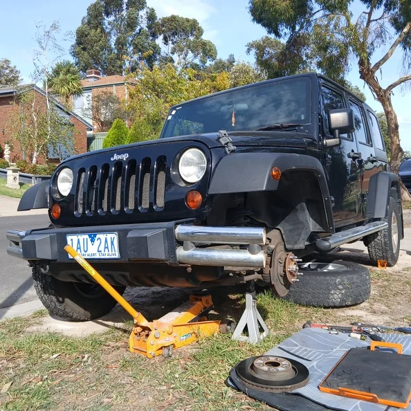

New rear struts

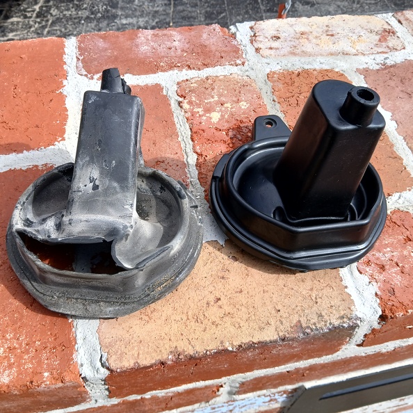

Replaced the gear boot to try and cure the jumping out of first. It helped, but still does it so I ordered the dorman shift quadrant.

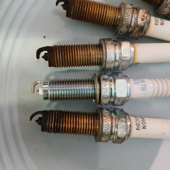

It had a dead LHR speed sensor when I bought it, but because I dont do halves, it got all 4, plus Brembo ceramic brake pads at the same time, as well as engine oil and filter, spark plugs and a new o2 sensor in an attempt to cure the P0300 code and B2S1 code it kept throwing

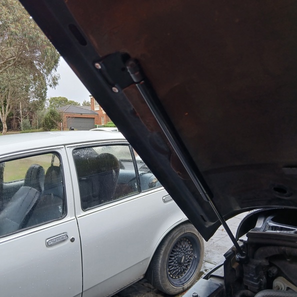

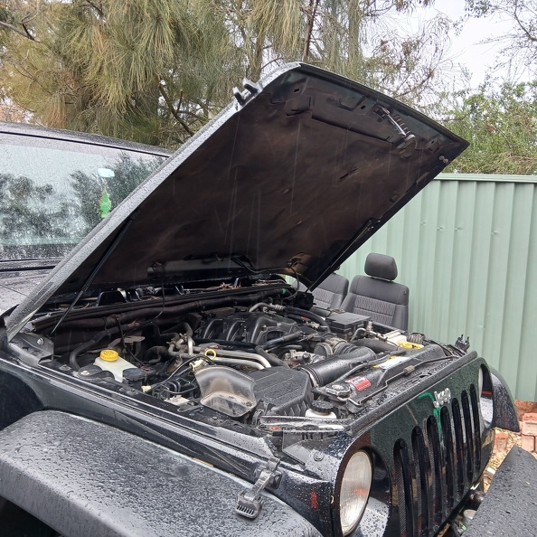

Threw some bonnet struts on while I was at it

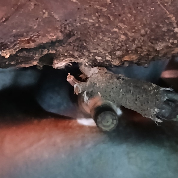

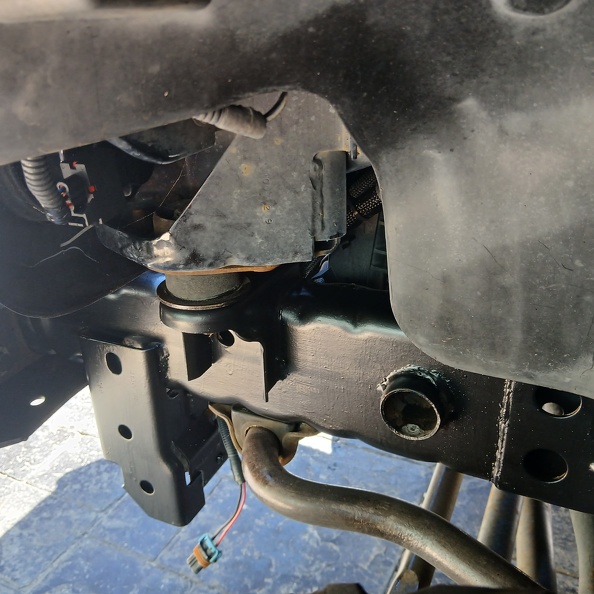

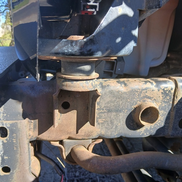

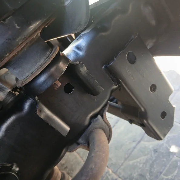

Being a coastal car, the chassis looked a bit tatty. Surface rust not gaping holes fortunately, like you snow belt guys are used to dealing with. But either way, looked ugly, and im fussy
Scuffed back, and painted in Brunox which is a rusty convertor and epoxy primer in one
Then top coated in GMH Chassis Black

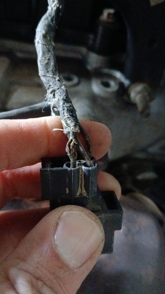

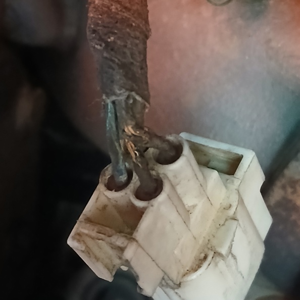

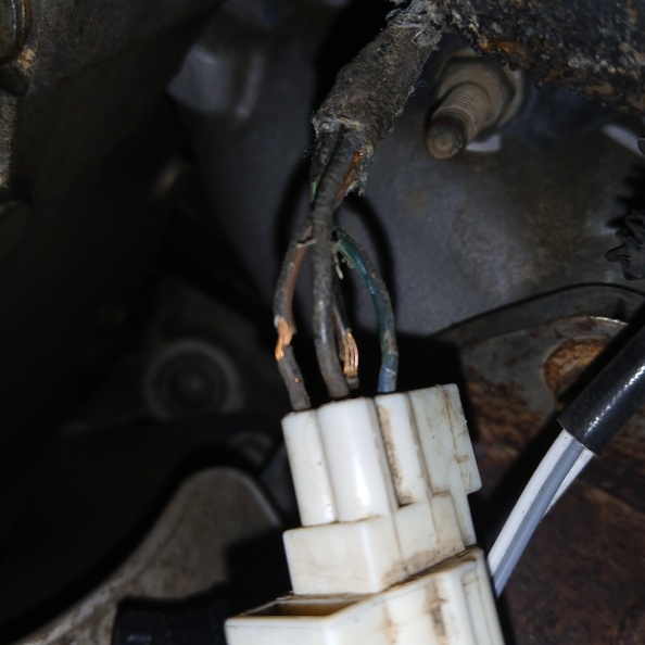

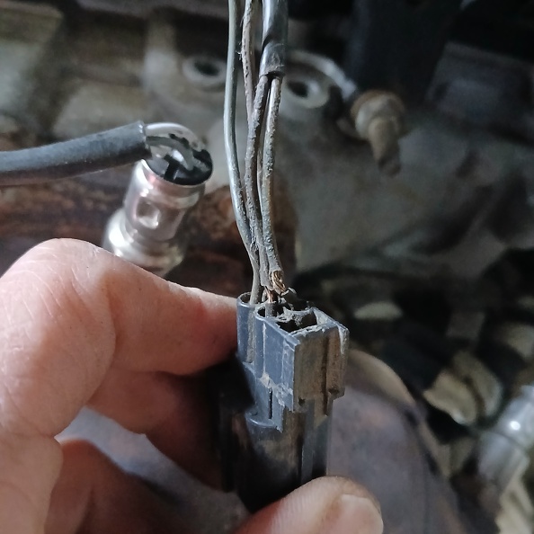

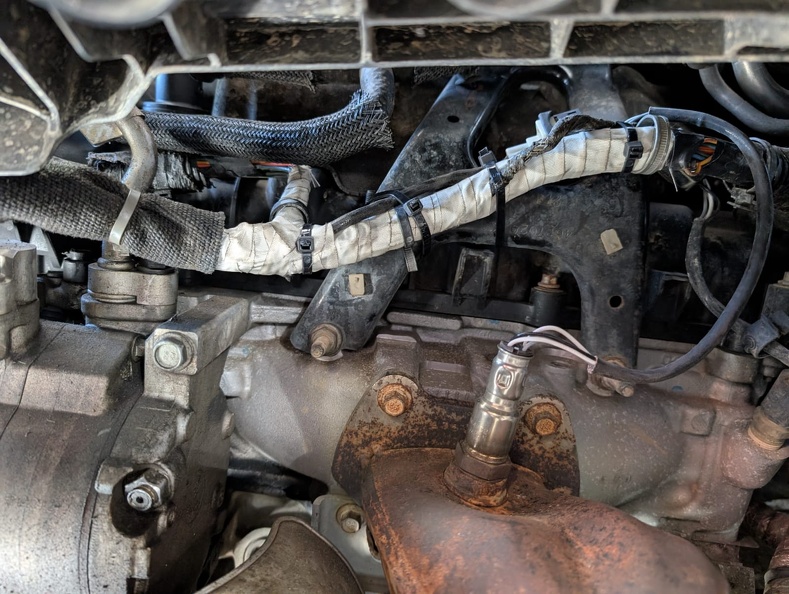

Managed to get it on the road, drove it for a week, and then the MIL came on and ive been fighting the f*cker ever since. P0300 and code for B2S1 sensor which id already replaced. Turns out it was the harness..

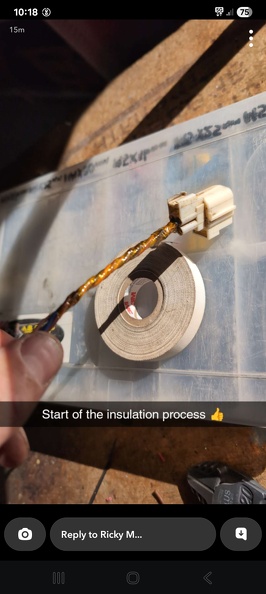

So I got ricky to fix that up
And it came back again and Ive fought it ever since. Parked it up for a while because I managed to get a short term contract that included a company car, but come end of year the end of contract, and my life imploding, means I desperately need this thing to run so I have a car for my kids. And so far its refused.

-Replaced 6x coil packs with Genuine NGK including using correct spark plugs

Steve, and I given what ive found in the harness so far, are adament the issue is electrical. So harness is getting checked next week. Failing that, its PCM...

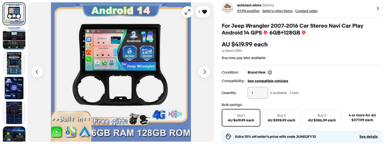

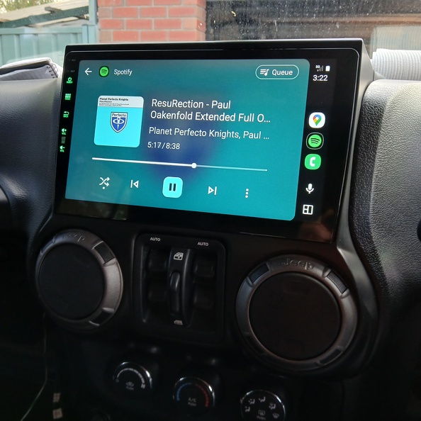

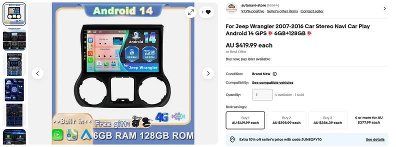

Stereo sounded spectacularly bad. Ebay to the rescue
Difference in sound quality was mind blowing, let alone Android auto, nav etc. Need to finish the reverse camera installation but other than that its perfect.

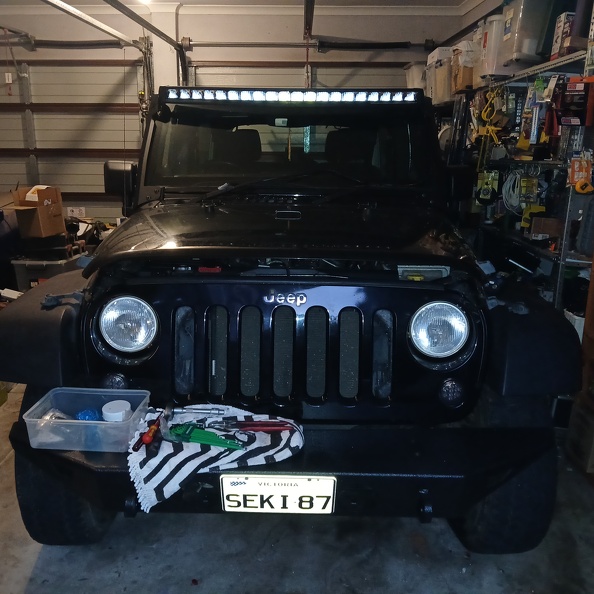

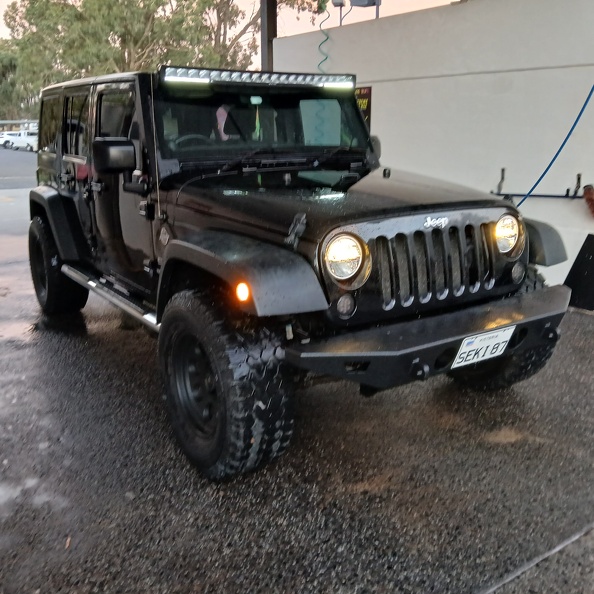

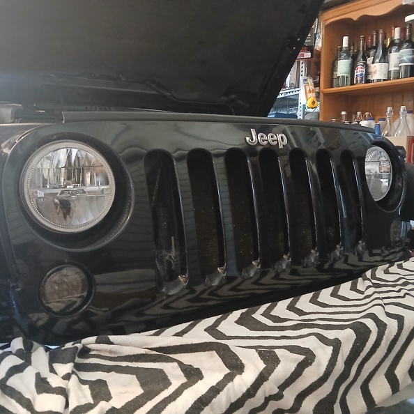

Lighting upgrades. STEDI Hommage 7" headlights and 52" Curved light bar. All are ADR approved, and not cheap but you get what you pay for. Lightbar has 1lux @ 1100m.... thats 3/4 of a mile for you guys in the US.

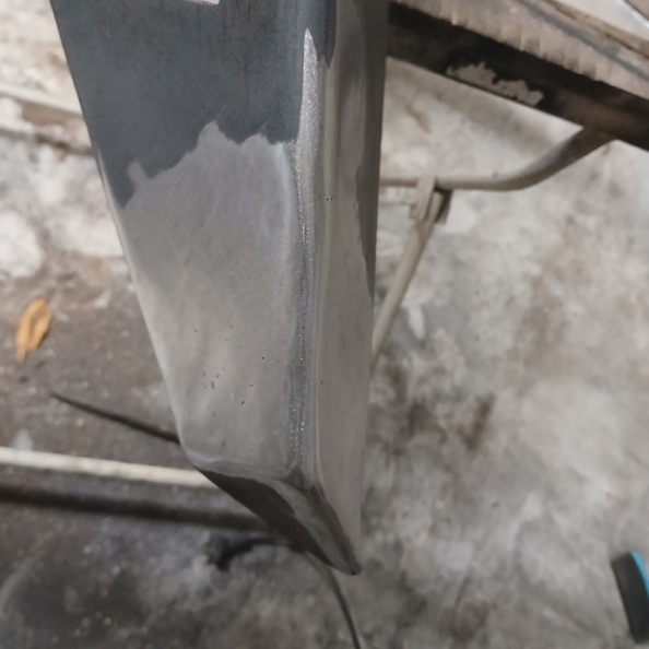

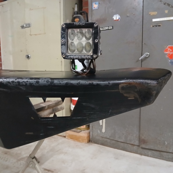

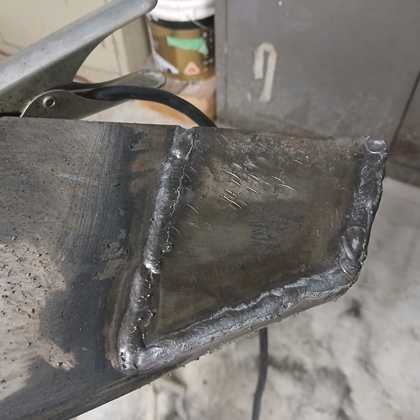

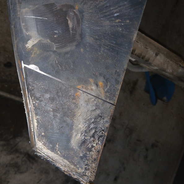

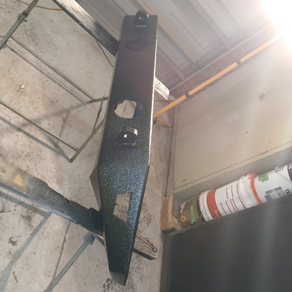

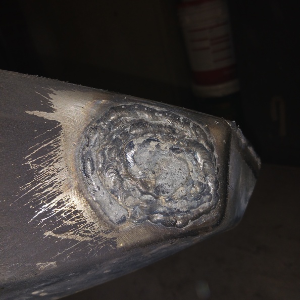

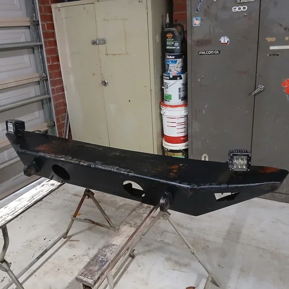

Bought a damaged WARN winch bar for $50
Melted a heap of mig wire into the giant dent
Scored the top with the grinder and bashed it down with a mash hammer
Welded up
Ground back
Hit with RaptorLiner
And all assembled.

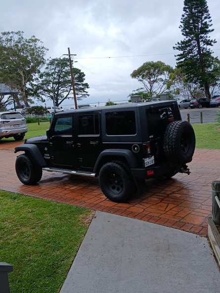

To come aside from the required repairs - need to fit the shift quadrant and the AEV 2.5" Bilstein lift kit I got for it. Unfortunately having to vacate my house every 2nd week means im forced to use the limited tools at my parents house rather than the fully equipped garage I have, but thats another story. As far as the title goes; my daughter named the JKU Jessie the Jeep - my older two kids absolutely love it [my youngest is too young to really get it]. However, given the torture its put me through [bit like their mother actually...], The Black Dahlia would have been more fitting. Hence Crna Utra - Serbian for Black Tomorrow.

Its a 2012, which puts it right smack bang in the range of engines that ate cam lobes and had issues with head hardness. You are correct, we are yet to leak down test it and we havent gone down this route yet because the issue appears to be electrical. Reasons being there have been periods of time where it has just miraculously come good and driven fine with no issue for a week, then it just randomly rears its head. Mechanical problems dont just disappear, coupled with a few other things weve found its pointing us towards either the harness or PCM being an issue. Since ive bought it, it has had persistent issues with the B2S1 o2 sensor; its had multiple issues in the harness there with shorts, no continuity etc hence the focus of our attention there.
The B2S1 sensor will not read over .2v; the sensor is new, genuine and known to be functioning. The PCM is reporting a LEAN running condition, and is visibly putting 33% more fuel on bank 2 in order to counteract it. Can confirm it is actually running RICH despite the ECU screaming lean as there is visible smoke from the exhaust and the spark plugs when checked were covered in soot. B2S2 reads correctly; its wildly fluctuating trying to keep up with whats going on.
My feelings are the harness is...well...f*cked, and the PCM has probably also had it. I know the PCMs tend to fail in the connector to board join but really dont want to stump up the 1300ish AUD for a reman if the only issue is the harness. Does anyone know where I can find the terminal pins for the C1/C2 connectors? Was going to order the harness repair kit but the cost is eye watering - $650AUD PLUS FREIGHT is cheeky for a bit of plastic and some short lengths of wire with a terminal pre crimped!
