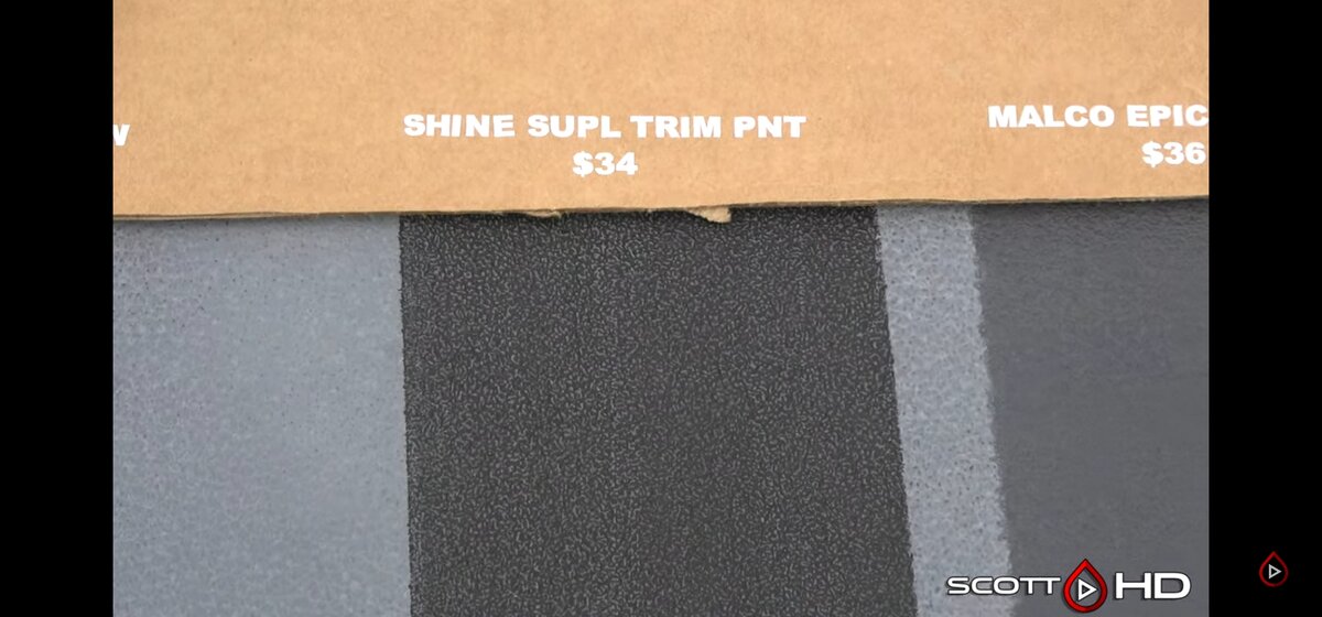

He chooses his winners. But to me the very clear winner was Shine Supply Trim Paint. (This product is a dye. And not paint. And the only long lasting one that will wipe off of your paint or glass once dried.)
You be the judge. This is the product after 1.5 yrs in the Texas sun and rain. And being washed weekly:
(He does two tests. One on a grey truck bed panel and one on a black truck bed panel. Ignore the grey panel. It doesn't apply to us. And grey plastic trim is quite obviously impossible to dye.)
I mention "dye" because there are basically two different groups of trim restoration products. Dyes and what I call conditioners or dressings. Conditioners and dressings are Ammoral type treatments that turn to crap after a week or maybe a few months. Dye lasts for years.
You'll be surprised how each of these famous name brand products actually hold up to weather, sun and washing. Most are complete bullshit. A complete waste of money. But mostly a complete waste of time. Who wants to re-treat their trim every few weeks or even every few months?
Other types of restoration are tested as well. Like the heat gun method, kiwi shoe dye etc. All of these are bullshit too. They are splotchy at best. And don't last anywhere as long as dye. I have not seen one successful test of that kind.
And I'm frankly tired of watching demonstration videos that look great right after the process. Without any comparison to other products. Or how each of these fair weeks, months or years after the application. Those videos are a complete waste of time.
There are hundreds of trim restoration test videos on youtube. But none of them compare as many products against each other. Or do real world monthly updates out to a year and a half. As this guy did:

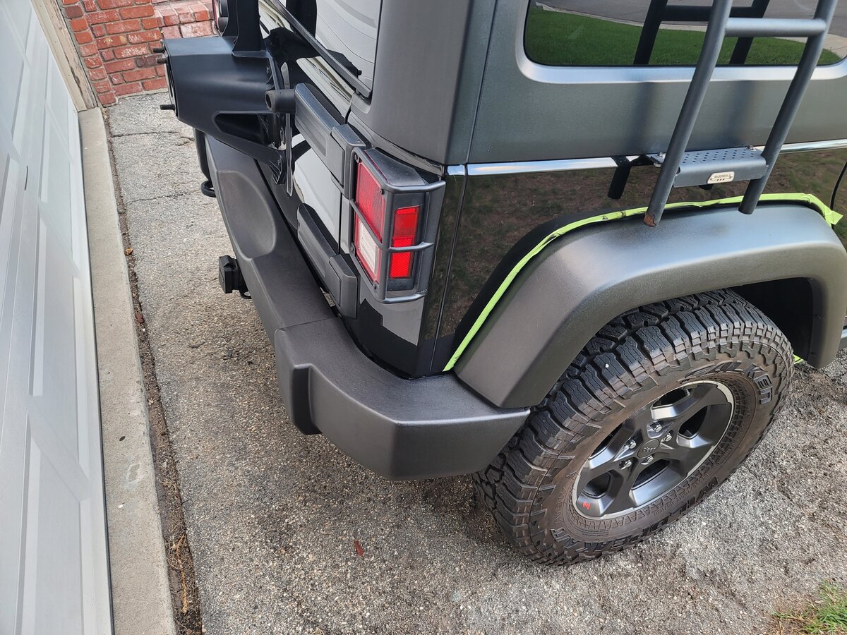

But tape everything off with green 3M automotive tape. (It's actually quick and easy. The bumpers don't need taping. Just the flares, door handles, side mirros or any other small trim.)
Use a dry or damp microfiber cloth to remove it from your paint. As soon as possible. I did let some dry for about 10-15 minutes. And it wiped off with a dry or slightly damp microfiber cloth. It also wiped off of my foglight lens a day or two after. With just a wet finger. THIS IS A HUGE ADVANTAGE. MOST OF THESE PRODUCTS ARE EXTREMELY HARD TO GET OFF PAINT ONCE DRIED.

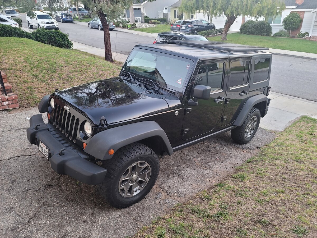

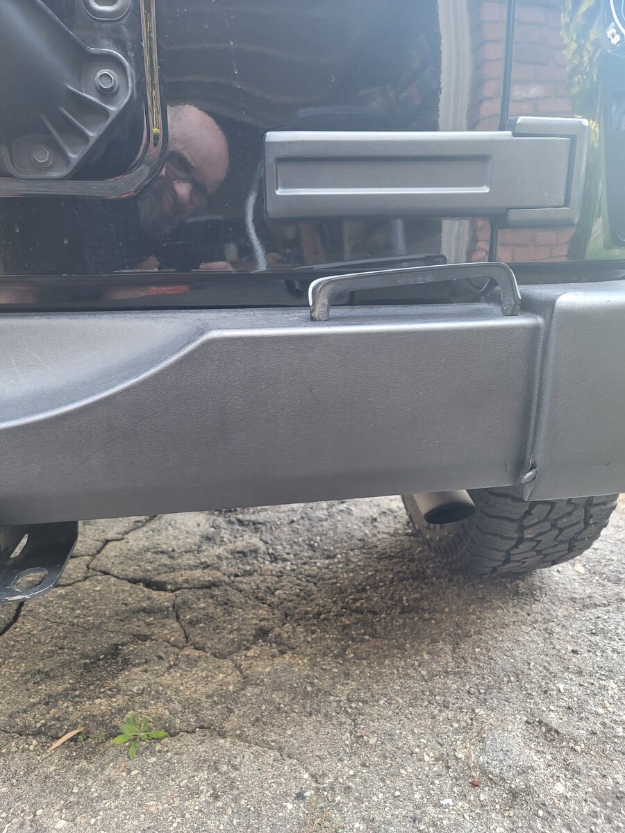

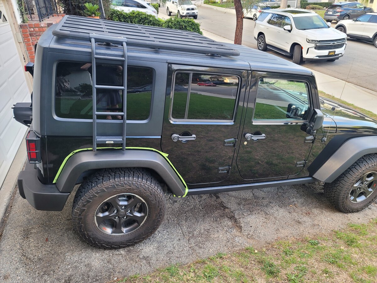

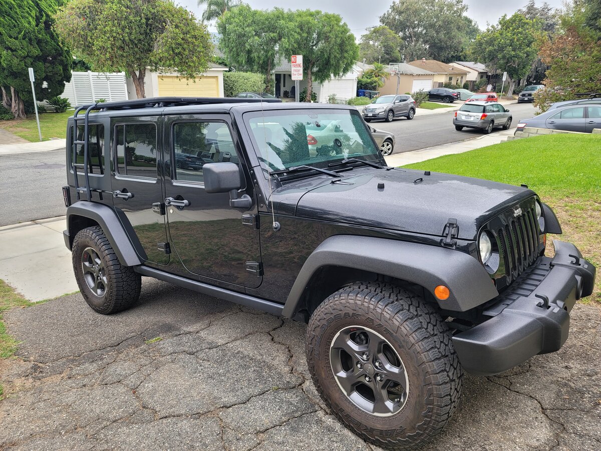

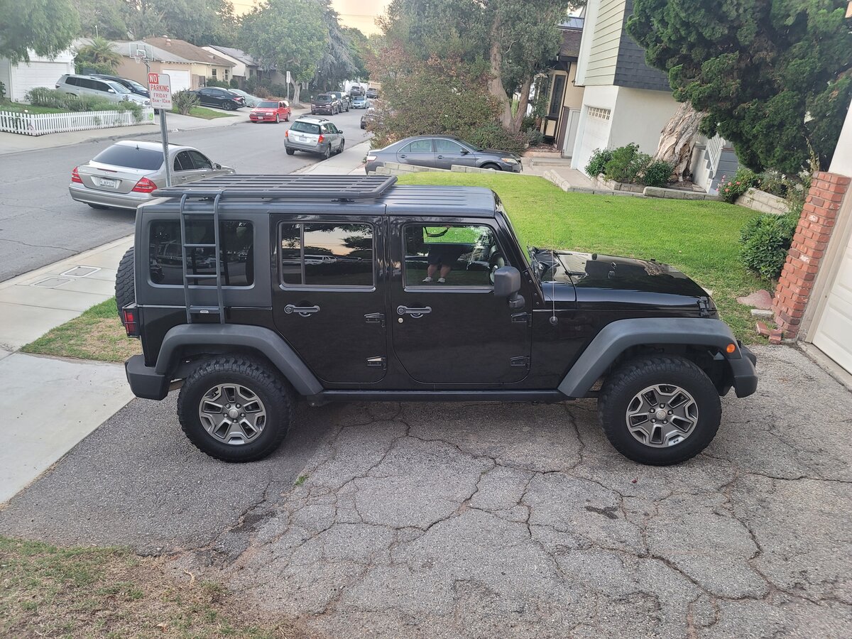

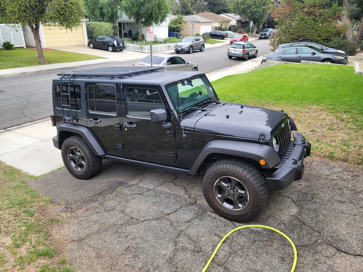

This is my Jeep before any treatment. The pic does not show it perfectly. But my fenders were closer to the color of the door handles. Which are trashed from sun.

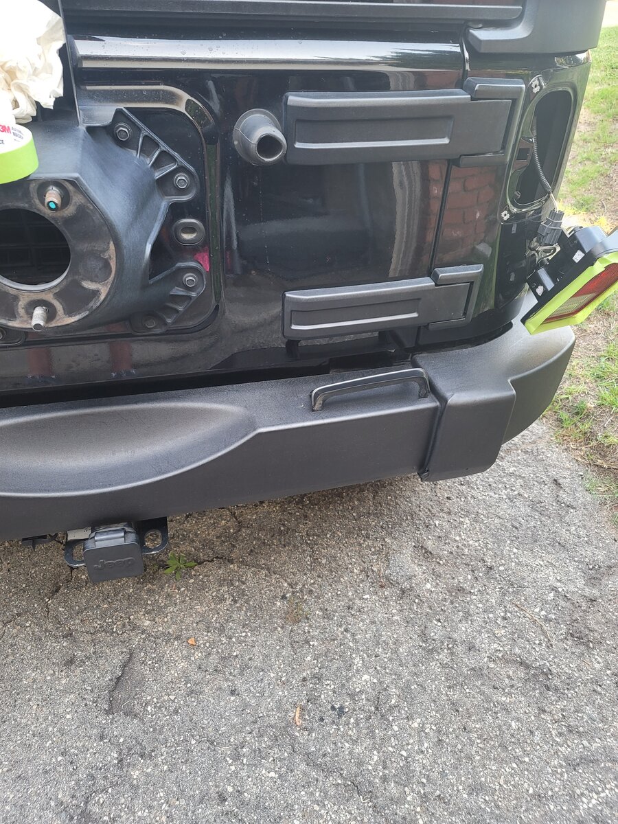

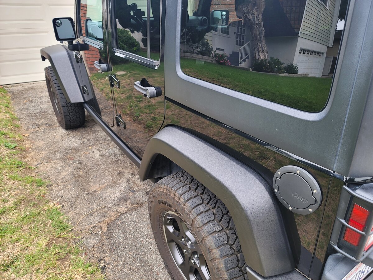

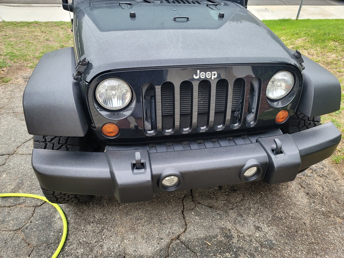

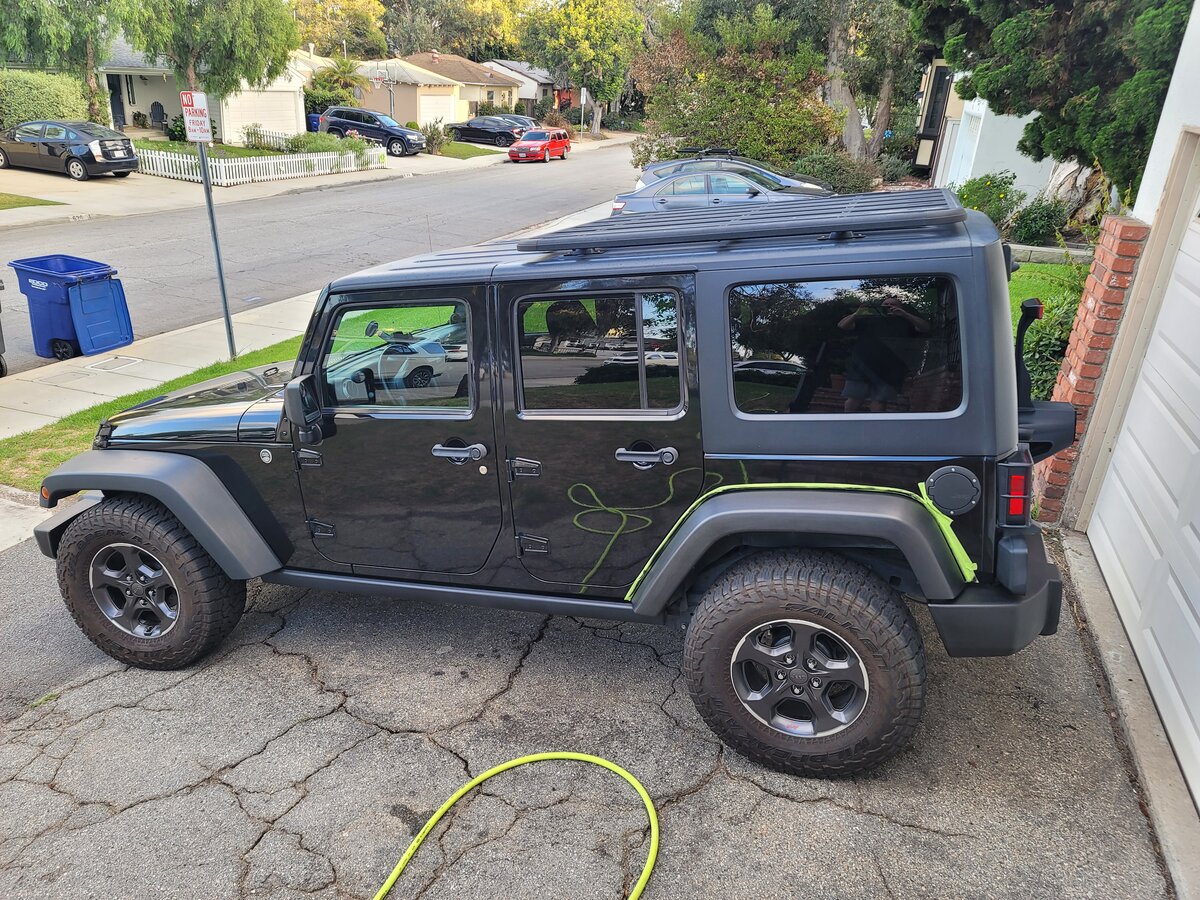

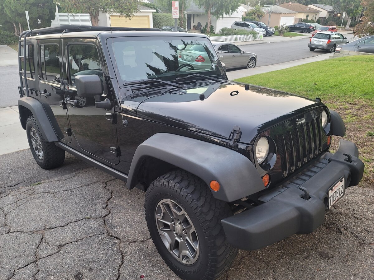

This is my Jeep finished and in process. Meaning bumpers and fenders. I am still going to do the mirrors, door handles, license plate frame and other small parts.
I'll probably have the hard top and roof rack professionally painted.
A few reviewers did have success on painted metal. I used it on my plastic and painted metal on the upper rear middle tail light. You can barely see it behind the spare. It looks great on the painted metal. But I would do further tests before using it that way.

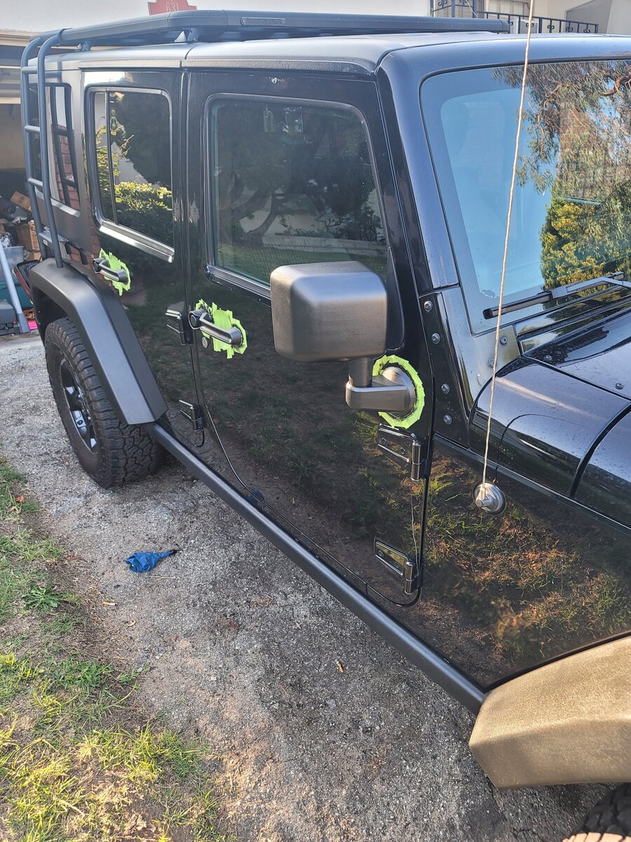

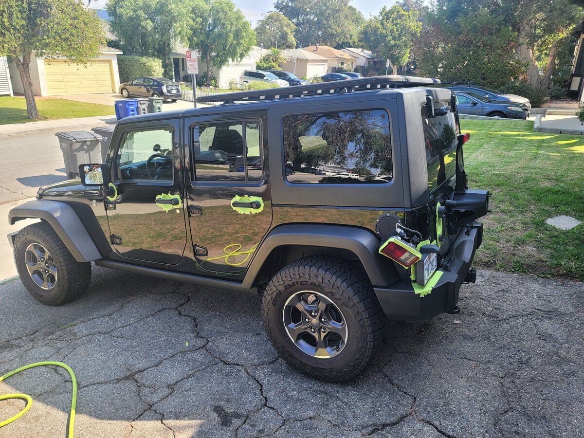

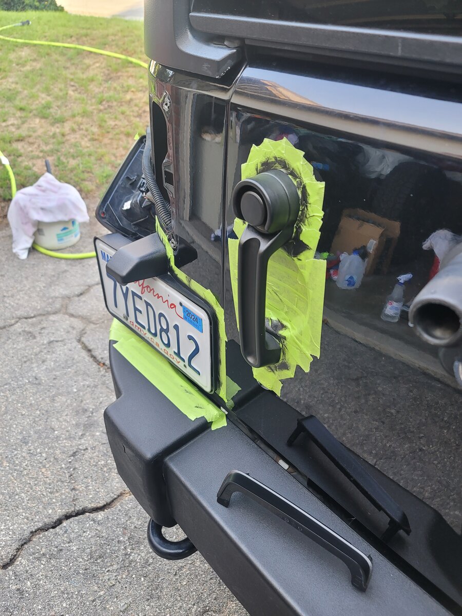

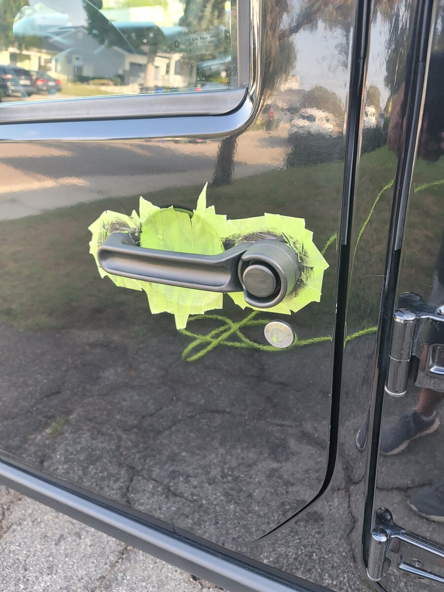

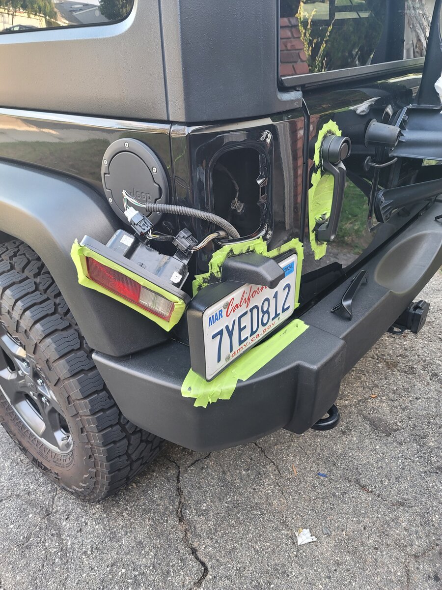

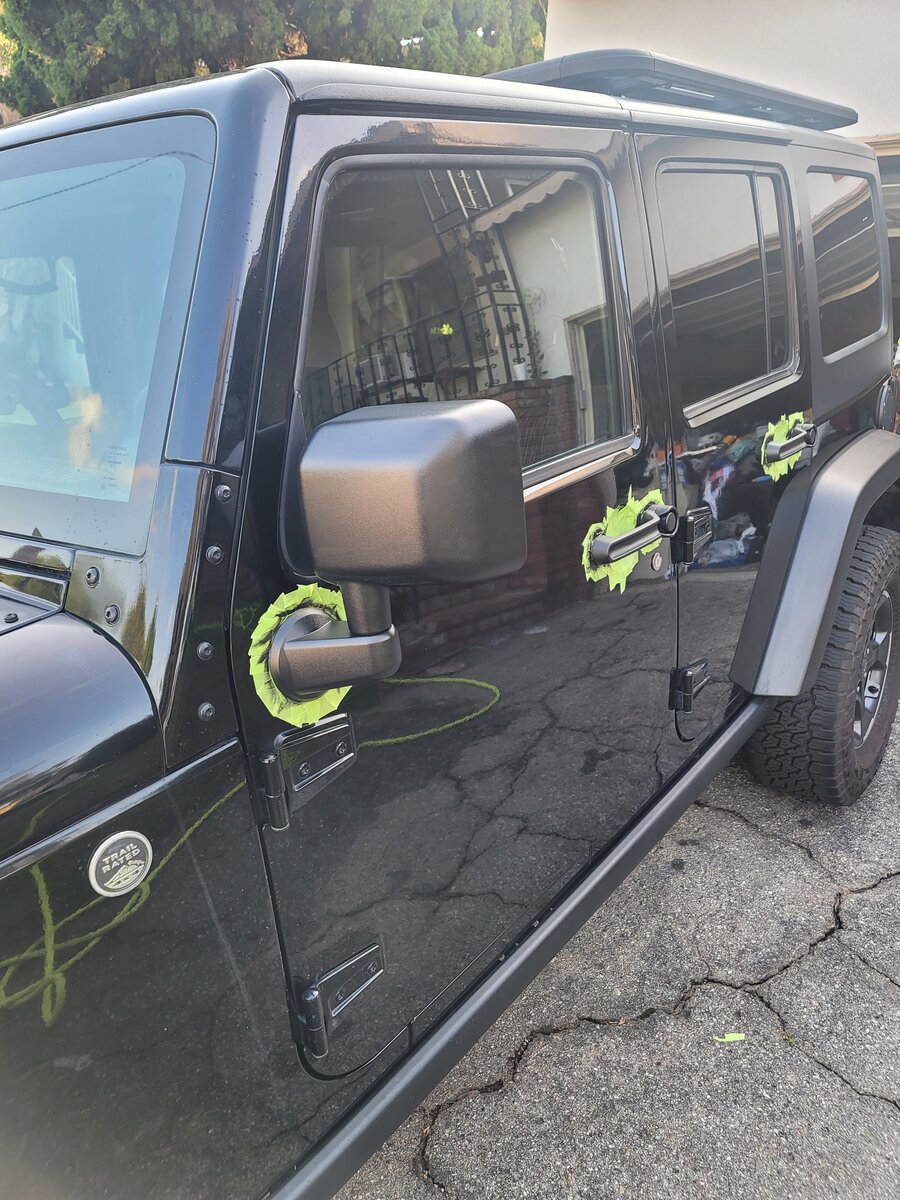

DOING THE SMALL TRIM:
Today I taped off the license plate, door handles, side mirrors and tail lights. And dyed those.
It goes alot faster if you tear little 1 inch pieces of tape. And stick them on the body next to whatever you're taping. Tiny pieces around circles is the way to go. Again the trick is not to use to much dye. I used the small 1 inch foam brush for all of it.
On the door handles I wrapped a screwdriver with a rubber glove, depressed the button with the tip of the screwdriver completely, then went around the inside with about 2 drops of dye on the end of the small foam brush.
This is again, an exercise of wiping it on with back and forth swipes with the side of the brush and lifting the excess with the tip of the brush.
The last ones I did was the side mirrors. I wanted to test the large carwash sponge. But after taping everything and dyeing. I was to tired to give it a try. Even with the smallest foam brush I think the side mirrors (the largest surface) turned out well. You can barely see some streaks. But from 4 feet away they are all but invisible.
I may go over everything again tomorrow. If it looks like it needs it. As the taping is the majority of the labor. But not the reverse lights. As they turned out fine. And the guards cover them up enough that any imperfections are not visible. Actually they turned out very well.
You can barely see in the above top pic the run lines from the dew on the back bumper. Its very minor. And you can barely see it in the enlarged second pic. But there none the less. So I'm going to leave my car cover in it overnight. To make sure none of the trim I've done today gets any dew lines from water running off it.
