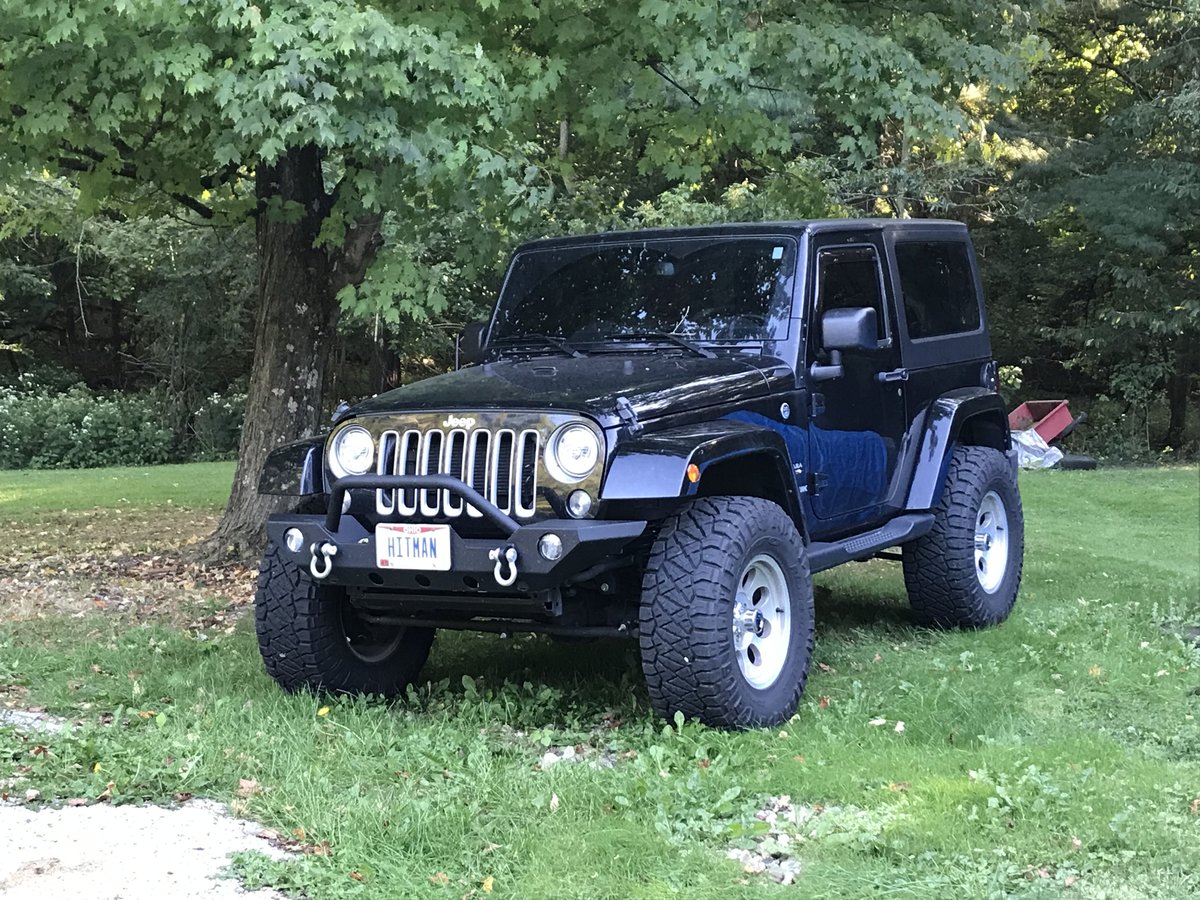

Anyone else experience “surging” issues?
I notice when unloading the jeep while its running, the exhaust note seems to surge/rev up/down. Also at highway speeds about 62mph and low speed about 35mph slight inclines. Not sure if it was a day one issue because I put so much stuff on it at once(lift, intake, tires, gears, pedal controller, aev flashcal, dual exhaust).
Starting to irritate me. Dealer dismisses/refuses work because aftermarket parts.
I do notice transmission module needs reworked cause shift points are poor. I will probably try ost dyno for tcm flash unless anyone has used HP to rewrite their tcm with success. The “lift to shift” before trans warms up was most annoying but the damn surging is getting worse and noticed it when backing out of parking space yesterday.
2018 JK Sahara auto 3.6
35x12.5/17 nitto
Teraflex coil lift
AEV procal
Hike-It pedal controller
Dynomax dual exhaust
Yukon 4:56 master gear kits
Spectre intake
