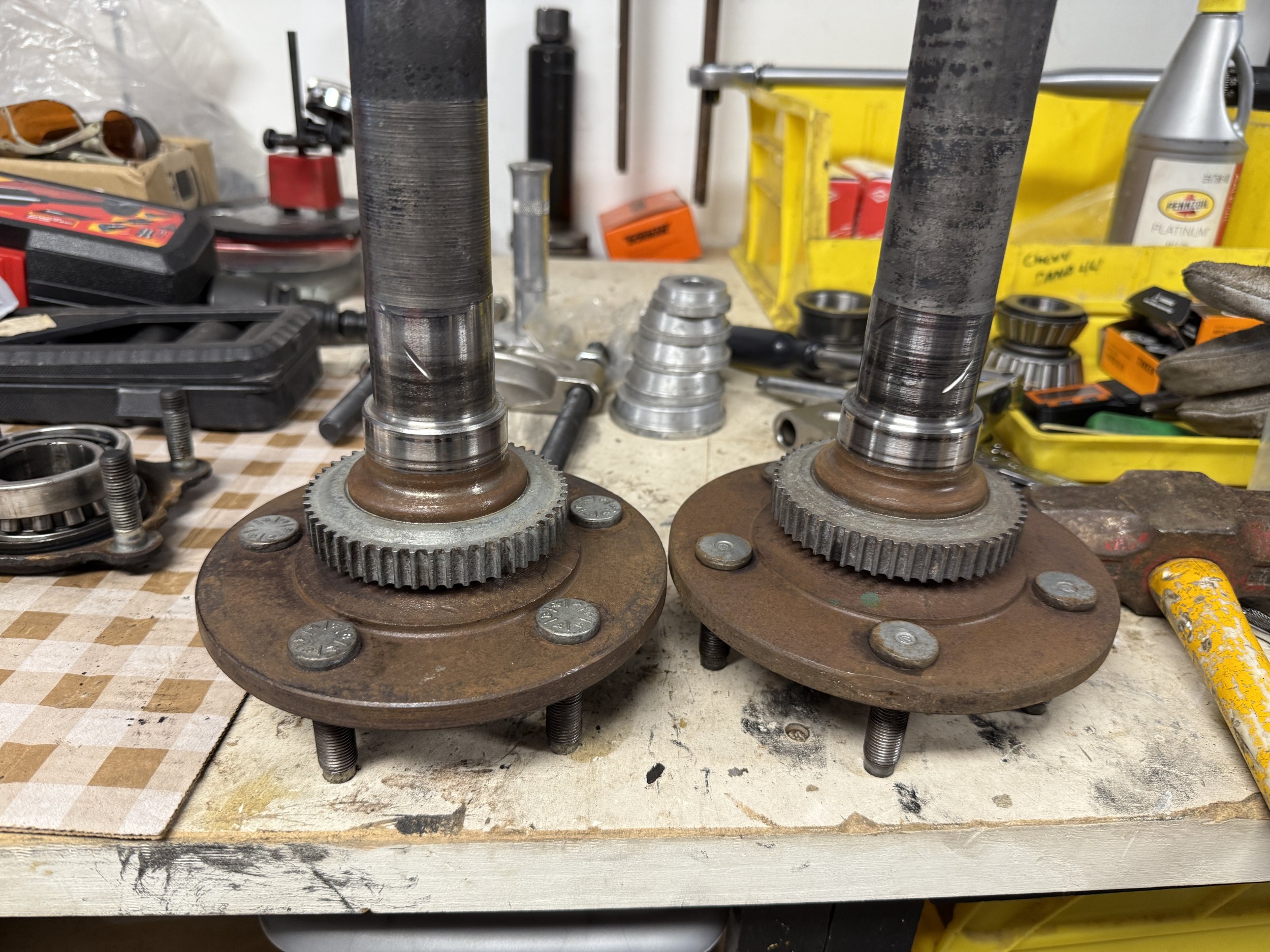

The OEM tone ring can be kind of a pain in the a$$ to get to, but is doable with hand tools, patience, and some brake cleaner.
The above is a photo of the axle shafts I took out of my daughter's Islander while I was doing the regear. The "toothed" part is the tone ring portion of the shaft. This may have some accumulated brake dust, grease/oil (if the seal is weeping), dirt, etc. I don't have a good photo of it installed, but the ring sits underneath your rear parking brake shoes.

The OEM tone ring can be kind of a pain in the a$$ to get to, but is doable with hand tools, patience, and some brake cleaner. View attachment 130387
