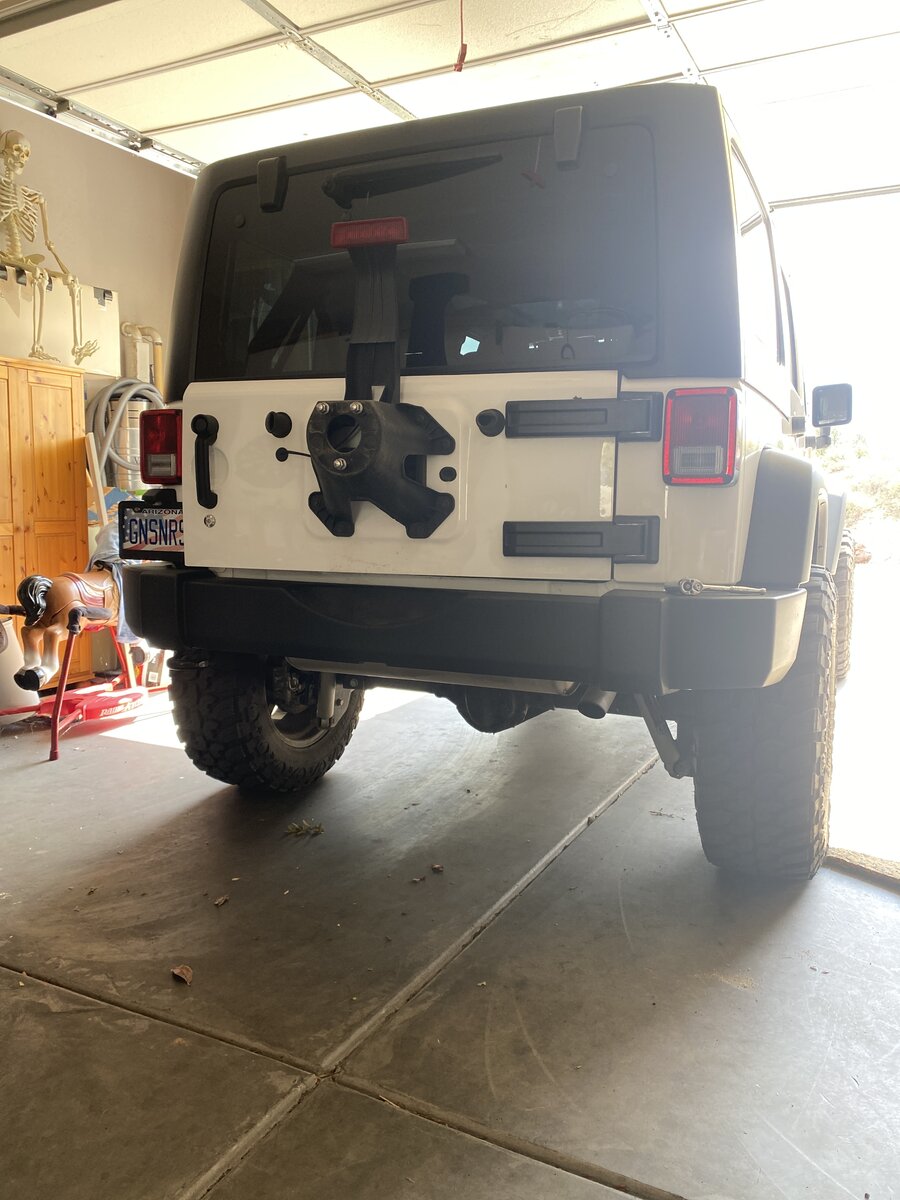

As most of you know I’m knew to the Jeep family!
I have another silly question;

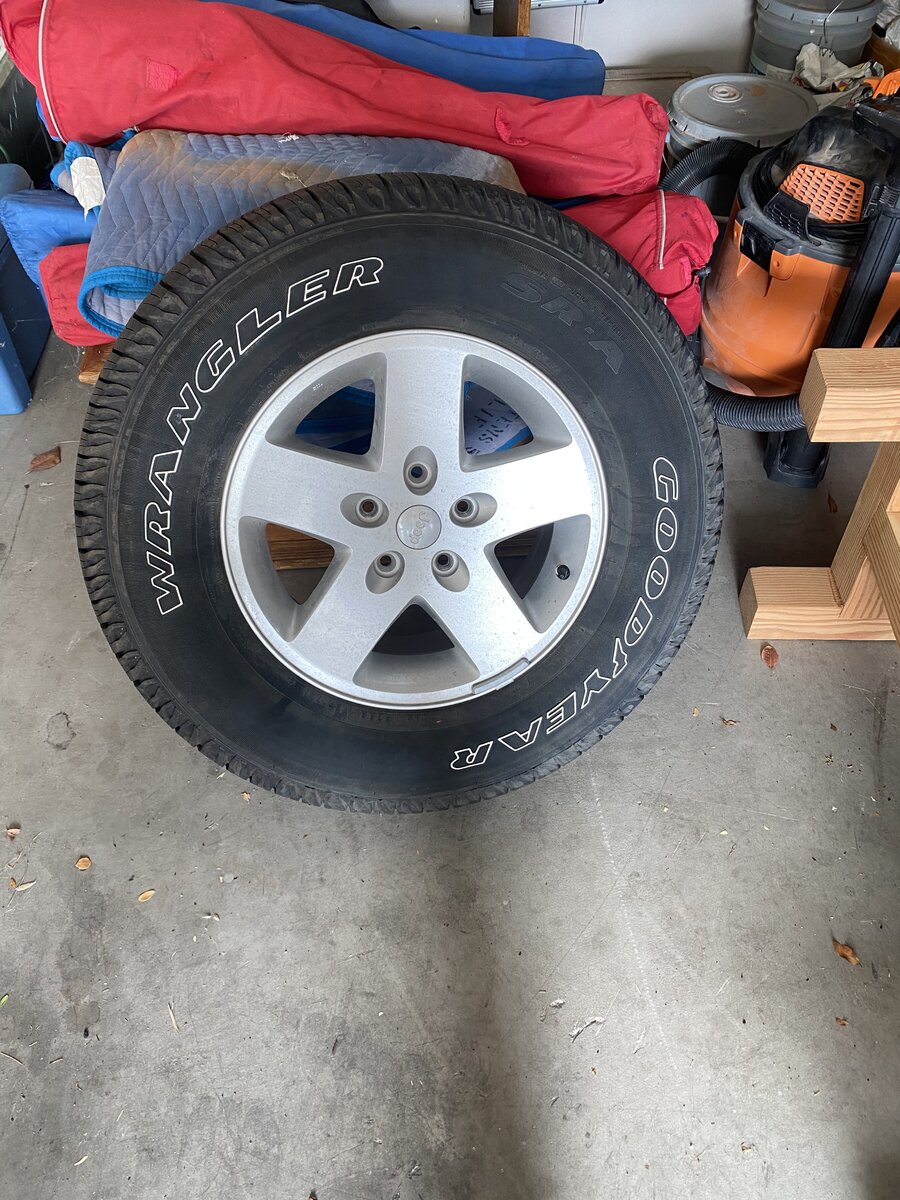

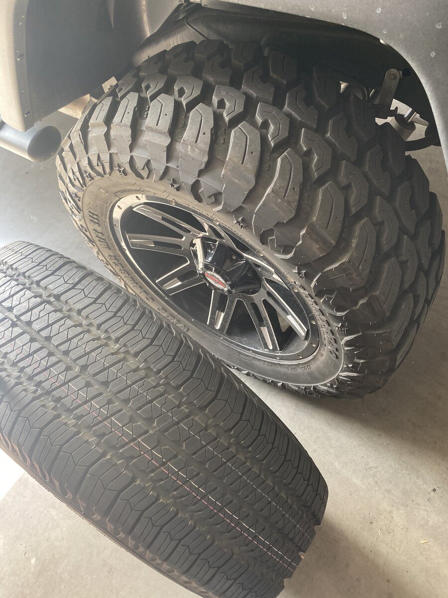

The spare on the back is stock and is definitely not the size of the tires that are on it now. Should I just take it off or is it best to leave it on?

1. If the existing isn't the same as the wheel/tire combo you have, would you, in the event of a flat, use that spare? If not, remove it.
2. If you were to add the same wheel/tire combo as a spare, do you know what the weight of that wheel/tire combo is? The reason I ask, if you're in the middle of nowhere, do you have the physical ability to hoist that spare off the tailgate, lift it onto the hub and hoist the flat into the rear of your JK?
Case in point, I was working on my tailgate/spare mount a couple years ago and had to remove the spare (Toyo MT with Moto Metal 962 wheels). The wheel/tire combination was around 108lbs. I told my wife if she ever flatted my JK to call AAA because there's no way she is gonna manhandle the existing tire off the hub or be able to remove the spare.

Thank you! All of that makes complete sense! I’m strapped for any extra’s at the moment so buying a whole new matching tire/rim is not feasible at the moment so I’ll just remove the existing spare. It is teeny tiny compared to the others and doesn’t serve a purpose at all, would not do a damn thing in case of a flat.

I had a pretty cool tire cover over the spare… but I was just feeling like it serves no purpose and just adds weight… but now it looks weird with it off? Should I remove the entire spare tire holder??
Will the tire carrier you have hold the 35 (weight, size and depth) when you do get it? If so, just leave it alone- we (the Jeep family) understand.
If you're going to have to upgrade the carrier to hold a 35, you're going to have to remove it sooner or later. If you do remove it, you're going to need a spare tire delete plate to cover all the bolt holes and vent, which will run you about $80. I'd just leave the existing carrier.

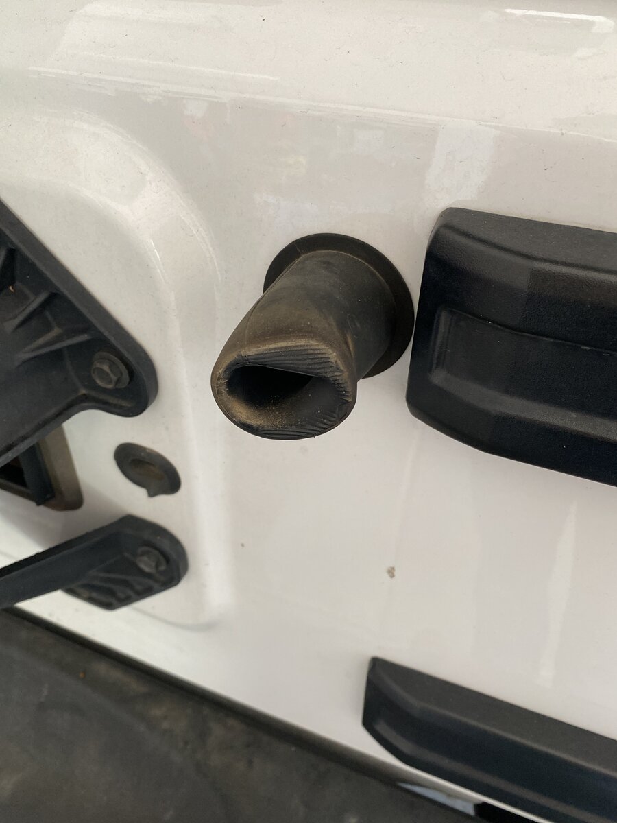

What are these?? They’re like big rubber tubes??
Also; is it necessary to leave it on until I get a delete plate? Because I could keep the bolts in to block the holes, the vent would just be a bit more exposed than it is already.

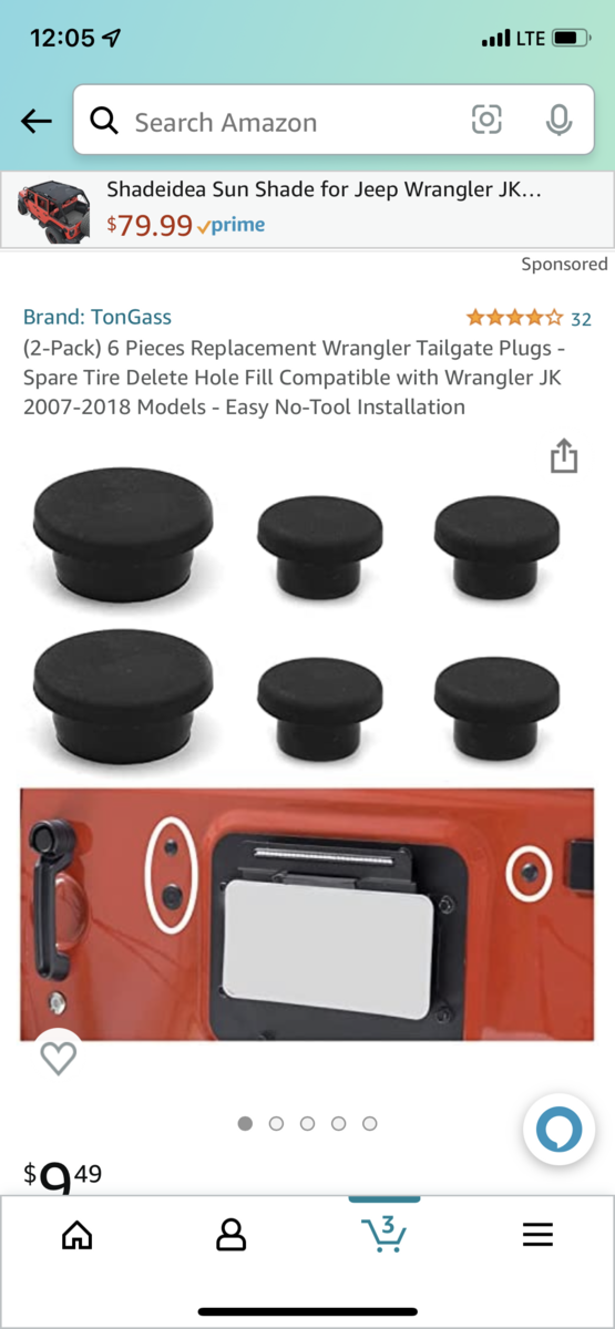

I found these on Amazon… I’m assuming you would use these to plug up the holes after removing the long rubber tubes?
There ya go!
And I honestly do not know if your spare carrier will handle a 35", I simply brought it up as something to be aware of.
