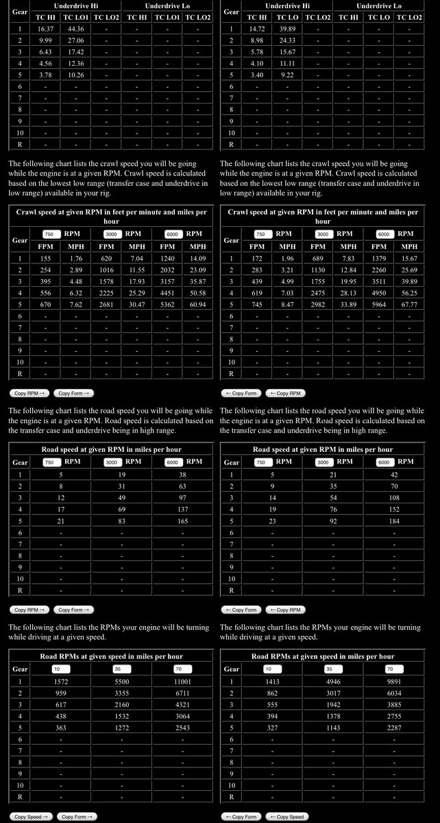

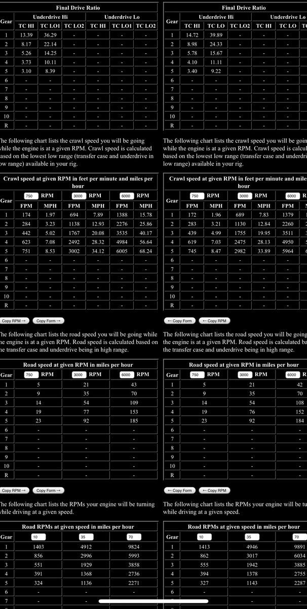

Thank you for the input! It is appreciated! I did some studying last night and figuring things out. I would say I would eventually go with the 4.56’s. Budget is a little tight right now. Anyway that’s what the wife said 😂. I did want to share some ratios and information I figured out. This was figured using the w5a580 trans and the nv231 ratios. First pic is with 255/75r17’s with 3.73 gearing on the left column and 35’s with 4.10 in the right column. It comes out virtually the same. The second one is with 35’s on each side. Left side is 4.56 and right is 4.10.

Thanks for sharing that. You could go either way, but I promise you that you'll enjoy the 4.56 gears more with 35s. 4.10s aren't bad, but the 4.56 is really going to be perfect.
