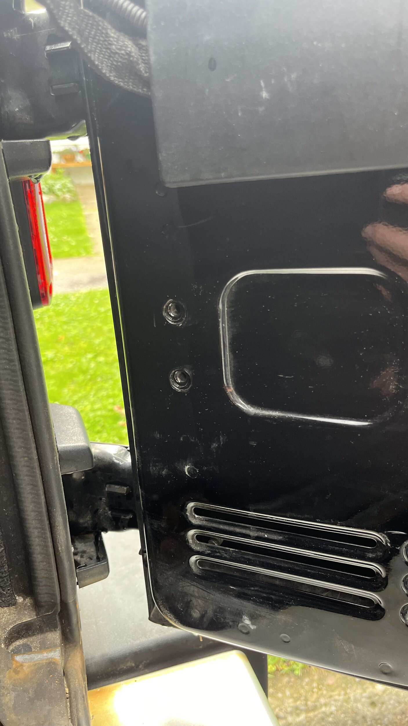

I did some looking. All the spot welds look good. I swapped a 2016 and it has 2 bolt holes near the hinges that the 2010 didn’t have, what belongs there? Should I bolt something into them? Looks like you were right about the dent, seen picture and videos below. When pulling on the tire carrier you can see the dent pop in and out. Worth seeing if a body shop can pop it out for good?

Those bolt holes are for the door check. Jeep added them in 2012. The check keeps the door from opening too far.

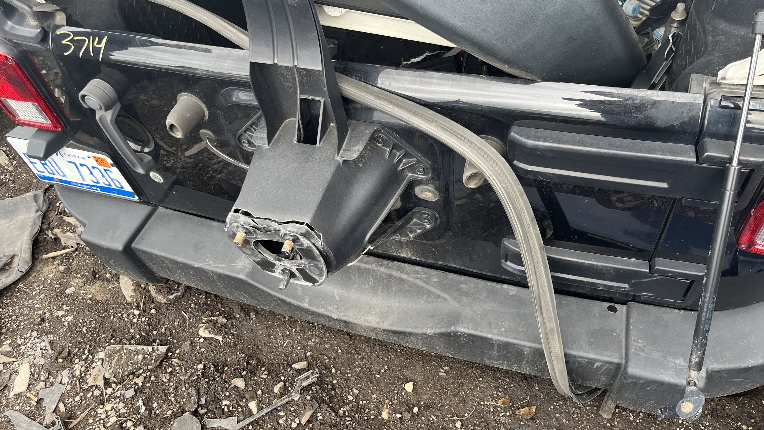

that’s kind of what I’m suspecting, and it looks like from the pictures of the jeep that it was taken off from in the salvage yard. Their spare tire was touching the tailgate. You can see where the dust was outlining the tread on the tailgate the dent itself doesn’t really bother me too much because it is hidden by my spare tire but it’s more just the noise and the clunking and popping from inside, I’ll probably take the outside vent off and see if anything in the inside looks to be detached in that case I will have someone weld it back together. my thought, and I don’t know if you will agree with me on this or not is that just a simple dent wouldn’t be popping like that from the weight of the spare tire. Makes me almost think that something inside isn’t fastened properly, but I really have to take a look inside to know.
There are vertical support braces inside. I'm not 100% sure where they all are located though. I just know they're inside because of installing my tailgate table. I also wonder if there was a slight rear end collision with your "new" tailgate? Only asking because you stated the tire carrier was cracked and now this?
That was the one the tailgate at the salvage yard was taken off of.
