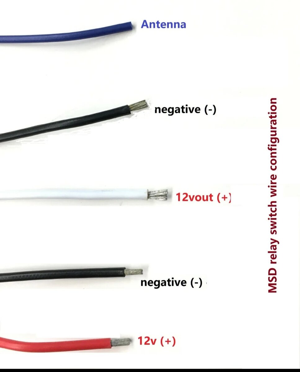

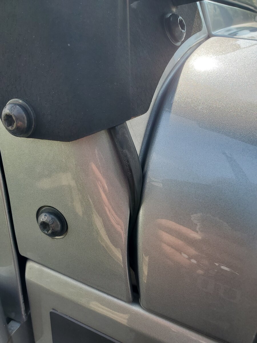

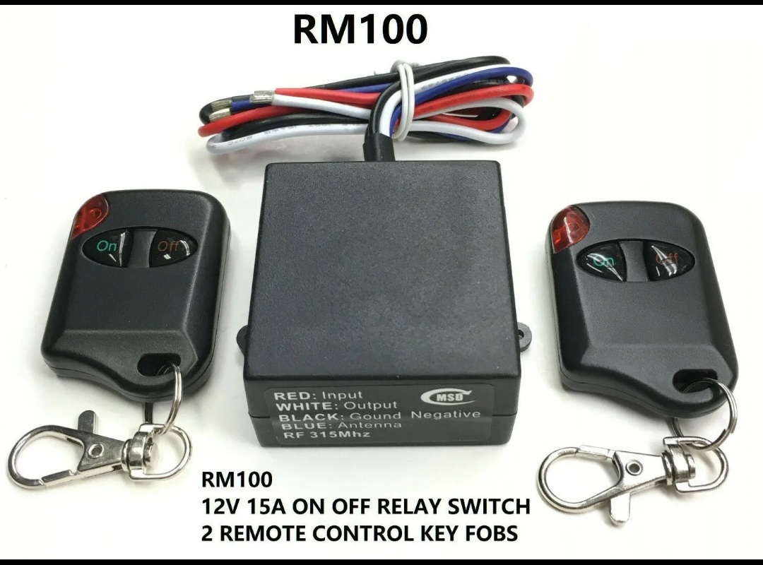

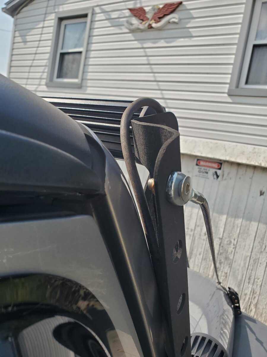

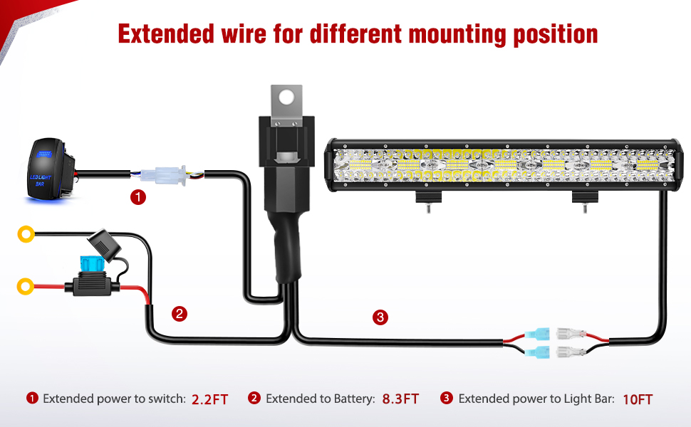

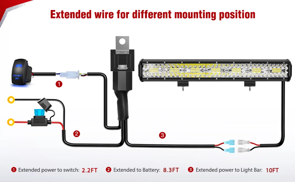

<blockquote data-quote="JeepJeezy" data-source="post: 460473" data-attributes="member: 21715"><p>My light bar wires are ran down the passenger side A piller behind the light bar mount and into the engine bay. Battery is located on this side. I have my light bar wired into a key fob remote. No need to run wires into the cab. On the fob box I hooked red 12v+ to the battery +. The black neg - to the battery neg -. The white 12v+ got hooked to the yellow or blue depending on your wire harness, of the rocker switch that would of got ran into the cab. The other black neg- went to the black neg- on the rocker switch wire. On the light bar harness, red 12v+ went to positive + side of battery. Black neg - went to negative side of battery. Your light bar wires go to red positive + to red positive + and black neg - to black neg - on the light bar harness. I hope this helps. Oh and welcome to the group!</p><p></p><p>[ATTACH=full]125069[/ATTACH]</p><p></p><p>[ATTACH=full]125070[/ATTACH]</p><p></p><p>[ATTACH=full]125071[/ATTACH]</p><p></p><p>[ATTACH=full]125072[/ATTACH]</p><p></p><p>[ATTACH=full]125073[/ATTACH]</p></blockquote><p></p>
[QUOTE="JeepJeezy, post: 460473, member: 21715"] My light bar wires are ran down the passenger side A piller behind the light bar mount and into the engine bay. Battery is located on this side. I have my light bar wired into a key fob remote. No need to run wires into the cab. On the fob box I hooked red 12v+ to the battery +. The black neg - to the battery neg -. The white 12v+ got hooked to the yellow or blue depending on your wire harness, of the rocker switch that would of got ran into the cab. The other black neg- went to the black neg- on the rocker switch wire. On the light bar harness, red 12v+ went to positive + side of battery. Black neg - went to negative side of battery. Your light bar wires go to red positive + to red positive + and black neg - to black neg - on the light bar harness. I hope this helps. Oh and welcome to the group! [ATTACH type="full" alt="Screenshot_20230821-154326_eBay.jpg"]125069[/ATTACH] [ATTACH type="full" alt="Screenshot_20230821-154333_eBay.jpg"]125070[/ATTACH] [ATTACH type="full" alt="2228088e-0cd6-4337-972e-97307b572fb6.__CR0,0,970,600_PT0_SX970_V1___.jpg"]125071[/ATTACH] [ATTACH type="full" alt="20230821_155743.jpg"]125072[/ATTACH] [ATTACH type="full" alt="20230821_155750.jpg"]125073[/ATTACH] [/QUOTE]
