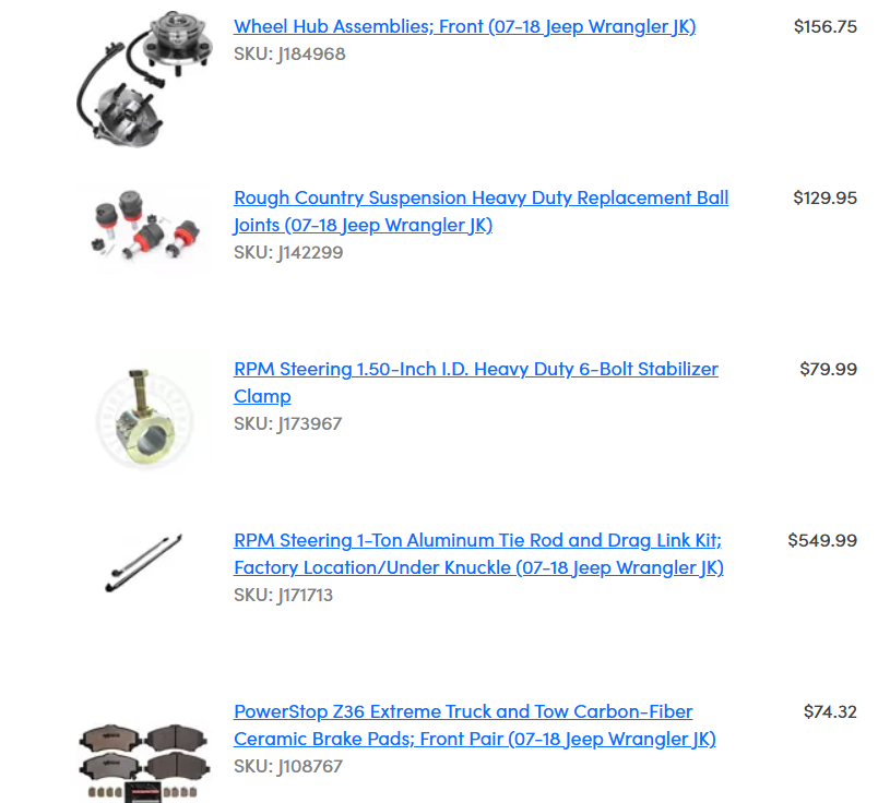

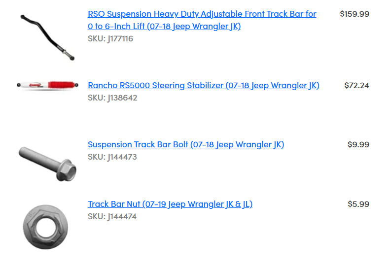

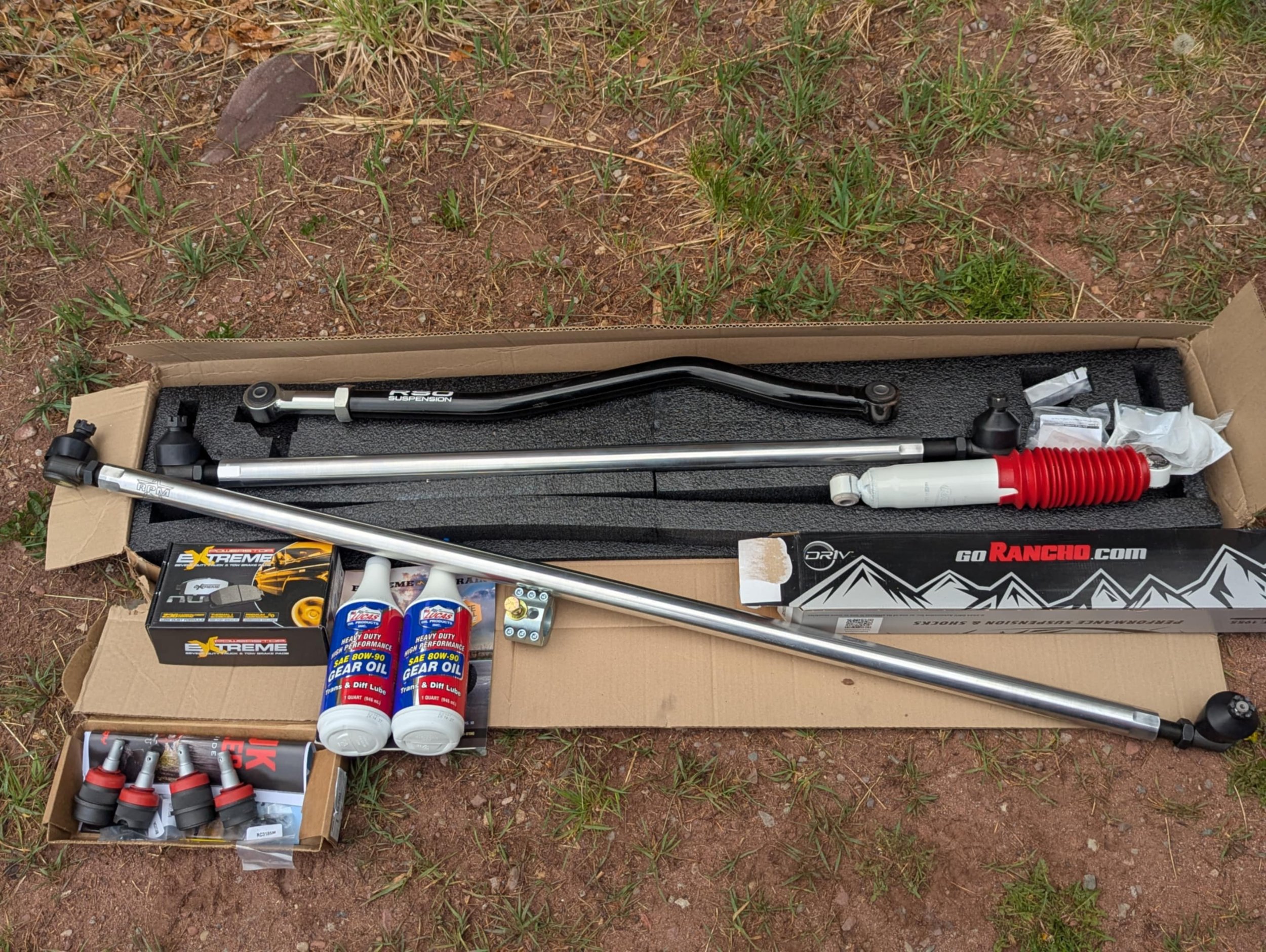

Things I have ordered so far:
RSO Suspension Heavy Duty Adjustable Front Track Bar
Rancho RS5000 Steering Stabilizer
RPM Steering 1-Ton Aluminum Tie Rod and Drag Link Kit w/ HD Stabalizer clamp
Wheel Hub Assemblies x 2
Rough Country Suspension Heavy Duty Replacement Ball Joints
PowerStop Z36 Extreme Truck and Tow Carbon-Fiber Ceramic Brake Pads (Might as well do these while I have it apart)
And I ordered some less aggresive more reputable tires. I am running Ironman MT's and they are terrible on a daily driver. Tires are like new but I ordered some Goodyear territory MT's ( the bronco pattern) Just because I am over the loud bumpy ride of the ironmans.
Is there anything basic I am forgetting while I have this pulled apart? Besides throwing salt over my shoulder and praying to baby jesus?
