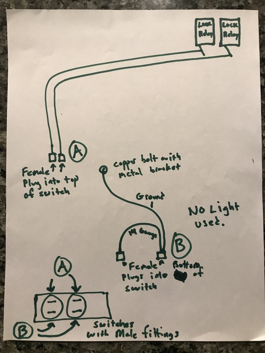

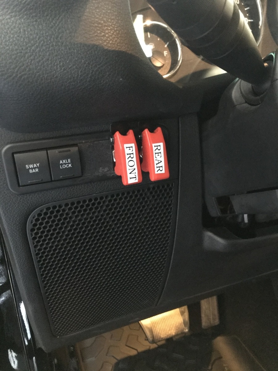

<blockquote data-quote="Aso544" data-source="post: 422915" data-attributes="member: 17996"><p>I used the Searchers kit but swapped switches. Easy install but the directions was the online video and the harness you need to make wasnt explained that great but I got it figured out.</p><p></p><p>I bypassed the light as well.</p><p></p><p>Just remember once installed and activated the locker light will flash when engaged and not be solid like the factory activation.</p><p></p><p>To be honest the a Kit isn’t really need as all you need are wires, switches, and connectors. It’s a simple process </p><p></p><p>[ATTACH=full]114412[/ATTACH]</p><p></p><p>[ATTACH=full]114413[/ATTACH]</p></blockquote><p></p>
[QUOTE="Aso544, post: 422915, member: 17996"] I used the Searchers kit but swapped switches. Easy install but the directions was the online video and the harness you need to make wasnt explained that great but I got it figured out. I bypassed the light as well. Just remember once installed and activated the locker light will flash when engaged and not be solid like the factory activation. To be honest the a Kit isn’t really need as all you need are wires, switches, and connectors. It’s a simple process [ATTACH type="full" alt="aTnthIL.jpg"]114412[/ATTACH] [ATTACH type="full" alt="58nuAnh.jpg"]114413[/ATTACH] [/QUOTE]
